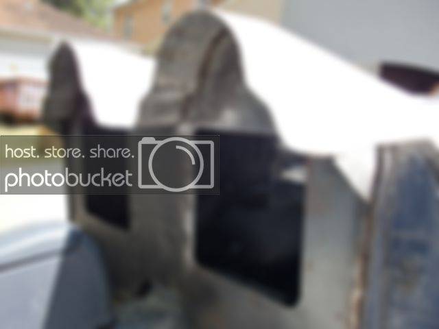

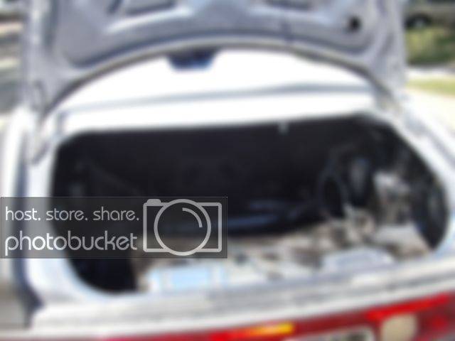

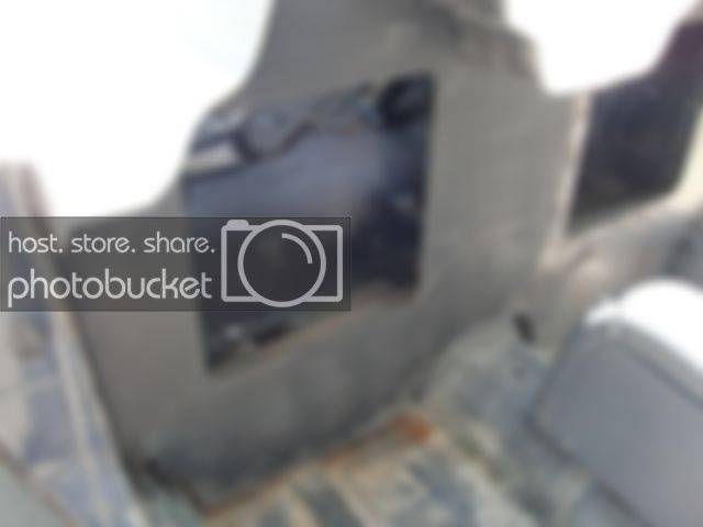

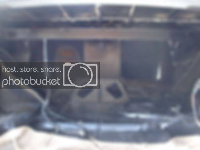

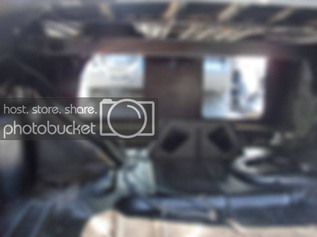

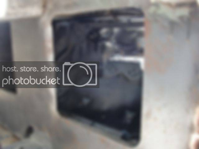

What subs should we use for 4th order BP? We want a LOW tune around 25Hz-30Hz. Plenty of airspace available, 2 20"x20" square ports. 2 18's. Run off either one or two AP30001Ds.
