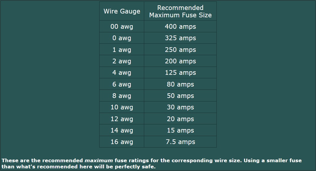

0 gauge should have a max fuse of
You fuse for your wires amperage limit not the amp.
Correct. I suppose it depends on what all he is running off that power wire. Installing a 120a fuse inline with 2/0 is fine if all he is running is that Audiopipe amp, wire is easily protected, and the amp has what AP recommends. However, if running other amps on that 2/0, then it should be fused at the wire limit and then separate fuses for each amp near the amp that don’t have one built in. This is easier if running a distribution block of some sort when splitting the wires to each amp. But yeah, not sure what all he is installing, other than 120a fuse should work fine with that AP amp.
Here is a chart with fuse sizes for common wire from a good source bcae1.
http://www.bcae1.com/wire.htm
Every power wire is supposed to be fused at it's maximum capacity, even the big 3 alternator to battery run, and any subsequent smaller wires that split to each amp if running more than one. Some people skip fusing everything, some just fuse the main run. It is safer for your car to fuse everything properly as wire is a fire hazard if not fused.
