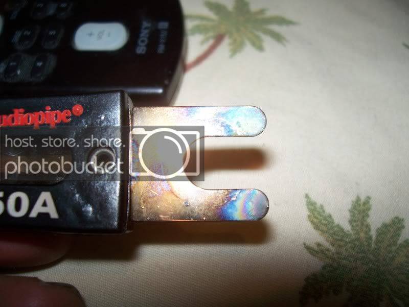

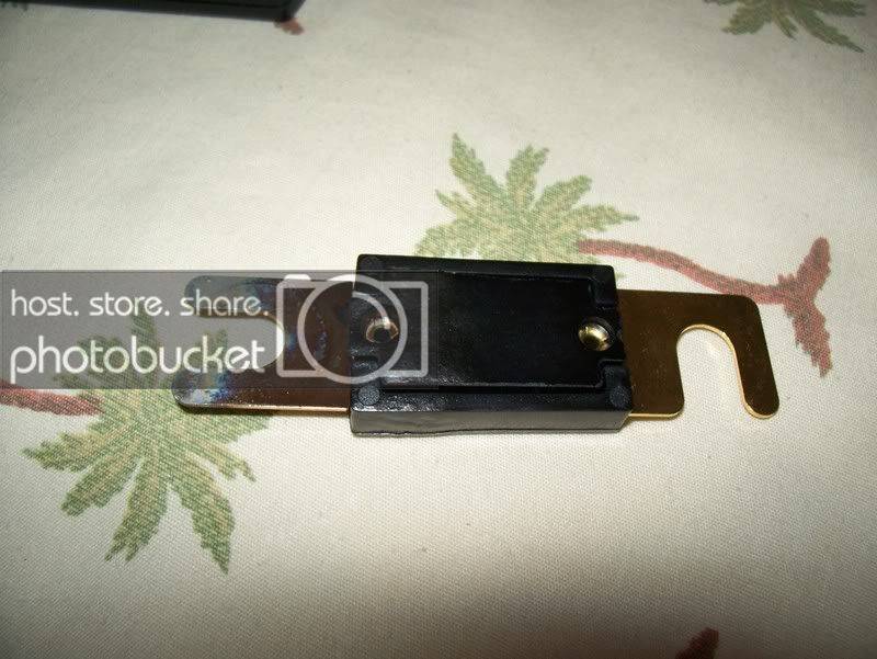

I just took this pic looks like the fuse was corroding or something. I just put a diffrent 150 amp fuse so i will see what that does.
daaaaaaaaaaaaamn that is bad... glad you swapped out fuses. if you need any 150a's let me know i have a bunch for ya //content.invisioncic.com/y282845/emoticons/smile.gif.1ebc41e1811405b213edfc4622c41e27.gif
