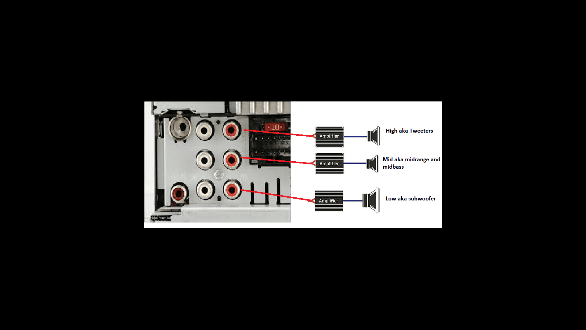

there's no rear channel anymore after going active. its split into HIGH, MID and LOW
top two RCA is for tweeter only which will go to channel 1 and 2 on your alpine pdx. You split the next pair which is mid one pair will go to your 3 and 4 midbass channels on your pdx while the other pair will be split and used to bridge the 4 channel amp.
On the head unit for example you will have the tweeters crossed over at 3500hz high pass which means the tweets will play 3500hz and up. The mid will be low passed at 3500 and high passed at 80hz which means the mid rca channel will generate a signal that will only play 80hz to 3500hz however you do not have a way to split the midrange and midbass up unless you do it at that amps.

read my post again. once you go in network mode the top pair of RCAs in the back of the head unit become "high". the middle pair become "mid" and the bottom pair become "low". Just watch this video and you'll see. Everything you knew about setting up RCA, is about to be rewritten you will no longer have front or rear at all.
that helped so much , i think i know enough to be dangerous now lmao.
yeah basic principle of network mode is split the job and specialize.
you cannot have tweets and mids on the same pair of RCAs they have to be on their own pair of RCAs lumped into a group which is based on the frequencies they play. Full on segregation lol.
