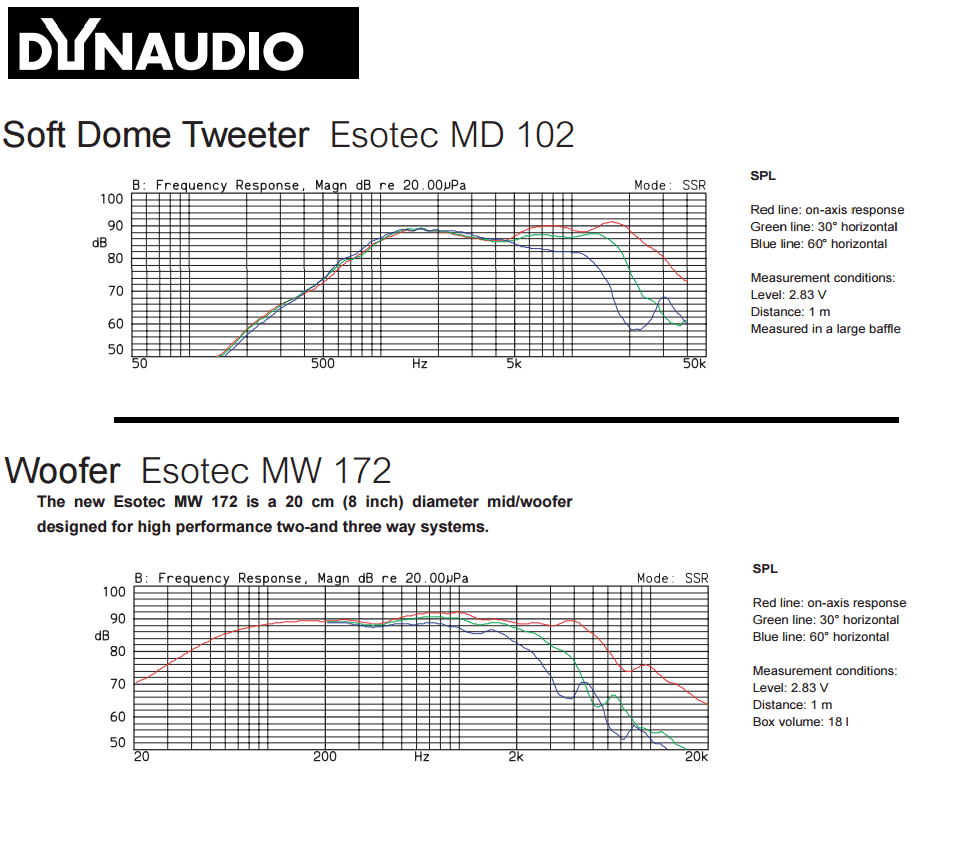

I have 2 Dynaudio MD102 in the top of my doors, and 2 Dynaudio MW172 8" in the bottom of my doors.
Are both of these driver pairs installed flush with the doors? What I mean is are the centers pointed across the vehicle or are they angled in any way toward the center of the interior?
I have a reason for posting this image which I will get to later.
