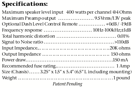

Recently picked up an Audiocontrol LC2i LOC and saw the freq range for that unit as 33hz-100khz. So that got me thinking if I stay with this LOC, I'll have to plan around the 33hz limitation. Then I thought what does my OEM HU output? I couldnt find any info on Honda forums.
A general inquiry on AI forms show that most audio manufacturers HUs generally produce 20hz - 20khz.
So if I were to keep my LOC, no need to pursue anything lower than 33Hz as my LOC wouldnt pass that. I researched other LOCs that can process lower and higher freq ranges.
But the main question is: can I find out what my HU freq range is? If my HU doesnt produce anything lower than 40hz, for example, no need to consider another LOC.

33Hz is not a hard cutoff "cliff", but it's still an 18dB/octave drop. The main outputs should be full frequency.
How about using the main out instead of the bass out, and crossing over with your sub amp instead?

Thanks all. I have a CRV EX, no factory amp. Still working on getting more info on OEM freq range.
I'll look into getting the app for a sweep measure but my stock speakers are so crappy I dont think they could reproduce anything below 80hz.
I like the idea of just using the LOC main out and crossing over with the sub amp.
Amps are: Arc Audio 2050 CXL 2x50 @ 4 ohm no RCA outs--- and Kicker DX 500.1 300 @ 4 ohm with RCA outs
The Kicker has an infrasonic filter I was planning on engaging at 20-25hz. Because it's a smaller sub amp, the plan was to fiberglass a sealed enclosure with about .7-.8 cu ft and run a L7T or some small enclosure sub. I dont think I could get that sub down past 30hz anyway (different rabbithole) so the loss of the lower freq may not matter.

Should be pretty straight forward. Front speakers "should" be getting full bandwidth from the radio (even if they can't reproduce all the frequencies) so if it were me I would tap into the front speakers with the LOC.
