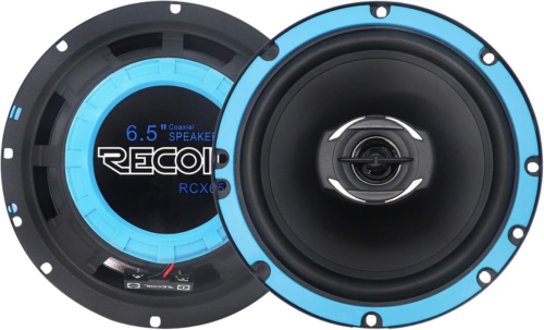

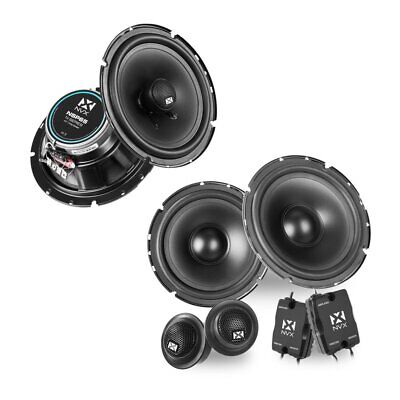

The amp is rated at 70 x 4. Anything you get that is close to that rating (preferably above) should work fine. I always recommend using the same speakers all the way around in scenarios like yours.
I've used these and they are a pretty good deal at $42.45 a pair:
These are a great step up and cover front and rear for $140 shipped:
