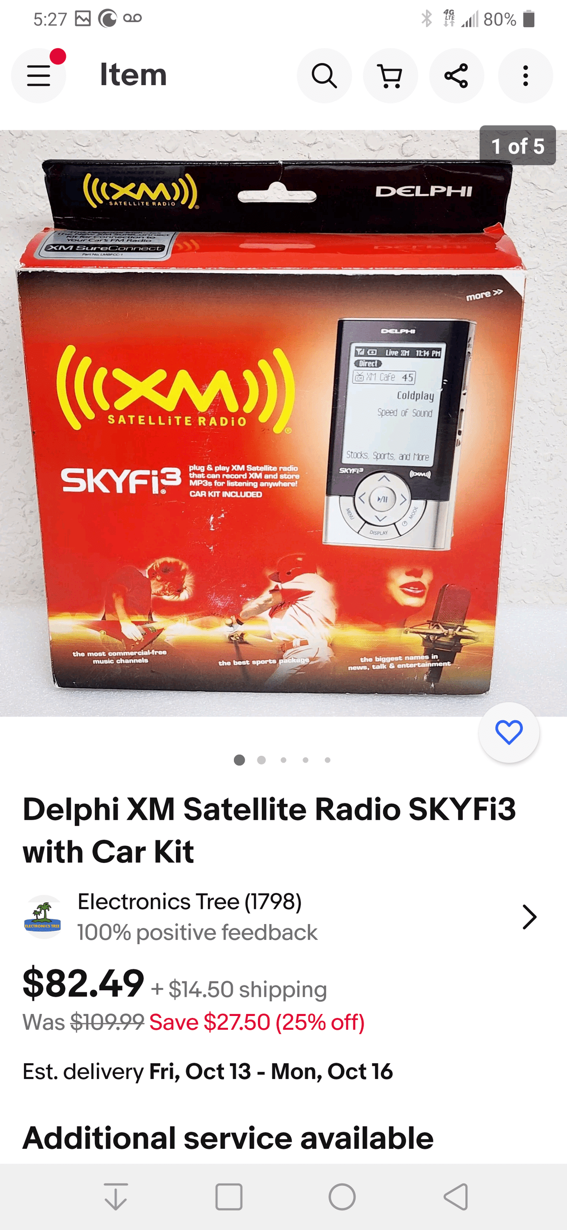

When my wife and I are on trips, we share driving. Whoever is driving chooses whether or not to have the radio on. I like to listen to XM radio, but my wife does not. In some areas, there is no cell signal so cannot use phone.
Portable XM player.
