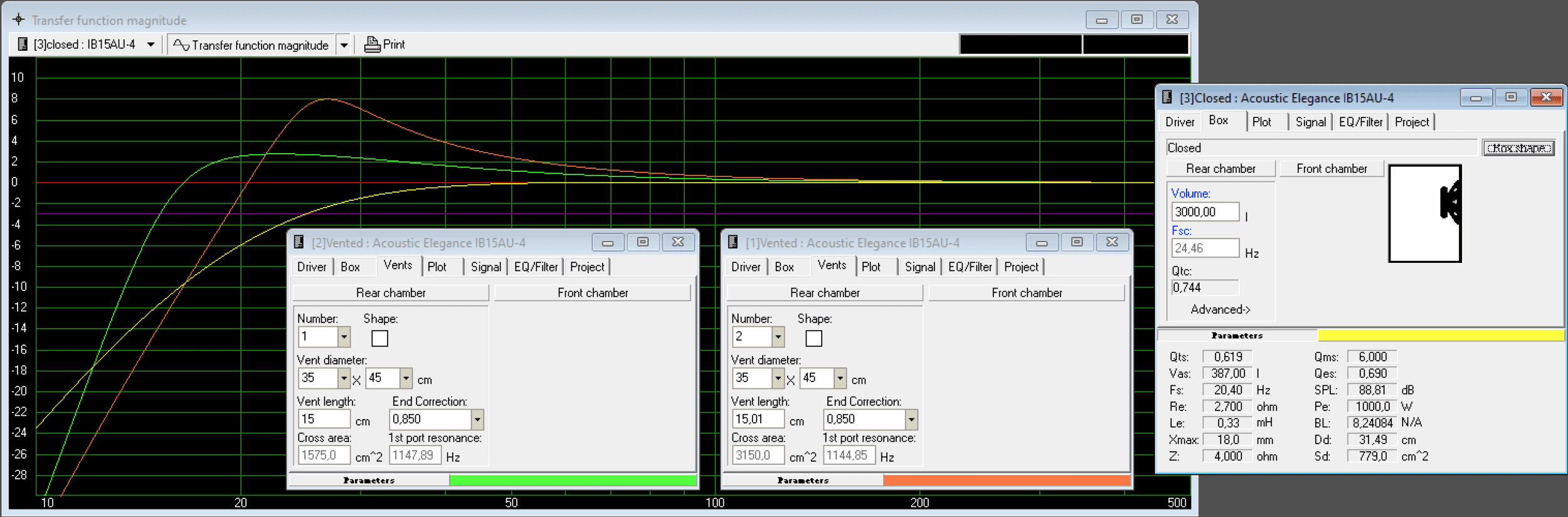

My target car is now a station wagon model that must have around 3000 liters of internal space. Using WinISD, I simulated the 3 drivers in a 3000 sealed box, which tunes to 24 Hz. Then, I also simulated a ported box with 1 window open and 2 windows open. With one window it tunes into 17,2 Hz and with two windows tune to 24.3 Hz. Those are the results:
With just 100 w for each driver, the system has a reference level of 118 dB, with the one-window ported peaking +2.7 dB at 20-30 Hz and the two-window ported peaking at +8 dB at 26.7 Hz. All simulations use a highpass filter at 15 Hz to keep the cone excursion within bounds (18 mm for each driver).
Yes, I know the car is as rigid as a box should be, so it's not a sturdy ported box, but I'm guessing the actual results would stay in between one of those three simulations. Does that seem right?

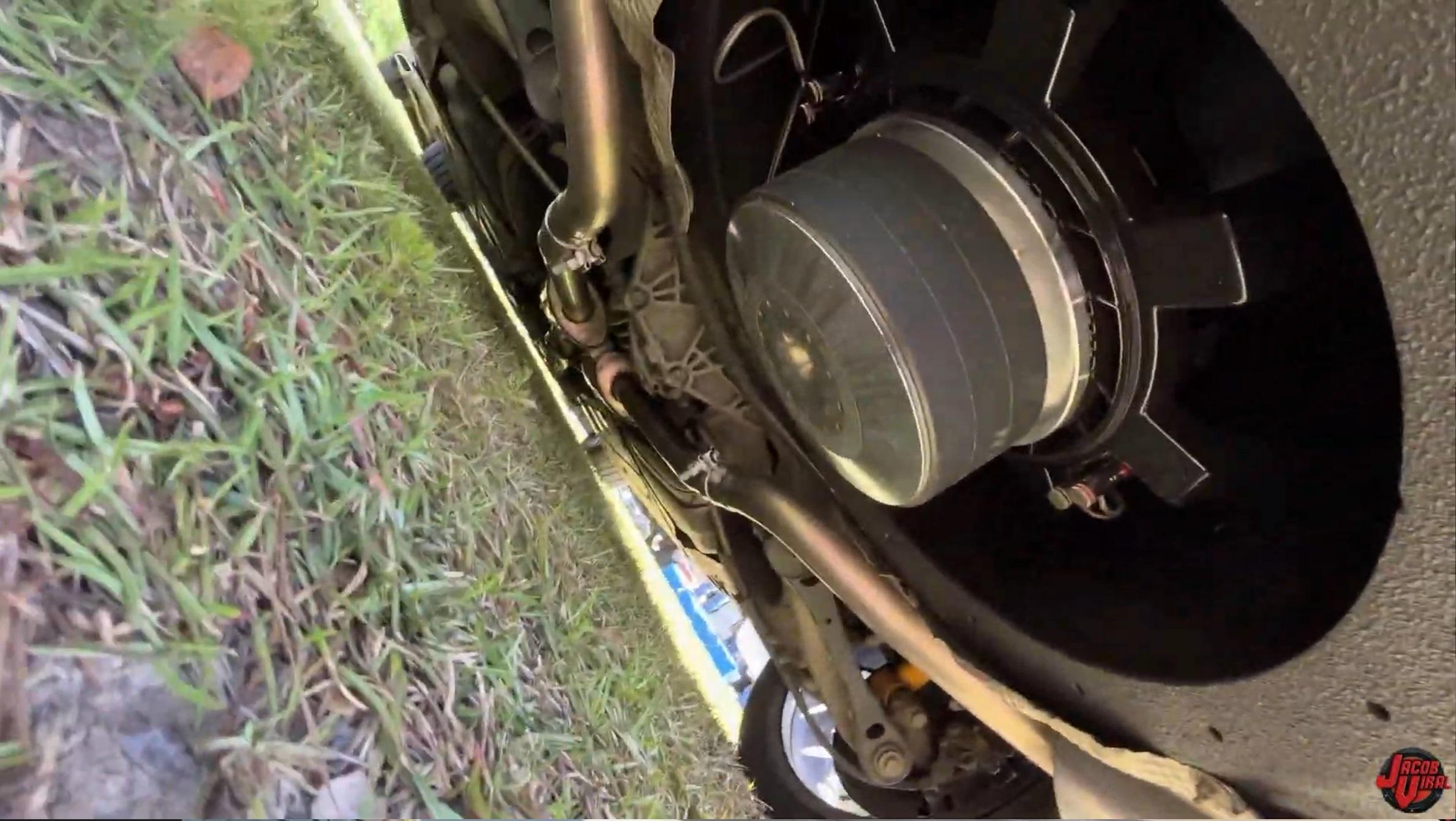

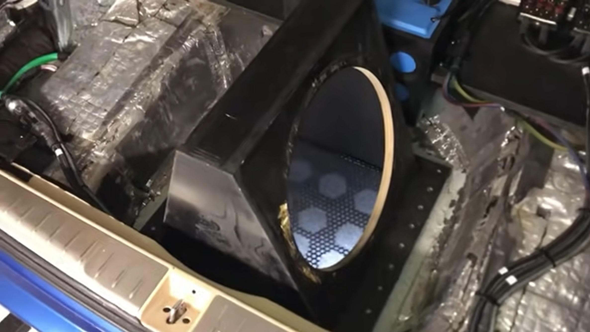

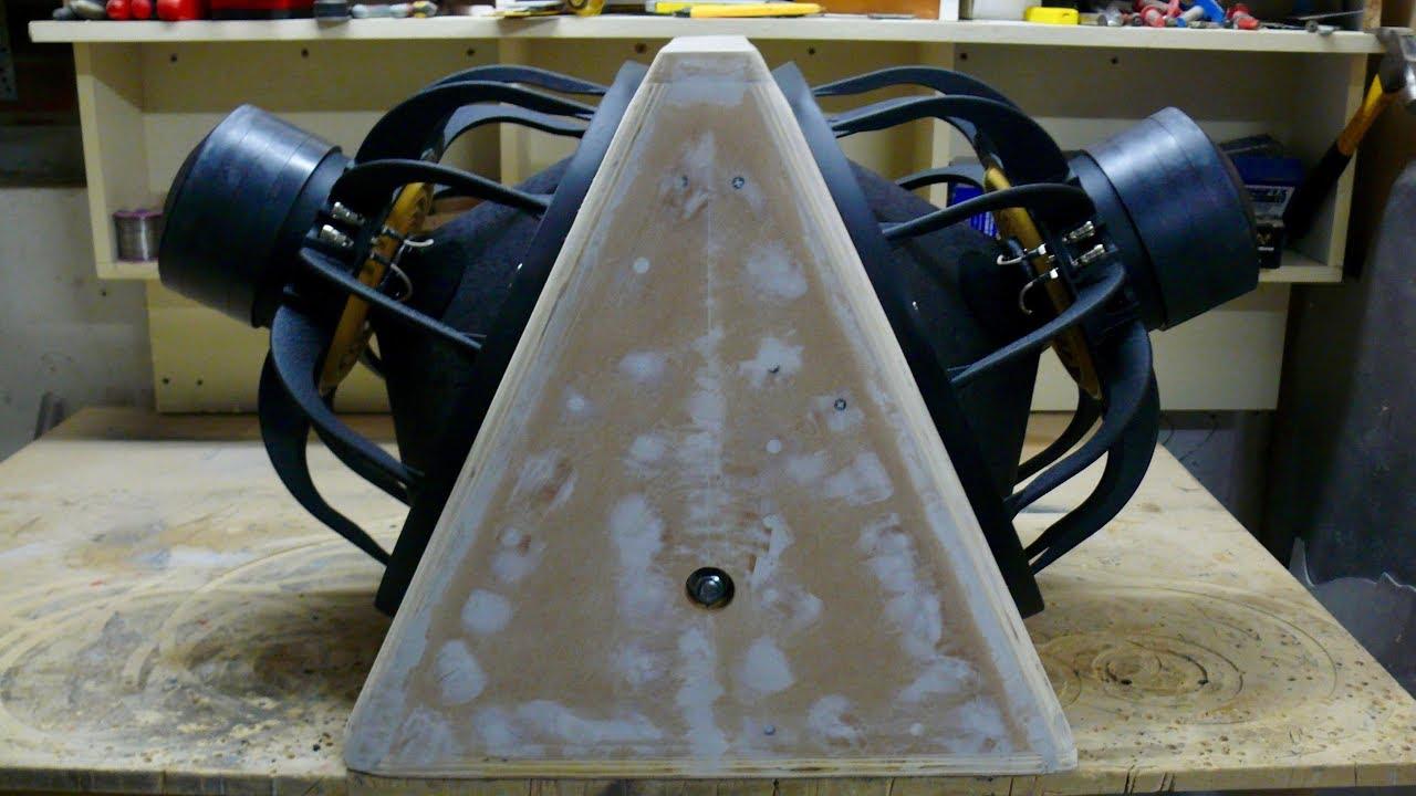

In regards to the debris, they would be safe with a manifold similar to this one:
Video with the car IB setup:
He has made a cut to the well, and uses a layer of foam material covering it:
But am pretty sure this foam at the bottom is restricting the bass output. I would try to find a different solution to hold the debris. Something that would not obstruct the airflow.

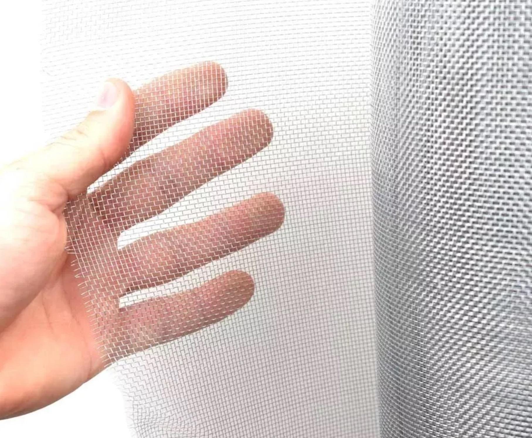

Instead of a manifold I think it more pragmatic to make a raised floor.
A raised floor takes too much space from the trunk, partially defeating the purpose of an IB. But a thin mesh seems enough. Like this "Galvanized Steel Mosquito Screen":

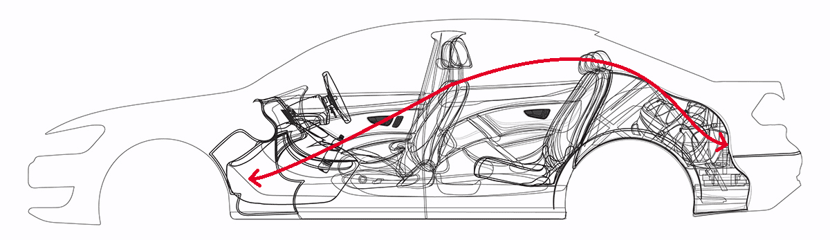

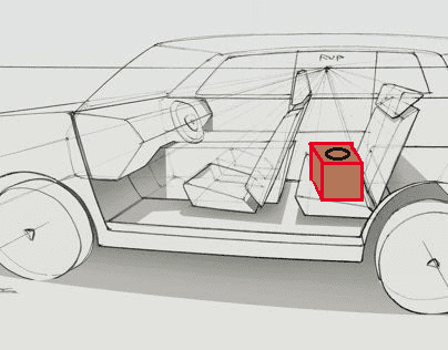

I believe that if the sub is placed at the center of the car (over the back seats) and the car is oval-shaped (like the one I had), that would minimize the overall resonance effects of the car:
However, usually it is placed at the end of the trunk and the car is long, so it causes a "pipe effect":

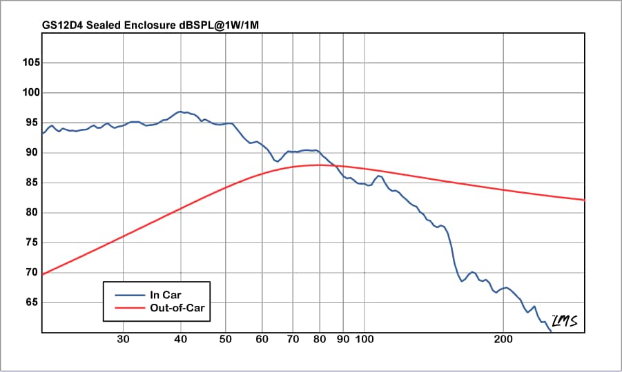

Those SPL measurements below are from JBL. They show the cancellation effect occurring slightly below 70 Hz in most vehicles:
This effect seems to fit the pipe harmonics calculation formula, which depends on the length that the sound takes to travel through the long-shaped car:
f_n = (n * c) / (2 * L)
or
L = (n * c) / (2 * f_n)
Where:
  • f_n = frequency at which cancellation occurs for the nth harmonic (in Hz)
  • n = harmonic number (1, 2, 3, ...)
  • c = speed of sound in air (approximately 343 m/s at room temperature)
  • L = effective internal length of the car (in meters)
So if the first and strongest dip in the response is at 68 Hz, we can assume it is the first harmonic, so the effective car length can be calculated as 343 / (2 * 68) = 2.5 meters, which seems to be correct if you consider that there is a curved trajectory from the back of the trunk to the floor of the driver/passenger, as I show in the image. In real pipes, the harmonics will also create great peaks, but since the car has a huge amount of absorption material, the resonations are more likely to cause dips than peaks.

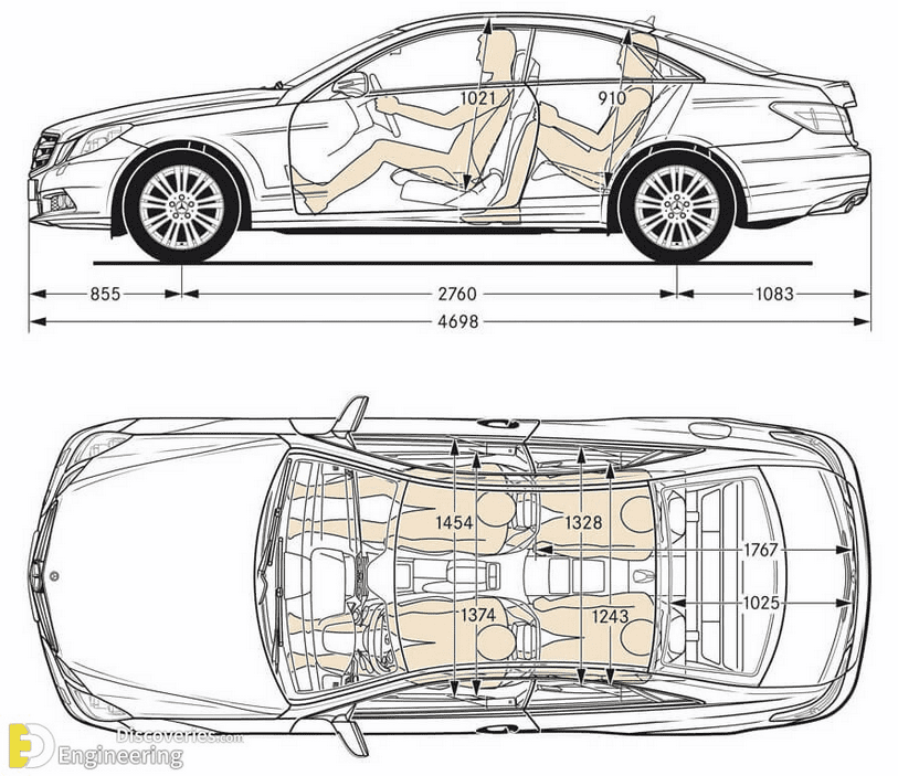

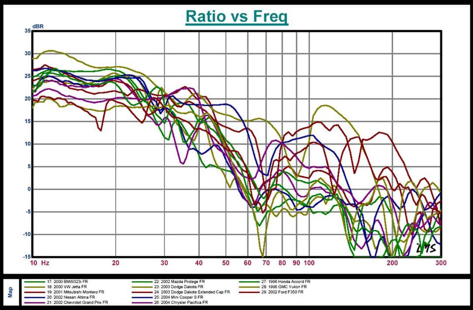

Yet, the mid-bass resonance is not the most prominent car effect. What is more noticeable is the lower-end gain in the bass. And it's not just the "window port" effect. It goes much beyond that. The response that I posted before shows about +8 dB at 20 Hz, but the car measurements show much more, around +20 to +25 dB at 20 Hz (compared to the loudspeaker's reference SPL level). The huge gains are due to "directivity".
If you add a wall at the side of a subwoofer dividing the entire airspace around it in half, the subwoofer suddenly gains +3 dB in efficiency. Because the air around it will become "heavier". This is why adding a 2nd sub gives you +6 dB. This is +3 in the overall efficiency (because you gave half airspace for each sub) and another +3 dB because you doubled the overall input power.
But if you divide the air space again (by adding another wall or by doubling the subs again), you get another +3 dB in efficiency. You can do this multiple times. This is why horns are so efficient. Horns allow the loudspeaker to transfer a huge amount of power into the air with a small cone excursion, so it is a more efficient transfer. And since the car restricts the airspace so much, it produces a similar effect as a horn, in regards to the lower end frequencies. The efficiency gain happens when the wavelengths are long enough so that the wave generation becomes "heavier" inside the car than outside of it.
As noted by measurements, the car gains at the lower end begin around 60-85 Hz:
I believe the exact frequency where the gains start depends on the quarter wavelength effect. It's the length needed for the expansion phase of the wave. The quarter wavelength of 60 Hz is (343 / 60) / 4 = 1.4 meters, which is about the maximum width we find in cars. So waves above 60 Hz can spread to the sides but waves below 60 Hz start to feel forced in just one direction, similar to the effect of a horn. And for 85 Hz, we get (343 / 85) / 4 = 1 m for the quarter wavelength, which matches the width of many trunks, so there can be some gain below 85 Hz too.
