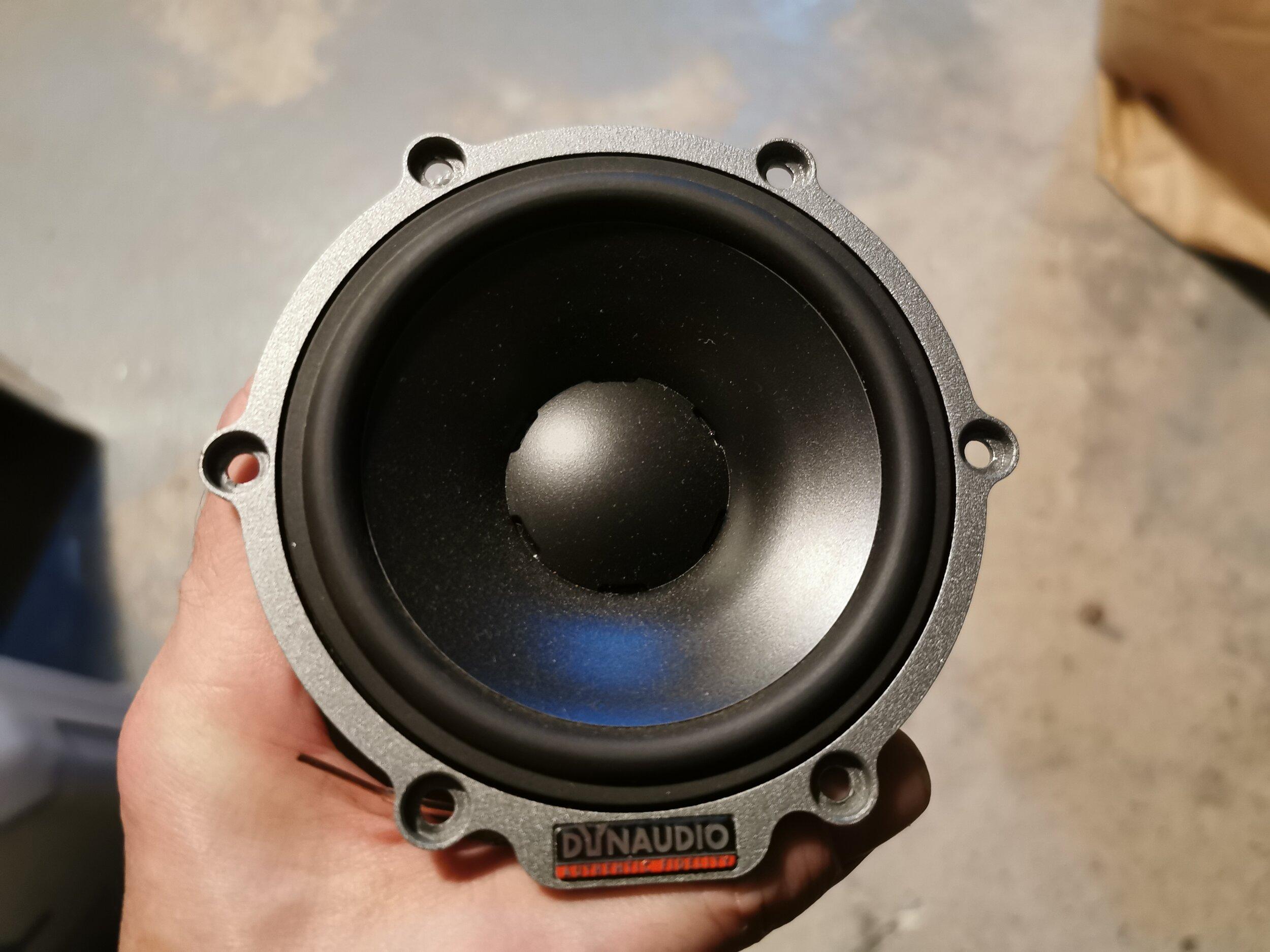

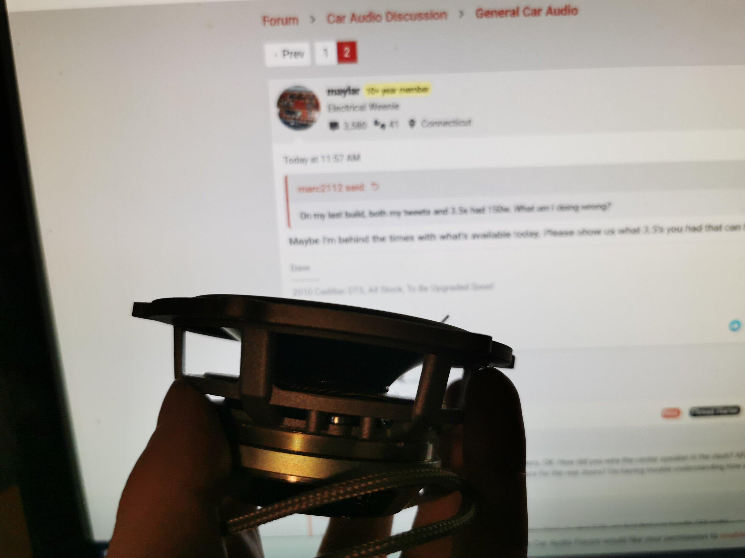

About to pump 280w into these in my current build and no one can stop me.:devilish:

Paid $900 iirc but my point is that I would never use dirty head unit full range power as a reference. Distortion is what kills speakers and you should always use as much power as you can (headroom) with the proper xo point.
