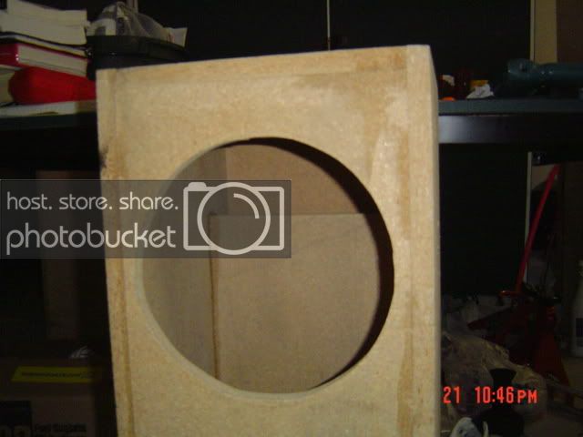

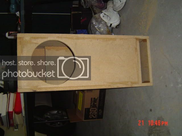

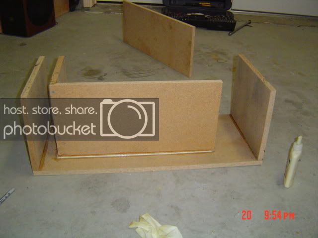

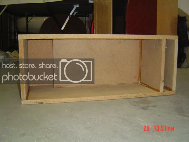

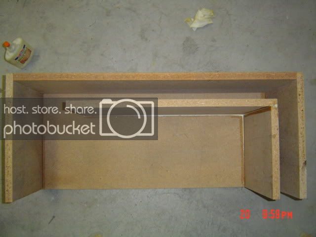

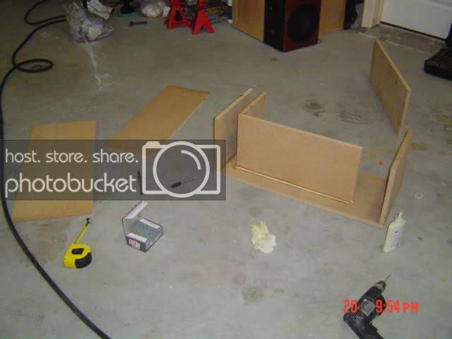

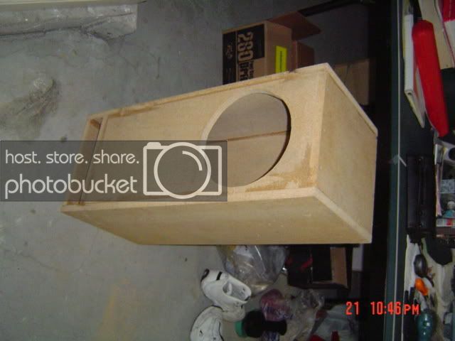

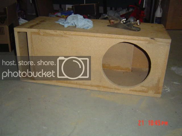

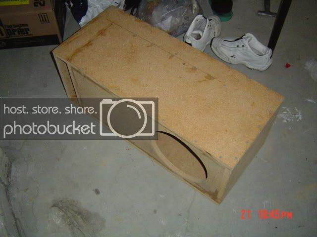

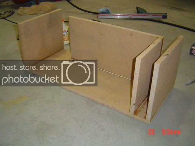

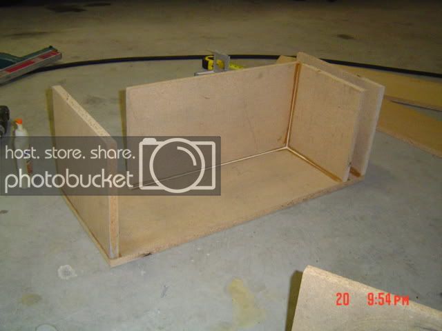

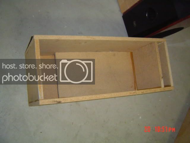

Hey guys, i just ordered a SE 10" from REAUDIO last friday and since there's no boxes for them, i decided to give it a shot and make my own. Had mdf lying around so i started working today. Got all the measurments right for a 1.25 CF tuned at 35 Hz, and started cutting. That took about 2 hours. Then started to glue/drill screws in and that took another 2 hours. I'm almost done, just need to cut the hole tomorrow and glue that piece in, and carpet it then i'm done. Let me know what u guys think, and if there's any helpful tips/advice, i would really appreciate it!
I'm really happy with the box, but who knows, i'm just a newbie //content.invisioncic.com/y282845/emoticons/crazy.gif.c13912c32de98515d3142759a824dae7.gif

done with the box today. Cut the hole for it and all i need left is the sub which is getting shipped to me from RE. Need to buy carpet as well, hopefully it'll sound sweet //content.invisioncic.com/y282845/emoticons/greedy.gif.5a53e6246569d7ab79867170f3b06629.gif

good box build for sure, just too bad thats not MDF, its is the little cousin - particle board. if that thing gets a DROP of water on it. say goodbye.
dont ever put screws in WITHOUT pre-drilling, or they are comming out.
MDF is WAY denser, and has WICKED small particles. particle board is ALOT more porus, and uses bigger chunks of sawdust.
i dont know how bad it will be for flexing\breaking. but be warned... that box is made of not-the-best material... but looks promising.
let us know how it turns out. im not saying that your box is bad or anyhting, just giving you the heads up - next time look for Medium Density Fiberboard, not just Fiberboard, or Particle board.

yea, i realized that today while looking at the wood today at home depot. I'll be building another box but this will suffice for now. Also, i did predrilled the holes as i noticed the first 2 i drilled in had slight cracks in it. I will make a new box and the new pictures will definite be up, hopefully it'll look even more cleaner the 2nd time doing this =]
The only reason i used this instead of the actual mdf sheet that i was about to purchase was because my dad told me he had some at home in the garage, so i put the mdf back. //content.invisioncic.com/y282845/emoticons/frown.gif.a3531fa0534503350665a1e957861287.gif
