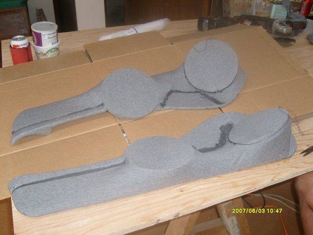

This give you an idea of what the build will look like and where the speakers will be. It's all i got so far, the planning took a while.
Dont use fleece, takes way to much resin to soak thru. Cotton rayon spandex blends work good. Anything with a good stretch in all directions. I grab my Wifes old shirts when I do projects. Use CA glue to tack the cloth to the panel. Spray adhesive will come loose as soon as the resin hits it. Or staple it to the panel.

Finally got some work done today. I'm letting the fiberglass resin harden until tomorrow. Stuff still hasn't kicked in like 4 hours. But you can see how this is going to look now.
