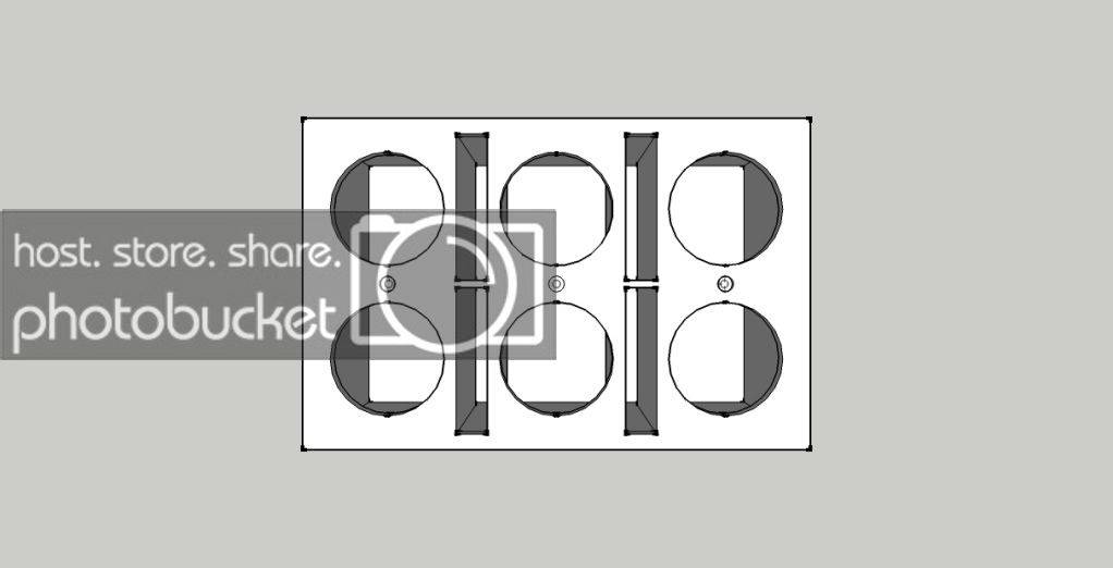

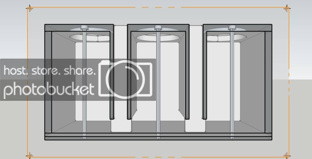

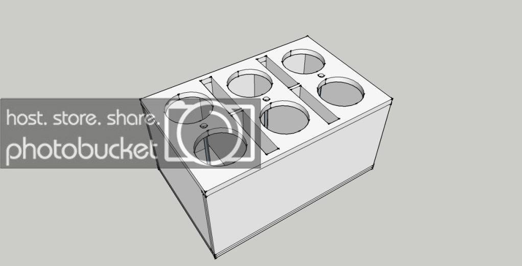

Box is 13 cubic feet after displacement. Box will have 4-43 square inch ports tuned at 32Hz. Box is 1-1/2" thick all the way around with every (every) corner 45ed. (Box and port)
Here is the design
