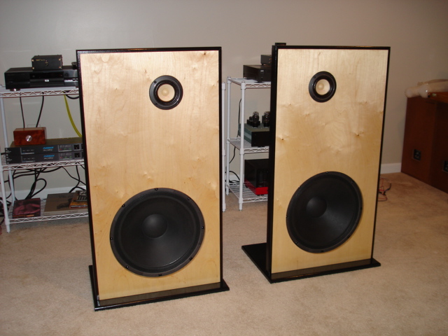

I'll post this on an OB board I'm on, I think it could be appreciated...
Something like this with Fi drivers would be a cool project :
how does this reproduce bass. would see that it would just making wooshing noises, and no output.
i know i know, it OBVIOUSLY works, it just seems so weird to me since i have been stuck with boxes for any system ive ever done.
