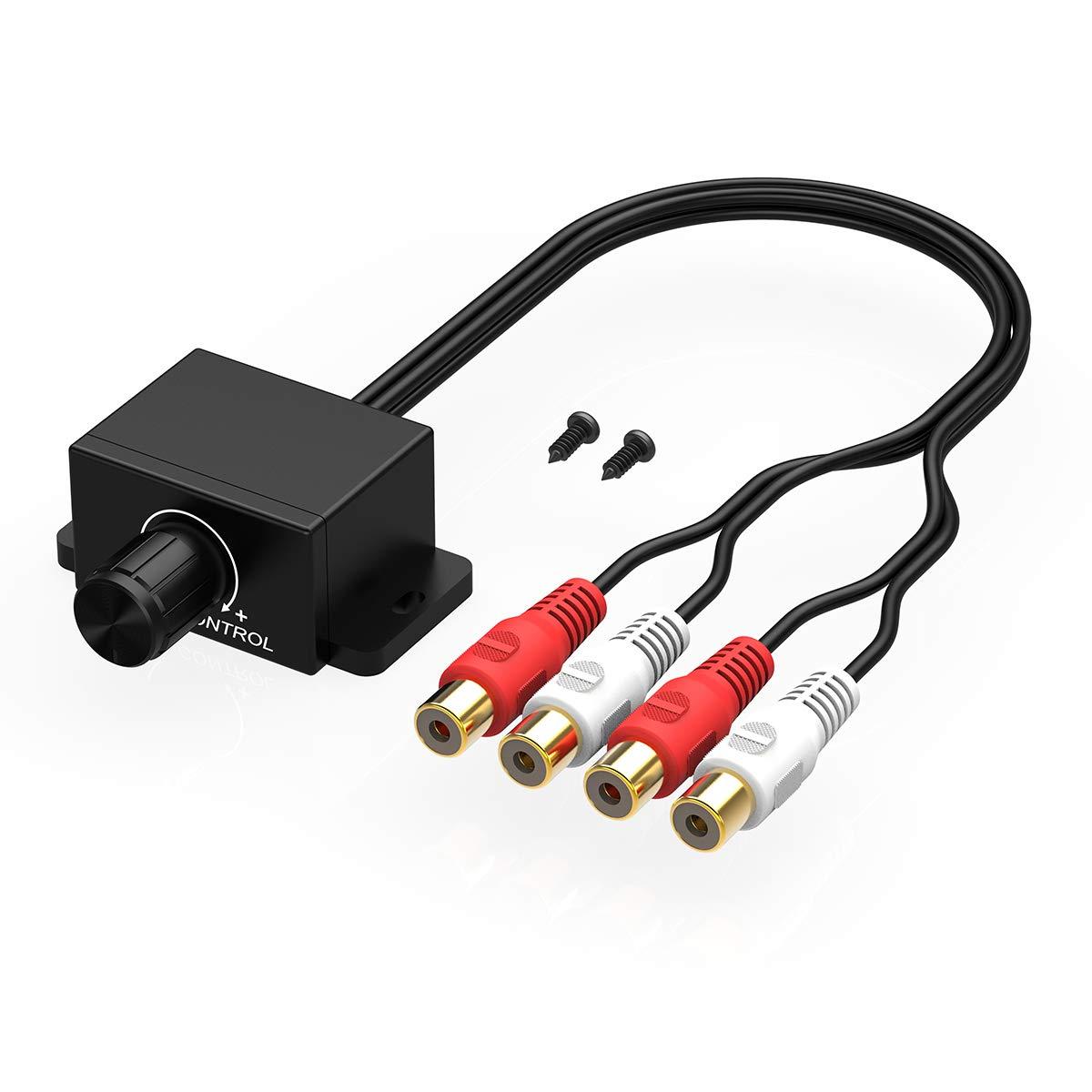

Hard to say. If no other ideas, perhaps look for a line level attenuator with RCA cable inputs and outputs, and put it between the Audiocontrol and the EQ and "maybe" can turn the LOC down a bit further like that. Perhaps something like the RCA cable "bass / level knobs" might work. Hard to say.
Now thats a damned good idea. Im going to give that a shot
If you do try that style level control, be aware you may also need another short length RCA cable(s) or a set of adapters to hook it up as it has female RCA connectors on both ends. You likely already understand that, but easy to miss something simple and not be able to hook it up when it arrives.
