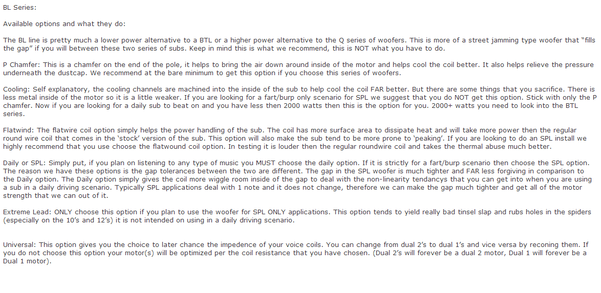

Decided to go with the FI BL 12 for my next sub of choice. I plan on just buying it brand new off the site, but before I do I need help with the options. I've been googling trying to find out some info on it.
Is it better just to go ahead and get every option? I don't plan on going to competition, or anything crazy. Just daily bump. Every option is an extra lie $80 tacked onto the price, and if I can save any money, that would help. But I don't want to skimp out on something that may be worth it in the long run.
Thanks guys
If it's only for daily use get it stock.
Also I plan on keeping the amp I have. A PPI 1800, im sure the FI Can take more, but for now will it do?
Also, completely stock? Not even cooling?
It will be fine. Cooling is good for high power burps. Not needed for daily.
incorrect
the cooling option is a no brainer for daily.
everything else can be left alone
the cooling option is a no brainer for daily. That's about it
I'll probably go ahead and get cooling, just to be safe.
Especially with how how it is here anyways.
I just took a look at them. They build them in house correct ?
yep. It'll take about a month and a half from order placed to your front door.
