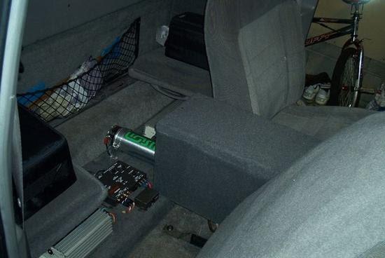

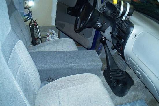

I had my sub firing up in a BP4 in a 1996 Ranger SuperCab 3.0L V6.
