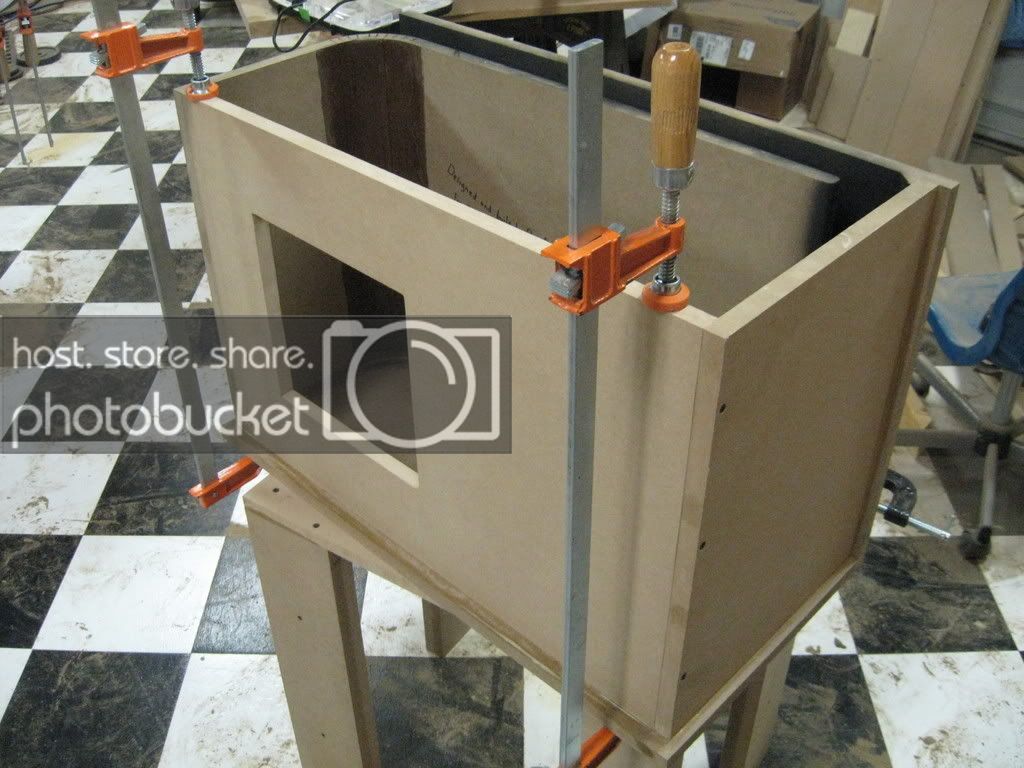

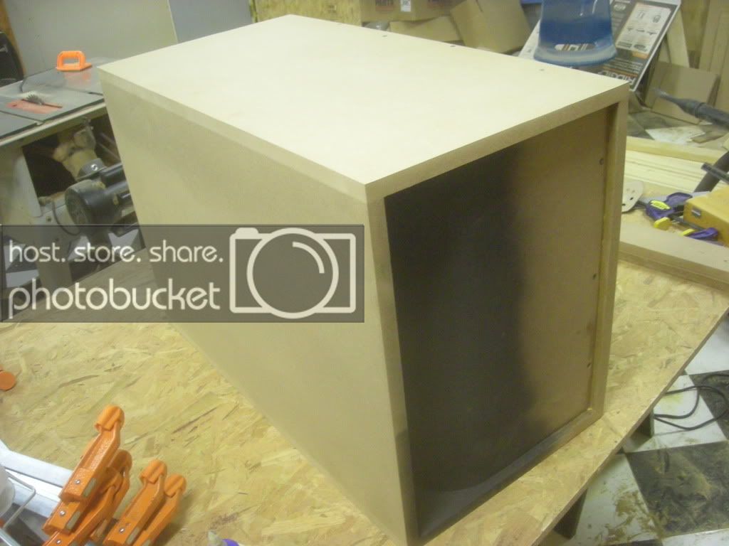

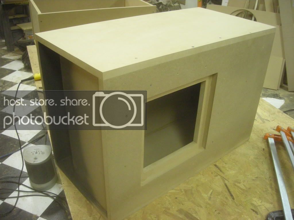

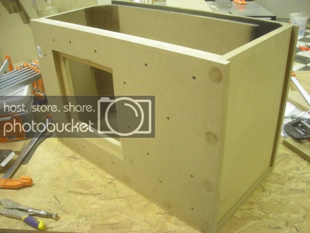

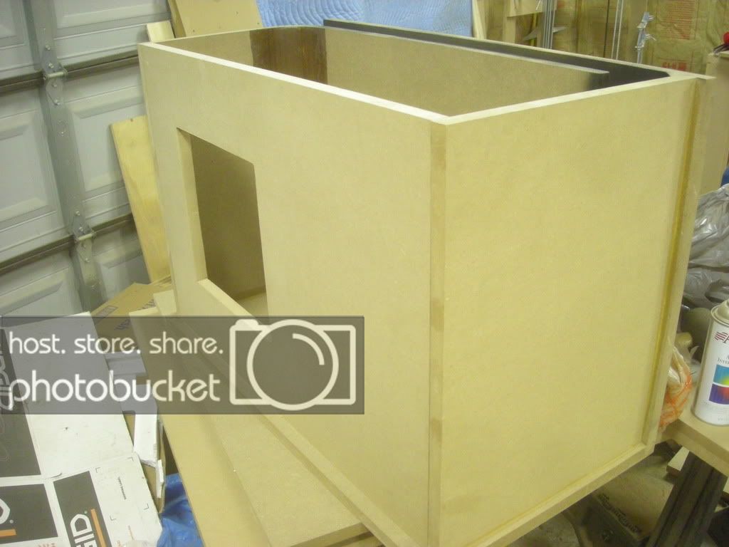

Enclosure Build for Jeepjones85
Just a couple more..

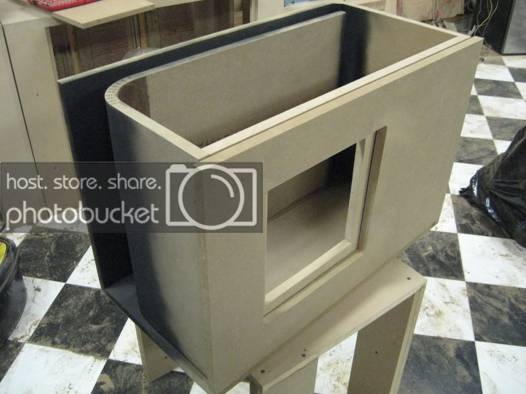

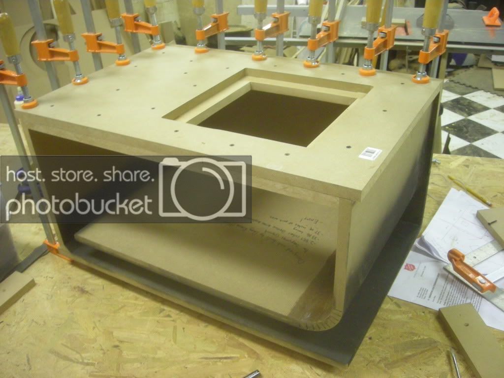

The KERF is SOOOO gorgeous!
How do you do it!?
Is there a special adhesive you apply to it so that the uncut surface of the MDF doesn't crack? How far apart are your cuts?
Thanks man..//content.invisioncic.com/y282845/emoticons/biggrin.gif.d71a5d36fcbab170f2364c9f2e3946cb.gif
And how many cuts etc is based on how big of a curve you want...And the number of cuts all depends on how much less the circumference of the inside of the radius is (on the 3/4" mdf) compared to the outside...this is how much material you need to take away, devide that by the thickness of your blade and wham...you have the number of cuts you need to make...then do some math to space them evenly accrossed the area you plan to kerf //content.invisioncic.com/y282845/emoticons/smile.gif.1ebc41e1811405b213edfc4622c41e27.gif
I like to resin the inside of the kerfs like in this build
