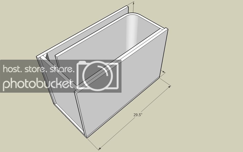

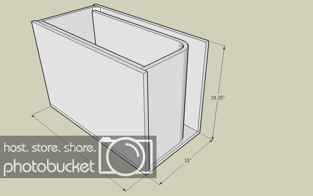

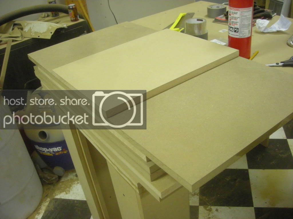

Hey guys, this'll be for Jeepjones' Solo-X 10"
Specs come to:
2.857 cubes before driver displacement
33Hz tuning
37 sq inches of port
All I have done at this point is the pieces cut...plenty more tomorrow night..
And here's a sketch-up..

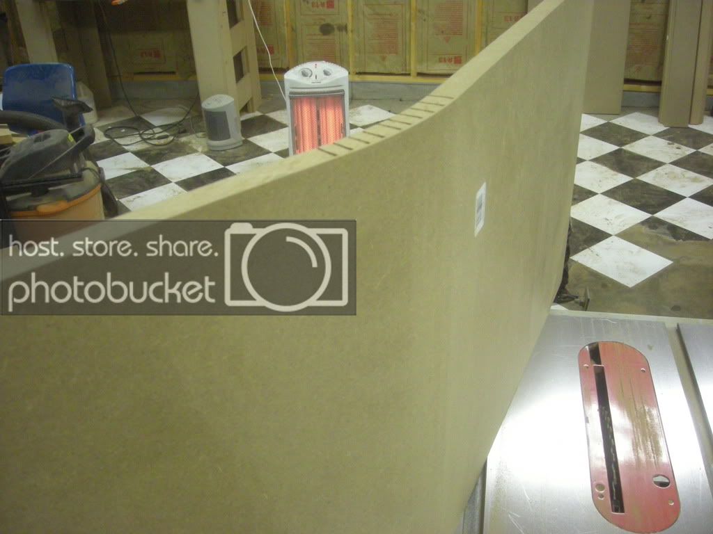

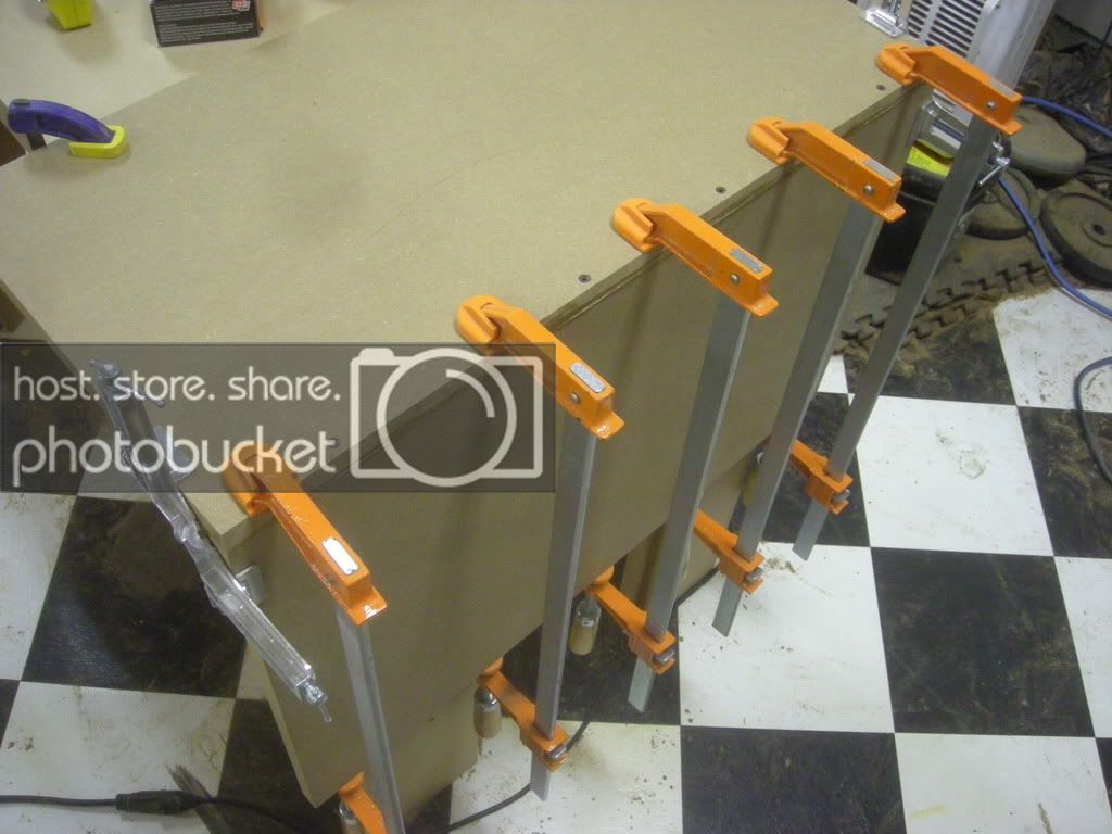

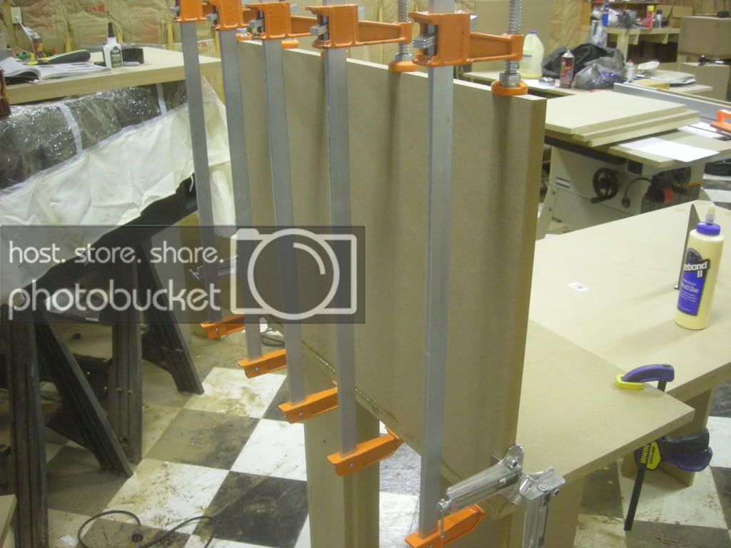

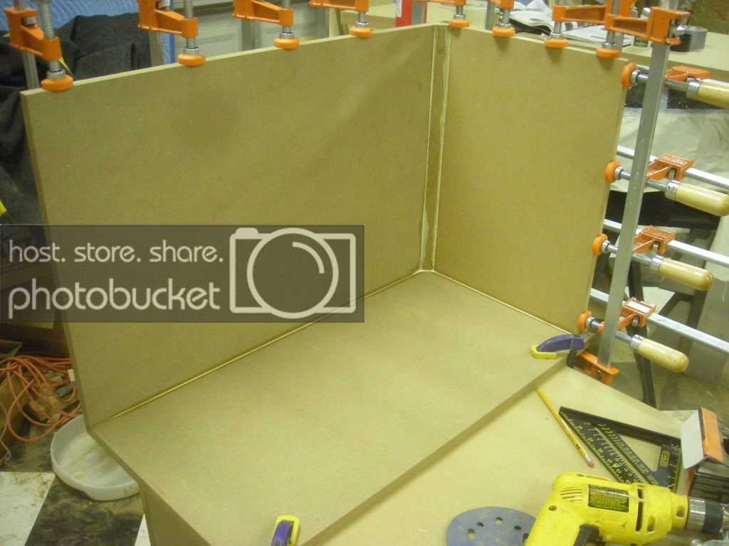

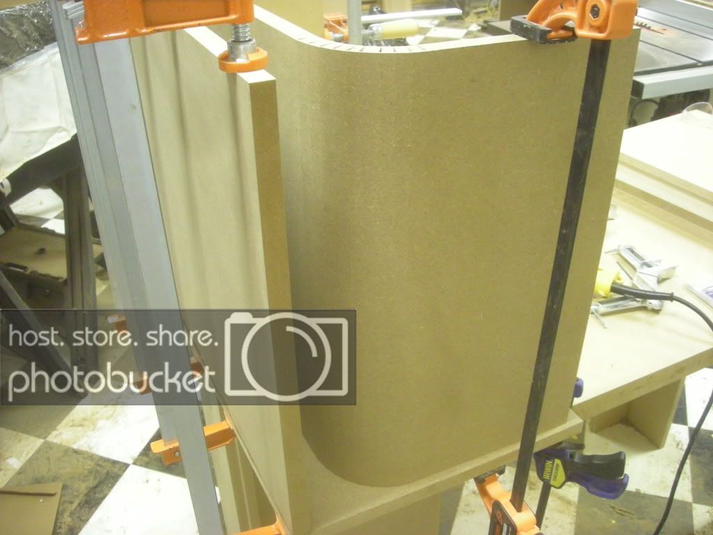

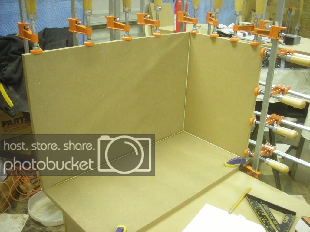

Kerfed piece cut..
Setting it up to take a look..
Not lined up to perfection, but you can see the idea..

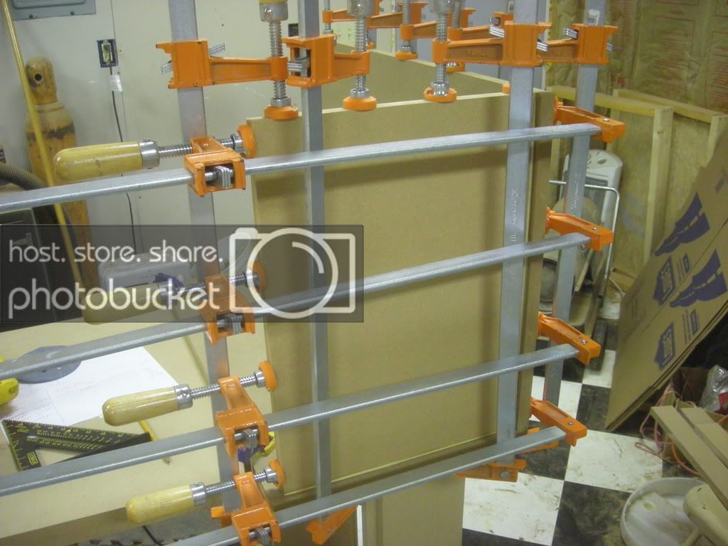

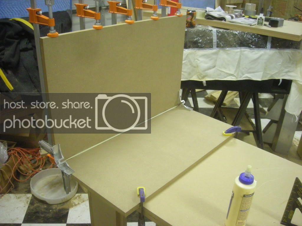

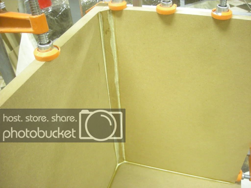

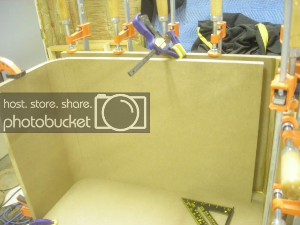

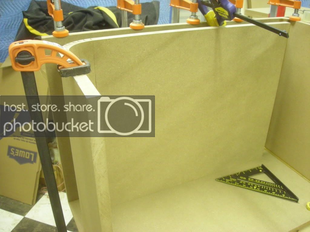

More as they come //content.invisioncic.com/y282845/emoticons/smile.gif.1ebc41e1811405b213edfc4622c41e27.gif
