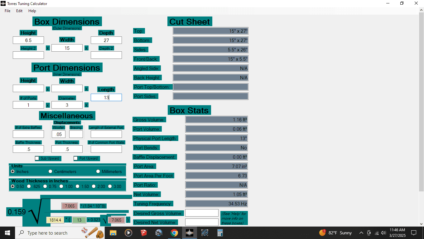

Quick and dirty with a little resizing using Torres note the overall size has changed and using a 3" round port 13" long should put it about 1ft3 net tuned 35hz or so.

Yes, that changes things because those do not have equivalent area. Area of a circle is pi*r^2. For a 3" pipe that's 7.07 in^2 and for two 1.5" pipes that's 3.53 in^2 total. You'd have to use 4 of the 1.5" pipes to achieve the same port area as a single 3".

Hey @shredder1, I'm finally getting around to building the box and realized the depth is off by 1.5." Can you confirm that if I do 6.5 (H), 30.5 (W), & 13.5 (D), that I'm not impacting the build in a negative manner given the previous specs? Additionally, what length does the port need to be now? Thank you.

6.5h x 30.5w x 13.5d using .5" materials?
Single baffled and using a round port?
What tuning are you after, do you have specific goals in mind?
Thx for quick response! Yes, .5" MDF, 35hz, single baffle and 3" PVC port. Height and Depth are locked at 6.5" & 13.5."

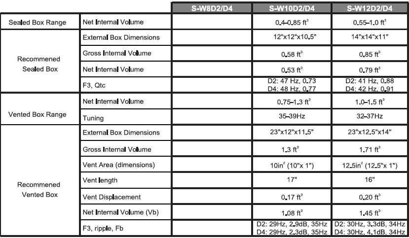

Its being built for an Alpine Type S 10D4
I'd go with 29.5"w and a 3" pvc 13.5" long
