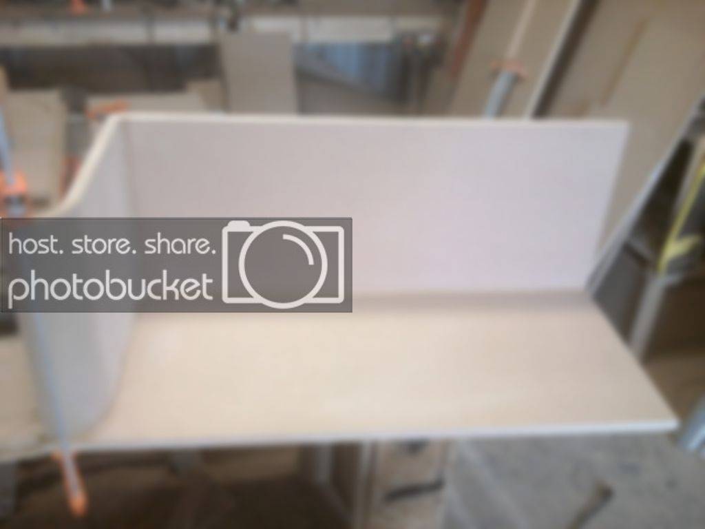

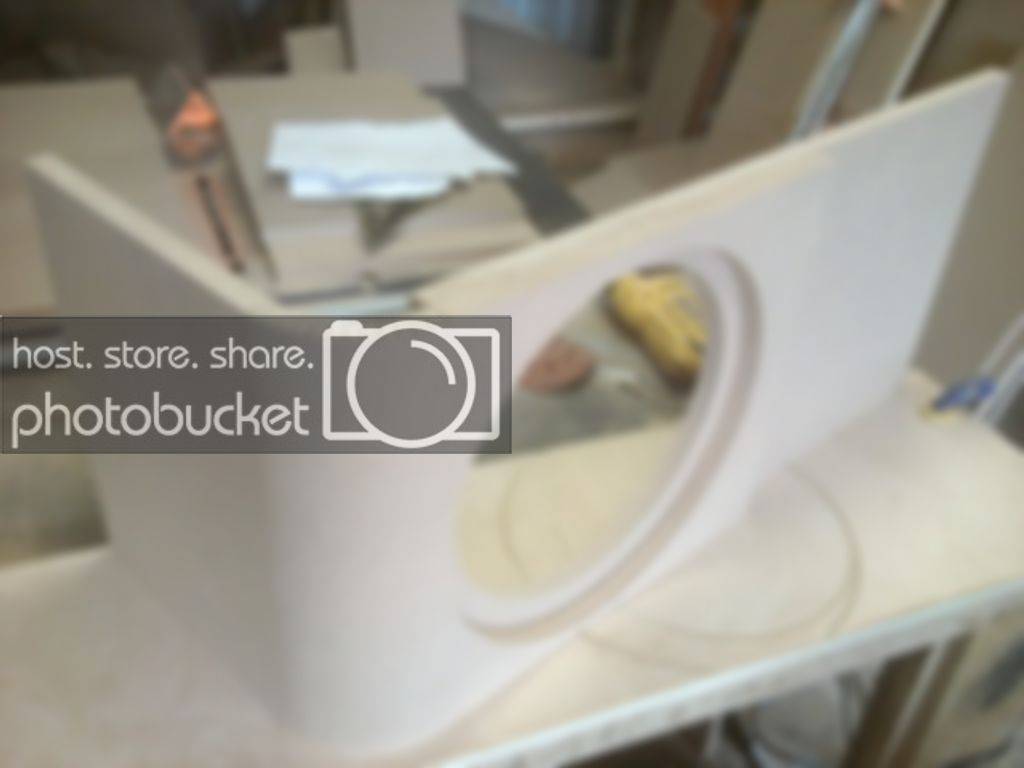

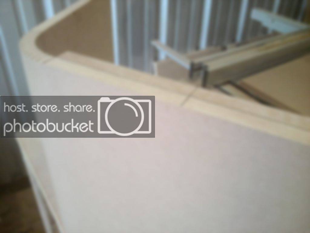

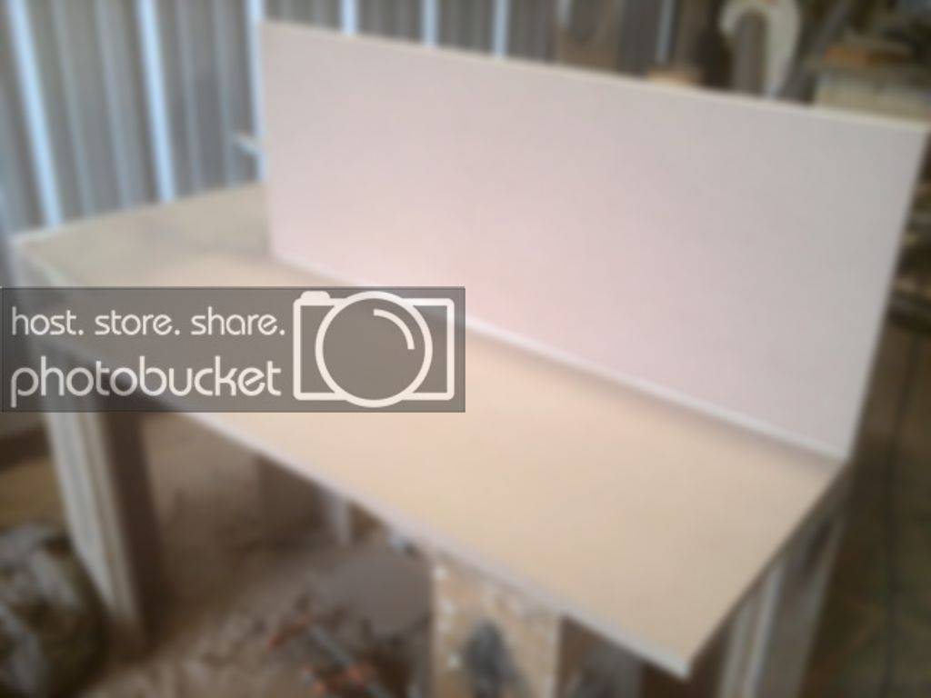

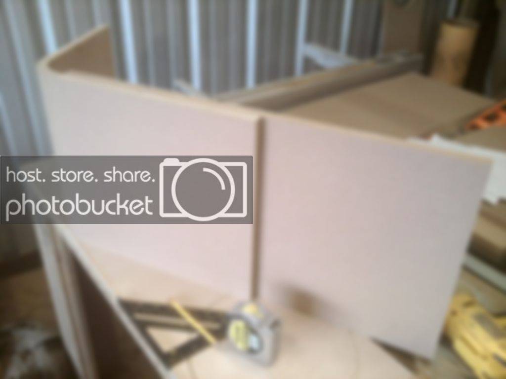

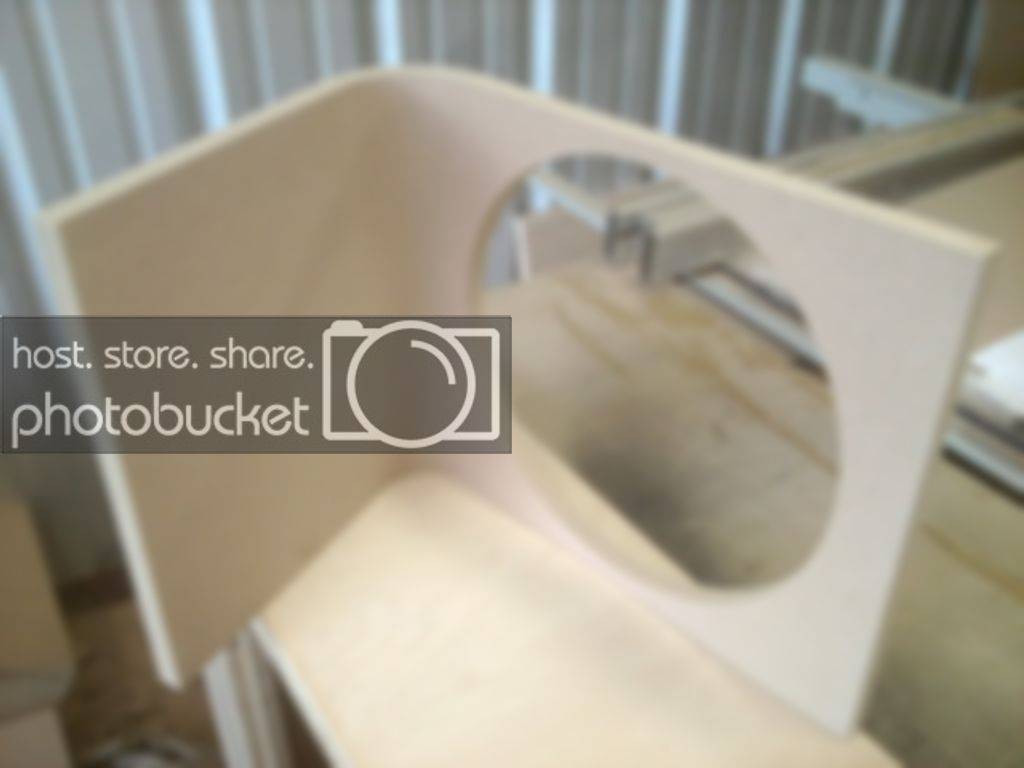

Alright, this build will be for Herts5400's buddy's 12" AA Avalanche.

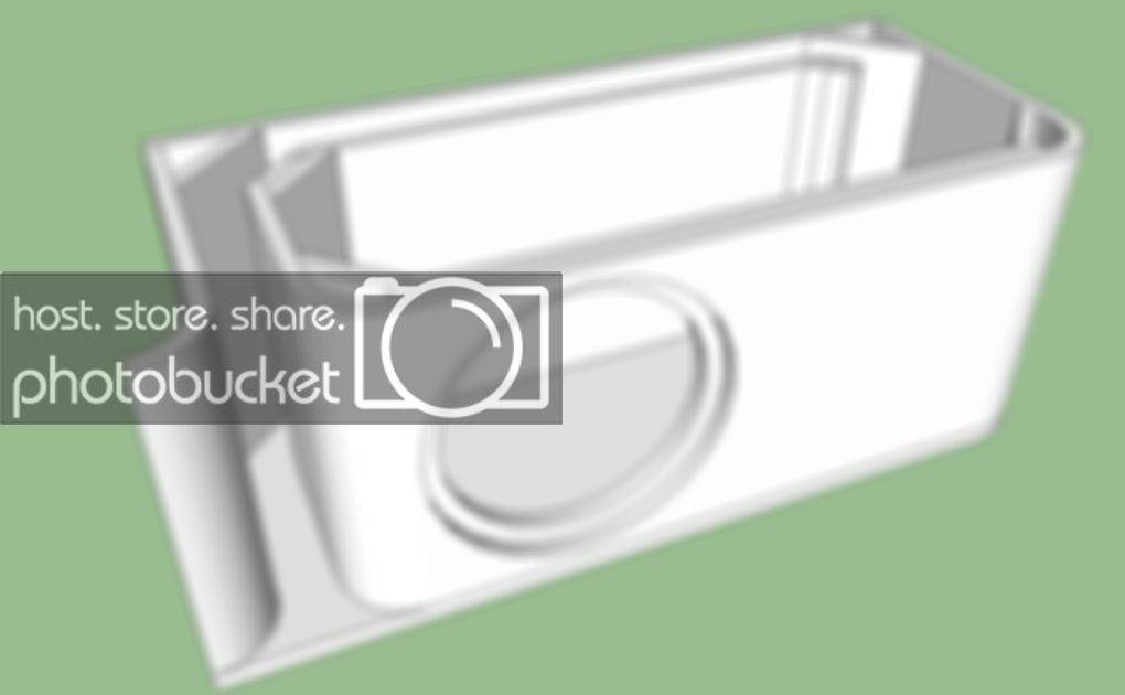

A look at the design...
Specs come to:
-2.275 cubes net
-28hz tuning
-33.25 sq inches of port area

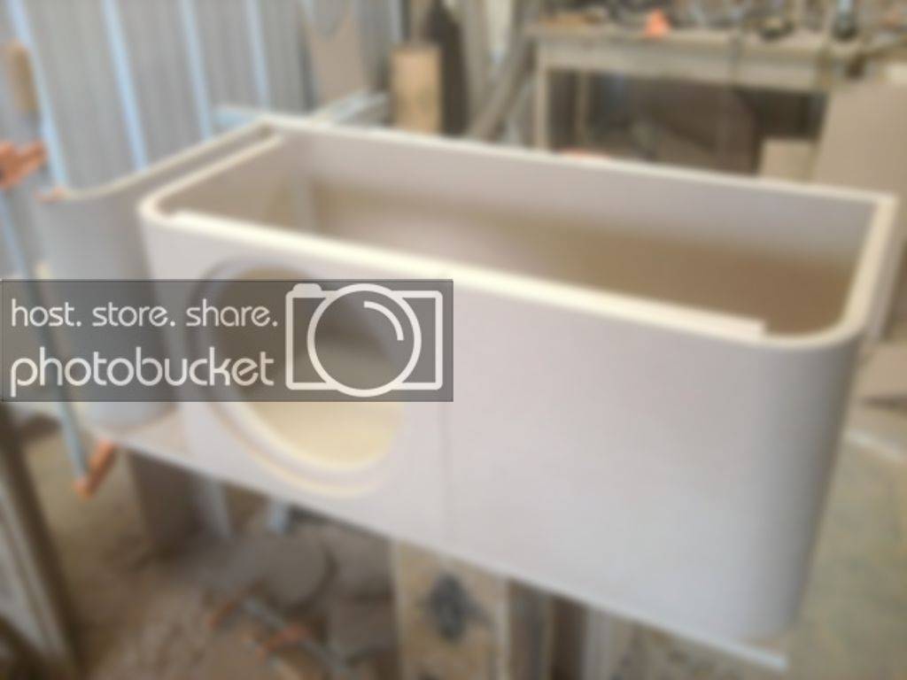

whats a kerf ported enclosure? lol
Kerf's are the fancy curves lol. OP it seems like it would be a waste to add in all that kerfing but not even drop a 45 in the port. Are you going to route out the excess behind the wall where that outer kerf is?
What? lol the port corners are both 45-ed...?
