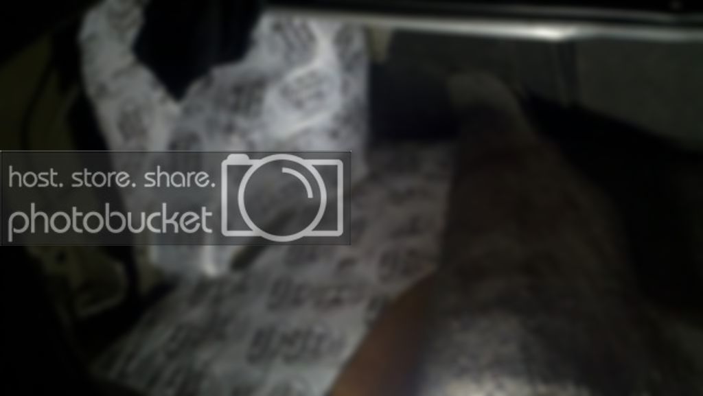

Got bored and ran to home depot to pick up some sounds insulation.
Was looking for peel and seal but all they had was this stuff called protecto wrap.
Looked decent enough and for $17 for a 6" x 50ft roll i figured might as well give it a try.

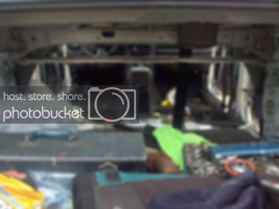

With 1 roll i was able to do the whole floor and spare tire well of my trunk along with the inside and outside of my trunk lid and 1 wheel well. The second roll i did the other wheel well and underneath my back seat and still have around 30ft left.
Only have 1 pic of the protecto wrap, but ill get more.

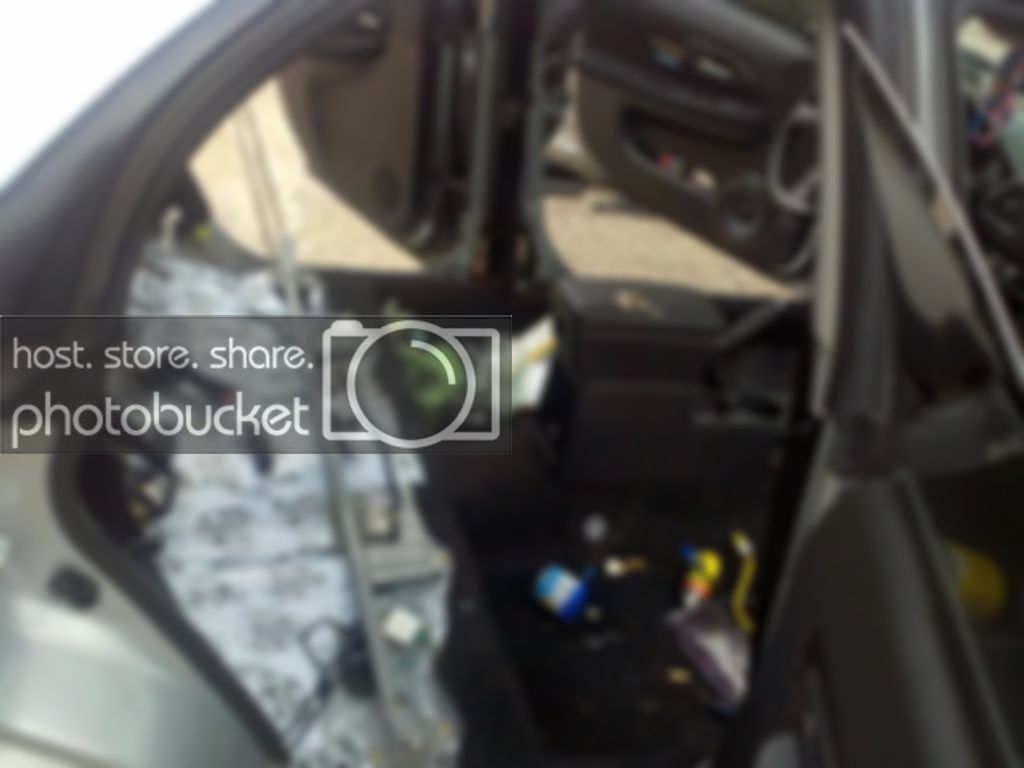

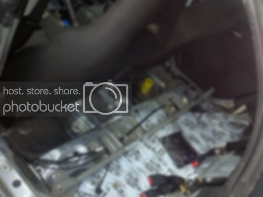

Then i ran to another home depot out by my aunts house and they had stuff similar to peel and seal.

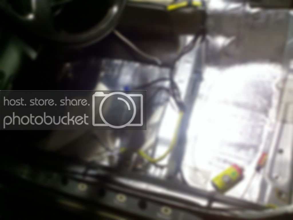

Butyl rubber with aluminum backing. $15 for a 6" x 25ft roll so i gave it a shot.

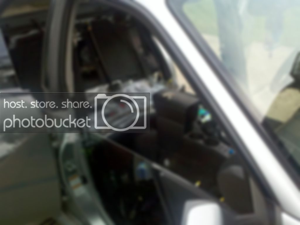

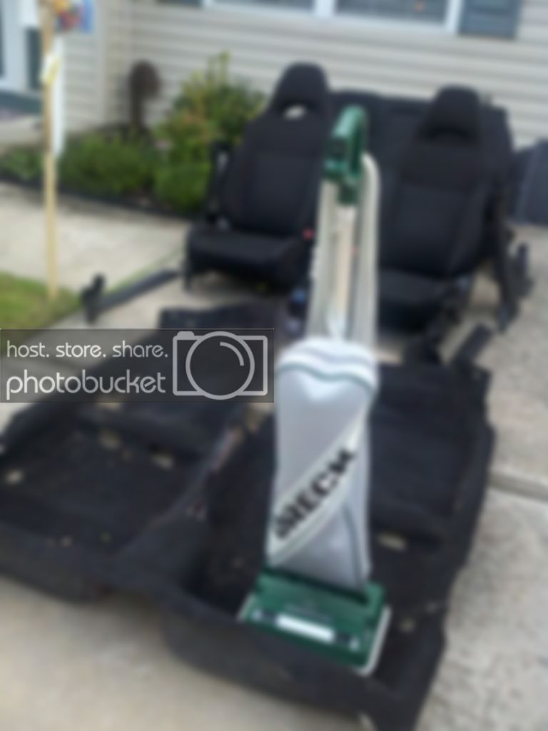

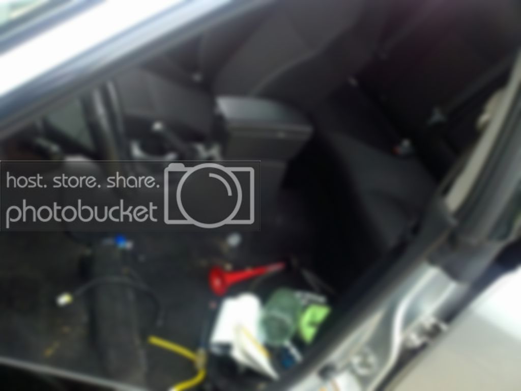

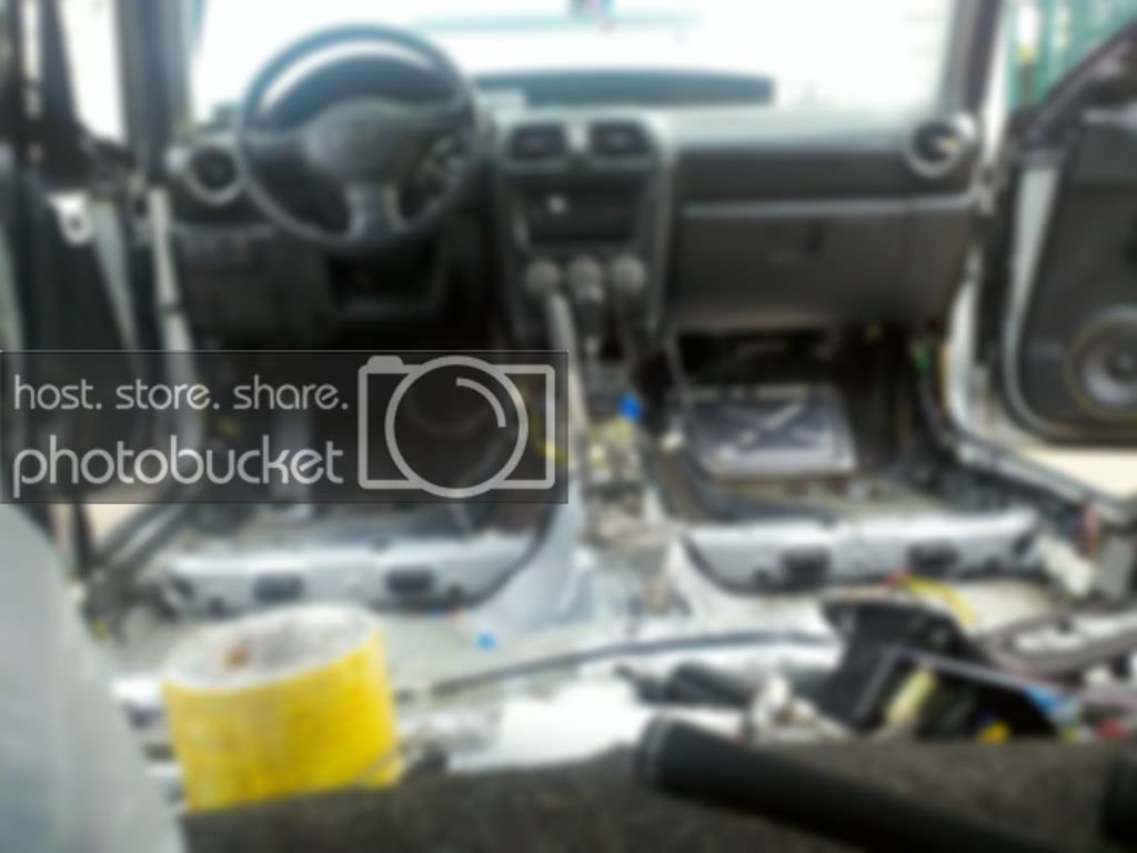

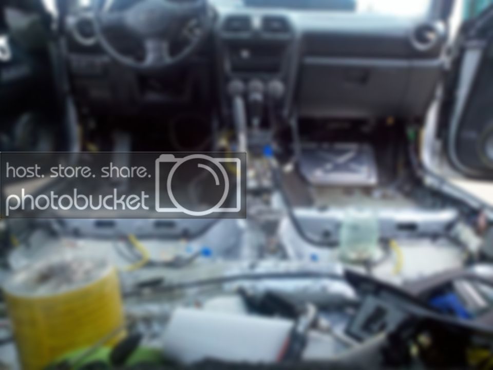

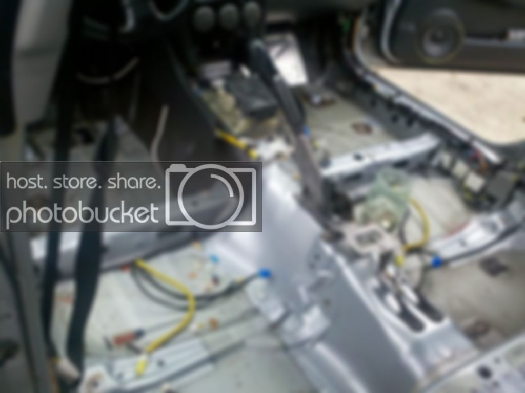

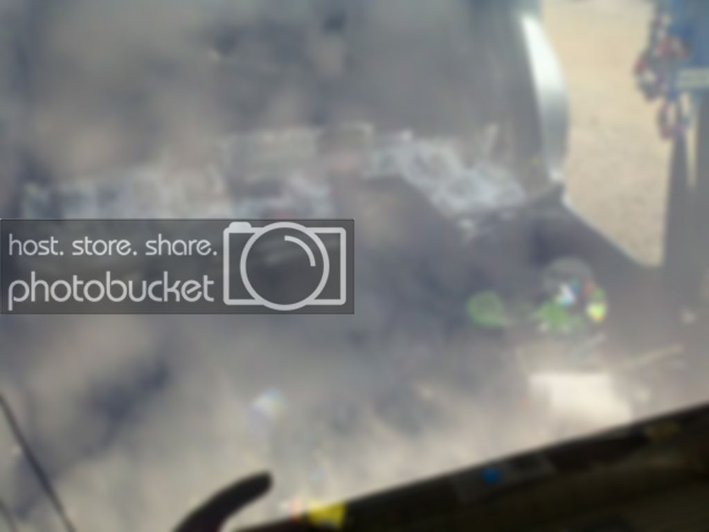

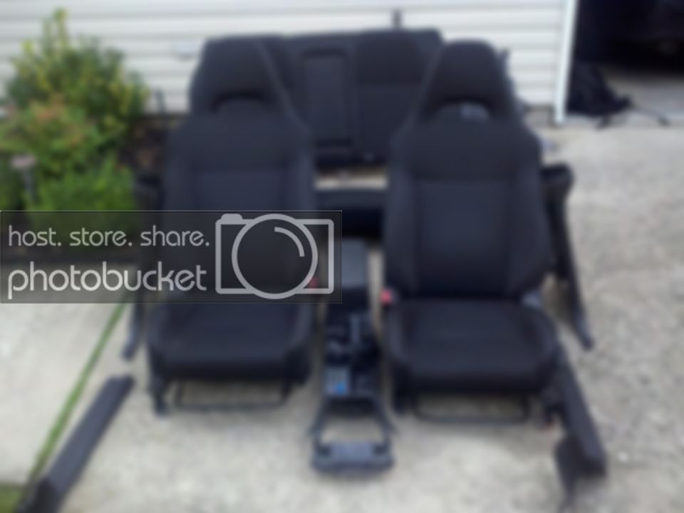

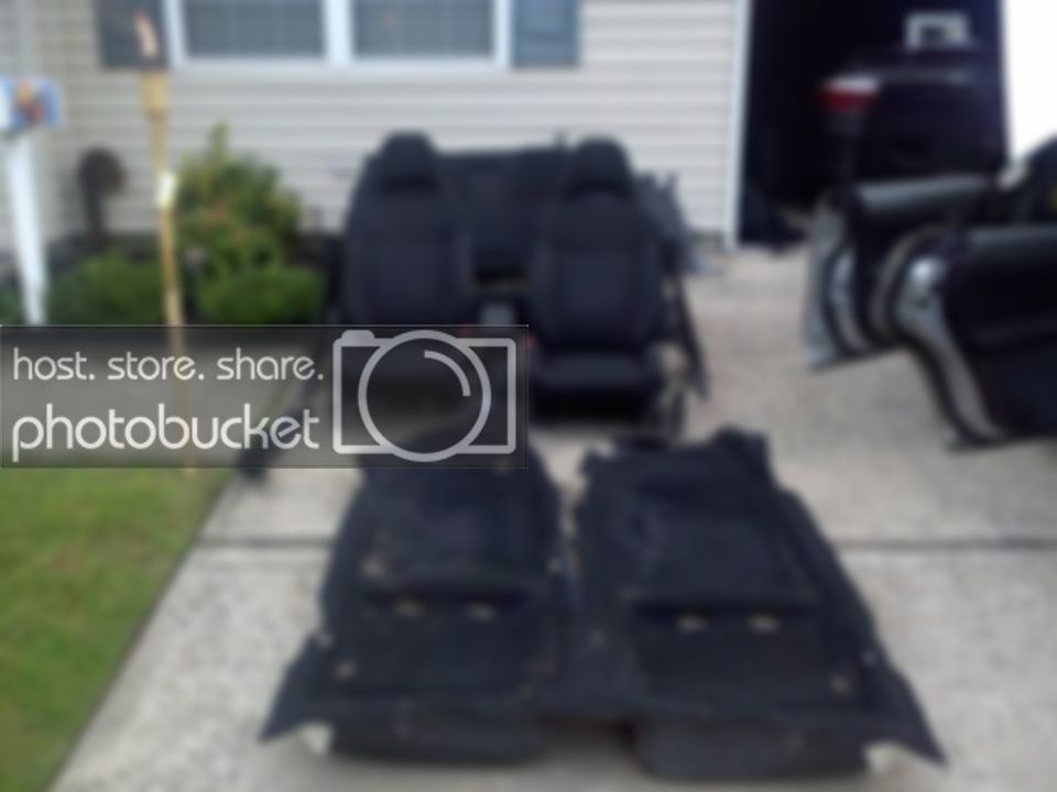

Almost completely gutted the interior of my car.
With 1 roll i was able to do 75% of the floor in the cabin.
Pics from start to halfway through.

It is quieter with no interior and just the deadning than when i had full interior and no deadning at all.
Once i finish up a few more patches and put everything back together it should be a pretty big difference.
