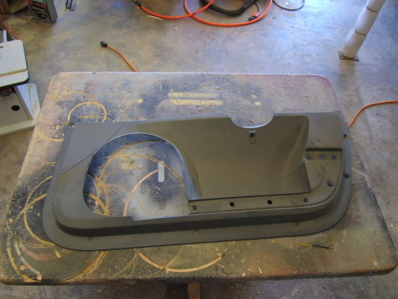

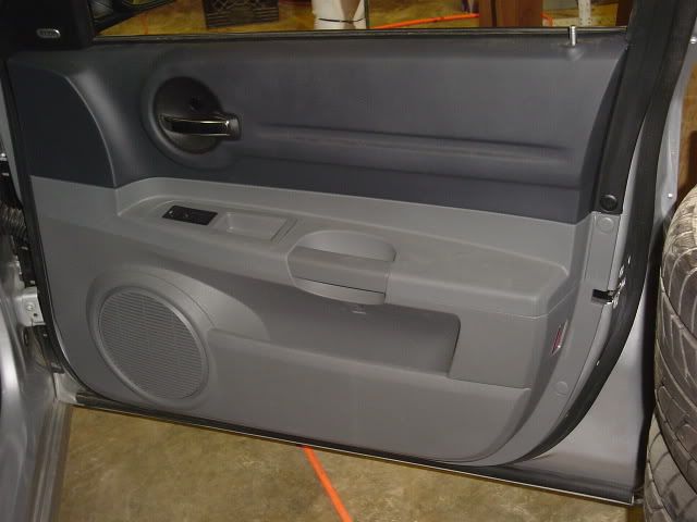

For good quality resin and materials I use U.S. Composites (http://www.uscomposites.com). Also, ditto what was stated earlier. Your grills will come off. Here is a pic of my door panels. I basically cut off the whole lower half of the panel but I first had to remove the melted plastic tabs. I'm not saying they're the best thing since sliced bread but I'm happy with them. Just my two cents.
I have seen that car ............. Magnum ........ah yes , carsound ? Very nice car //content.invisioncic.com/y282845/emoticons/smile.gif.1ebc41e1811405b213edfc4622c41e27.gif
See, that's what I'm talking about when I say quality work. It's well integrated, sonically intelligent & has a factory look in terms of finish. Nice work.

you make a very good point. Customtronic you got any more pics of the buildup. I want to see exactly how you did that because well thats exactly what i want to do. Thanks for the help guys.
Wow i just noticed your pictures on carsound. And i disagree. They are better then sliced bread. Question though how did you attach the bottom to the rest of the panel and what fabric did you use?
