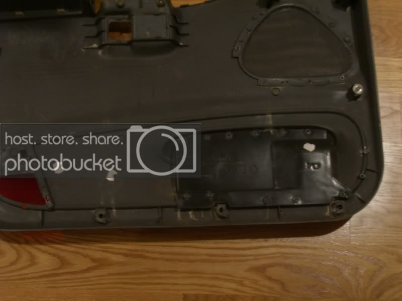

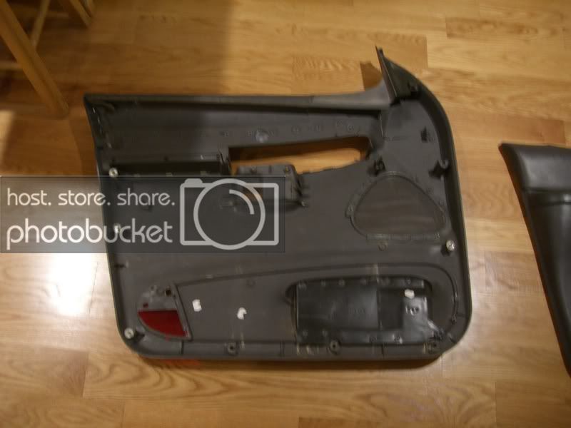

Grill Doesnt come off here is some picstures from behind...
O yeah and any ideas on a hu when i go active?

those grills look like can come off by grinding the back plastic tabs that they melted to keep them in. if you need to put them back in place for what ever reason you can drill a small hole on the little stud thats left behind and screw the grill back in place.

thanks they where pretty easy.
