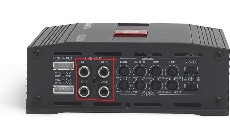

I recently bought a JBL Stage A6004 (4x60w RMS 4ohm, 140w RMS bridged 4ohm) and a Bazooka BT8014 (6-150w RMS 4ohm) to go along with 2 DD Audio CX5.2s (60w RMS 4ohm). As the title says I wonder if I need a new head unit, I'm very new to the car audio world so any help would be appreciated. The amp has 4 RCA outputs, and my head unit has Front L and R, Back L and R so I would assume I can run the amp on my head unit, but I was not for sure. I have read that my head unit can run subs but not speakers with it, but I was not for sure. Any help is appreciated.
I have attached images to the post to give a better idea of what I am talking about input and output wise, I attached a picture of my head unit but the antena wire partially blocks the ports, so I got an image of a similar head unit to compare it to.

Yes your headunit can run that 4 channel in 3way. Like you want
You likely have a setting to switch the rear channel RCA to sub if not it doesn't matter you can run them full range to the amp and lpf the rear channels at the amp
