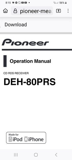

The manual is located on the Pioneer site.
