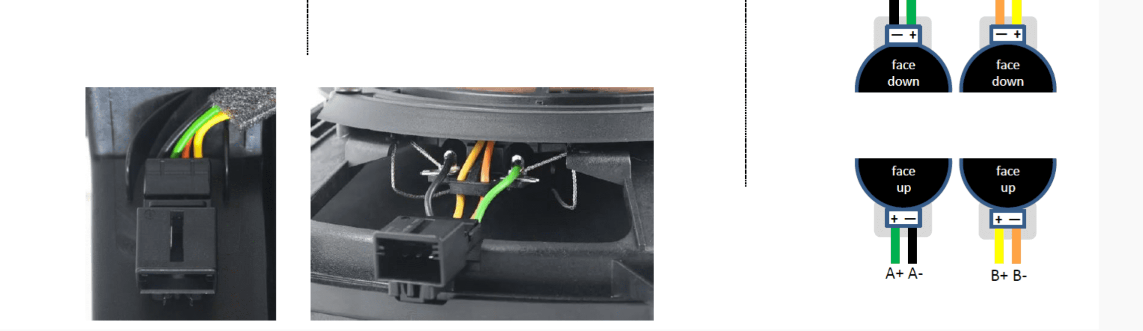

So ive bought another speaker cable to RCA converter adaptor, this has plus neg plus neg cables
this original B&O subwoofer looks like its dual voice coil, so I'm trying to figure what cables connect to the adaptor? would it be black green to plus neg and orange yellow to the other plus neg on the adaptor?
