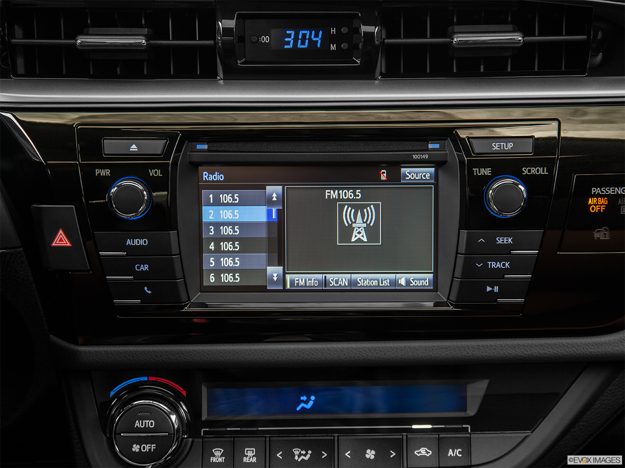

get hu like mine $119
looks wise its a complete downgrade. turns a relatively okay looking ride into a cheap ghetto blaster.
All these newer cars with all the extra BS involved....making it hard for us audio guys to remove for better audio...
