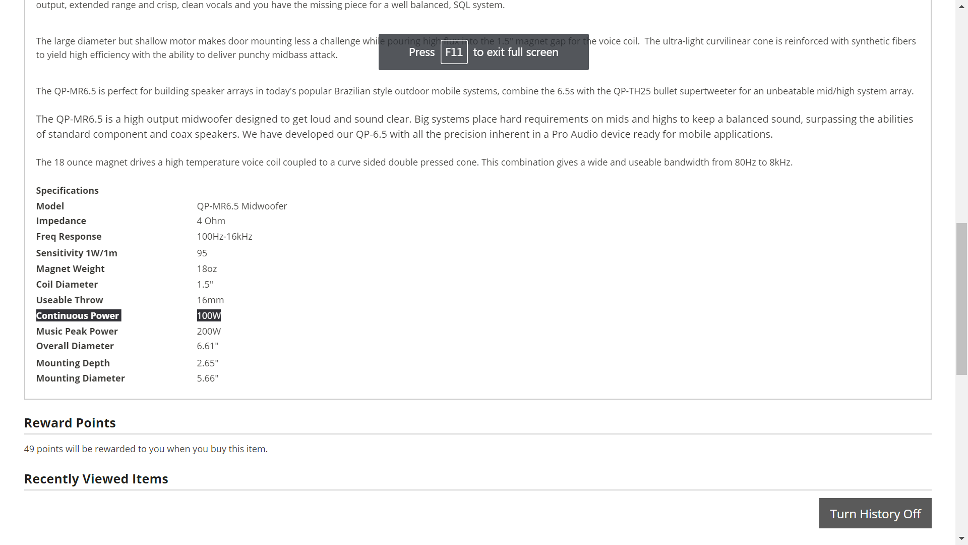

SQs do play low, your install and tune is not good enough to bring that out. Why do i say that? I USED SQ before, they pound the midbass section easily. You cant expect anything out of head unit power when that driver is rated for 100+ watts and you throwing peanuts at it.
You havent even created the proper acoustical environment for any aftermarket speaker to play midbass either.

You drunk gramps, they cost 55 dollars for the pair but they arent rated 55 rms. They are 100 each, You throwing at best 15% of what they want to perform. They do fine in the proper environment and proper tune with proper power. I had 145 watts to each and when the kick drum snaps, you feel a deep, sharp kick piercing through your lungs.
