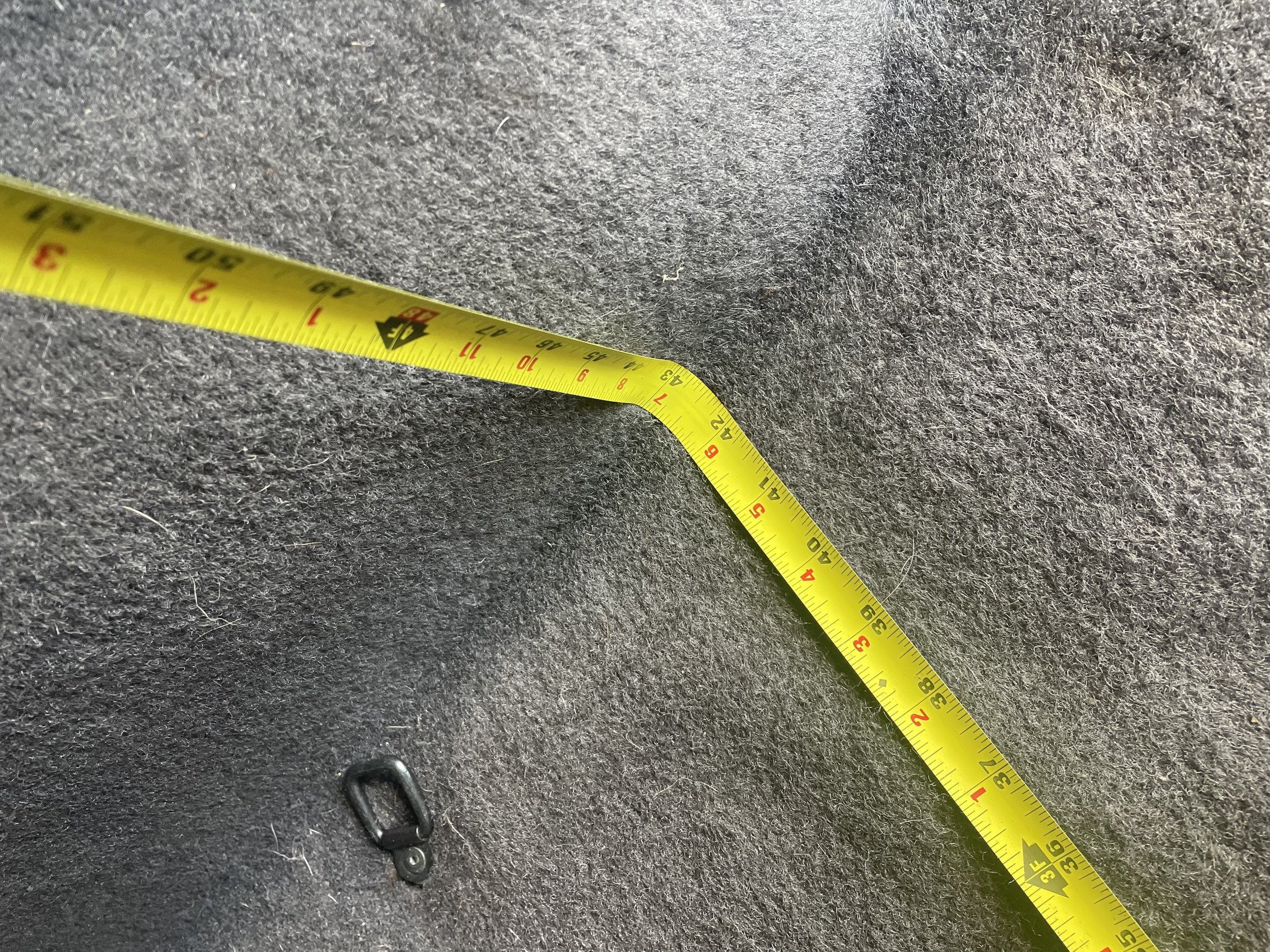

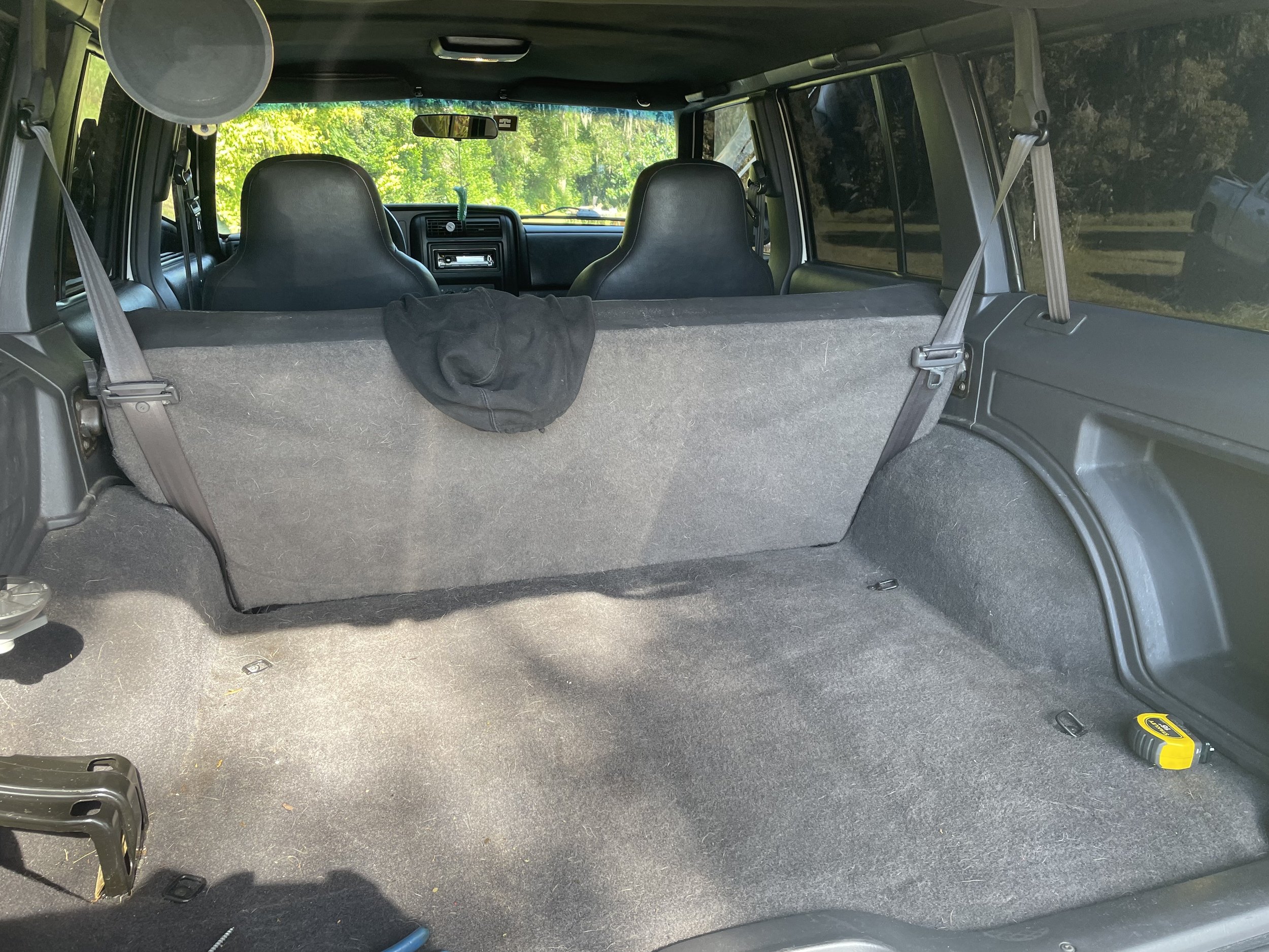

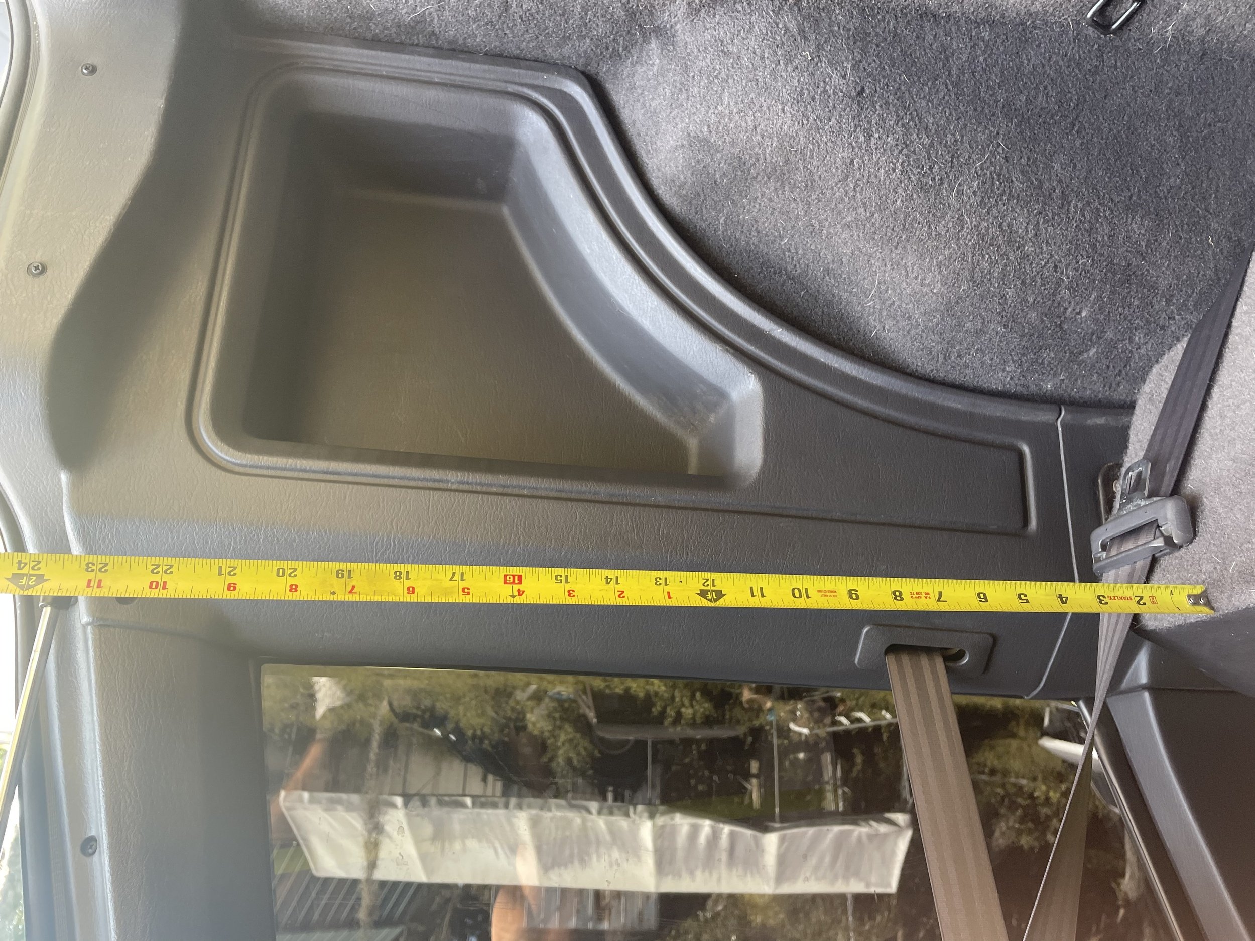

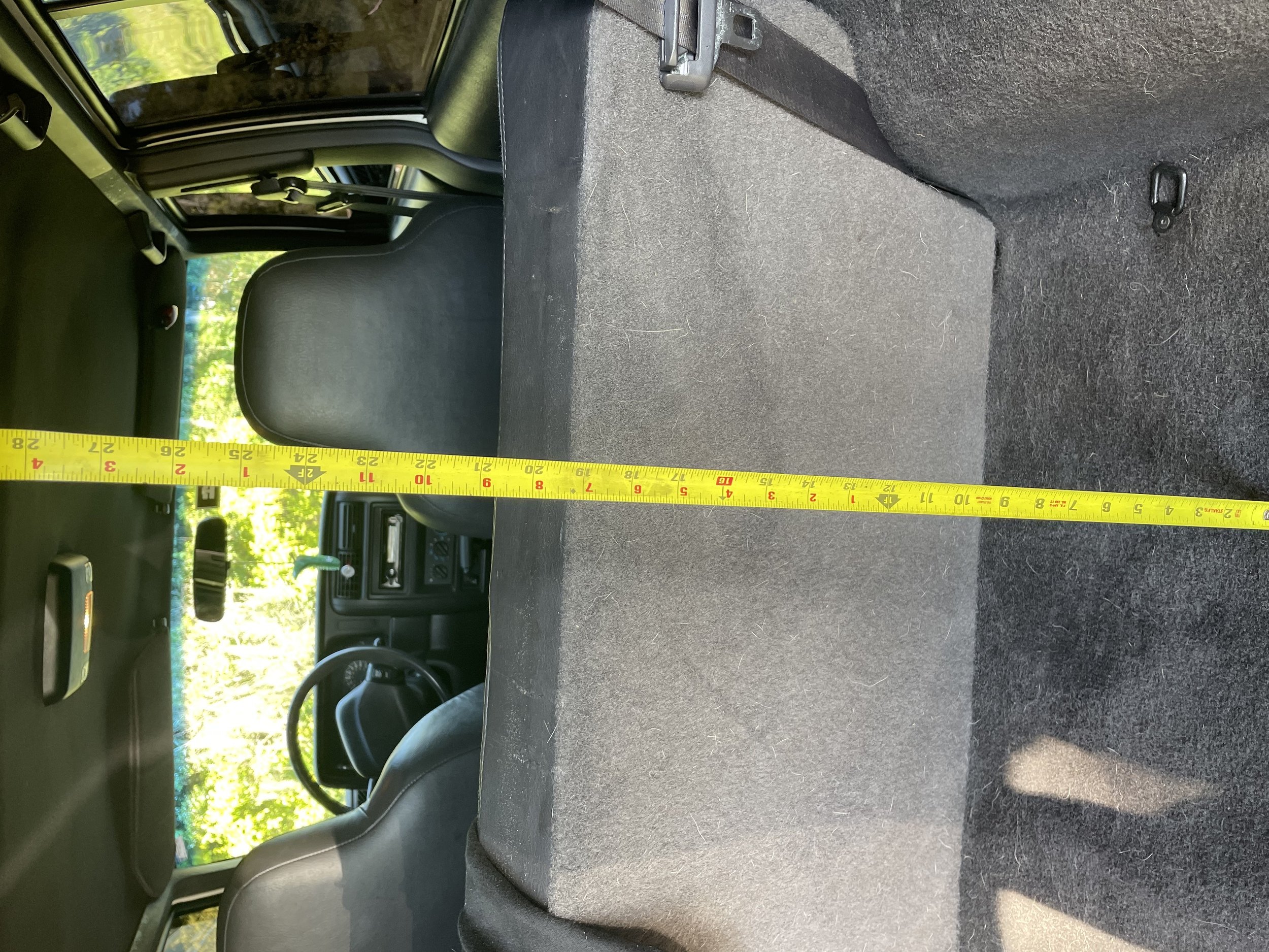

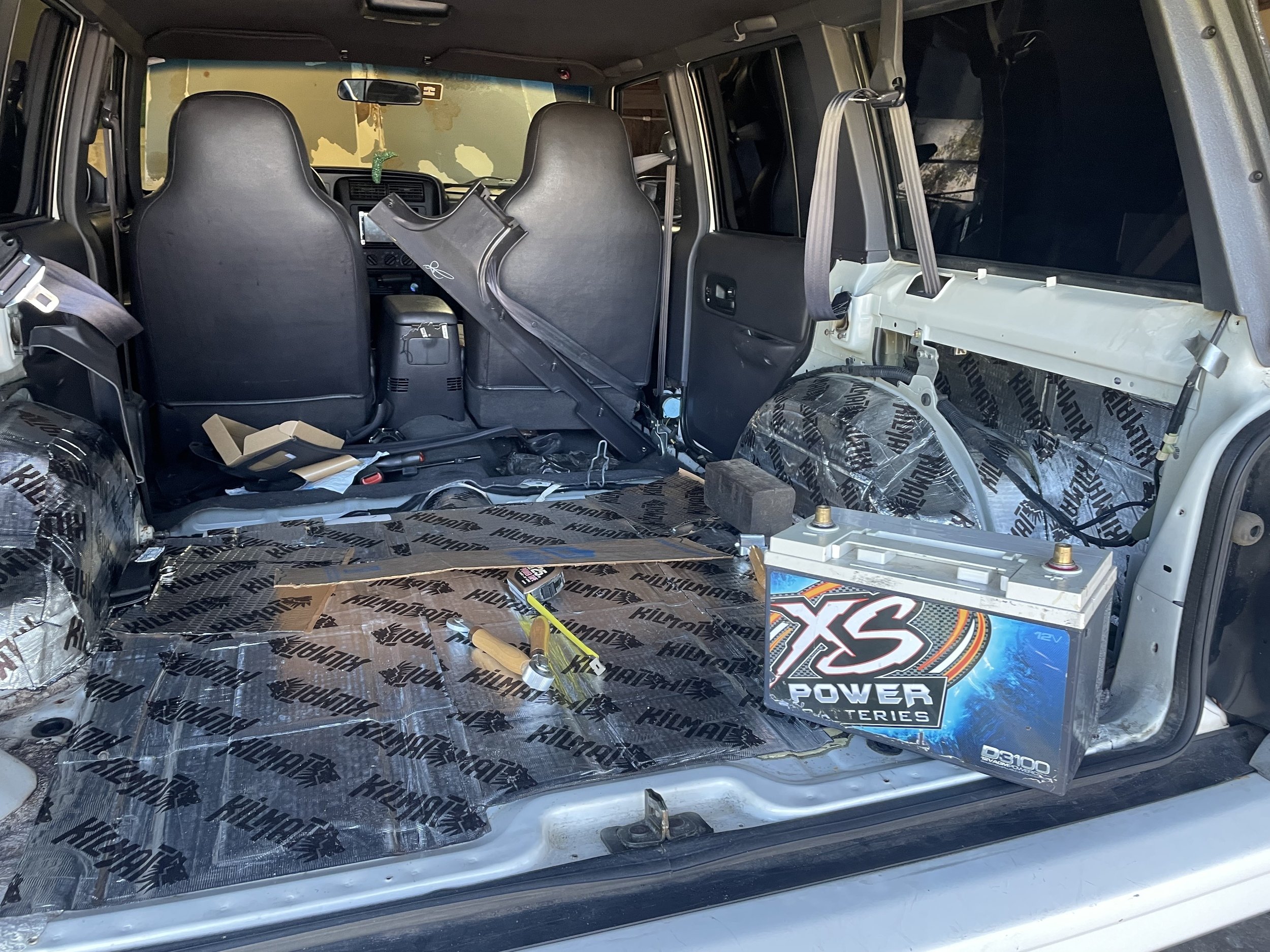

Sorry if I don’t have all the questions answered but I’m learning as I go. Long story short I had someone building a box for me and ended up having some problems. I have 2 sundown x12s
Vehicle : 01 jeep Cherokee
Location in the vehicle: trunk/hatch
Space available (Length x Width x Height): up to 18”x 42”x up to 21” could go more on length and height but really don’t want to unless it’s going to make a big difference.
Subwoofer make and model: sundown audio x12
Subwoofer Size: 12”
Number of Subwoofers: 2
Type of Port (Kerfed, Slot, Aero, etc.): Aero ?
What type of music do you like?: hiphop/rap and country
Is your goal SPL or Everyday Music?: spl
Tuning Freq (Hz): 32-39?
Volume : loud lol?
Questions: not sure if it matters but I’m going to be running a wolfram 5000.1
