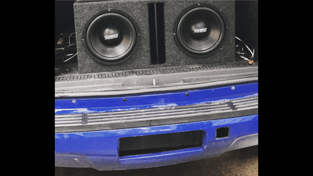

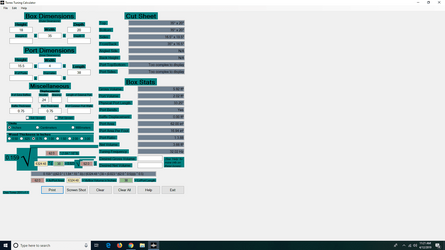

Hello, im trying to build my first real tuned box. Speakers are Sundown LCS. They recommend 1.75ft^3 per sub and tuned to 32hz. Speaker displacement is .12. I have been reading for days learning as much as i can. Im wanting to build an enclosure that has the port in the center with the L on each side (also 45 the corners in the back). Speakers are rated for 300w RMS, but i will most likely run 800w RMS @ 1ohm. I have used the box building calculator some - i haven't tried winISD yet. Here is what ive came up with so far - am i heading in the right direction?

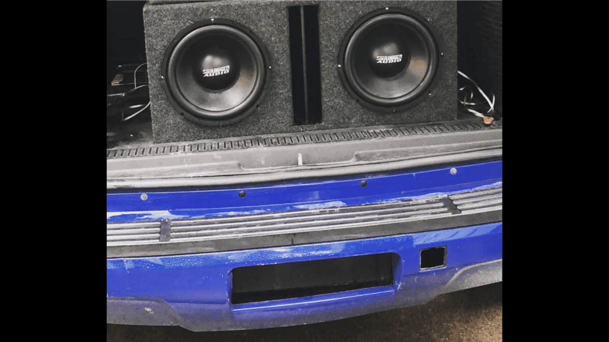

Also here is what im going for look wise (without the center brace)

I had two lcs 12s in a ported box. It was a prefab that was 1.75c per woofer and it sucked... they needed a wayyy bigger box forsure. Space makes bass yooo
