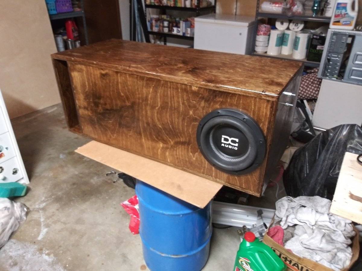

Enlighten me, specifically speaking t-line boxes when would one want to mount inverted vs regular mount? if your a little tight on room and need the air space? Im having a t-line built by a guy for a e12v3 to play around with and he stating to mount inverted. I have no problem with that just wanted a little more feedback/input @shredder2 @THATpurpleKUSH
Just like reg ported enclosures, gives the box a tad more internal volume w/o the sub being in it. But...that's the choice of the designer. Imo, I don't care to have that option. Mine is def not inverted. View attachment 4472
