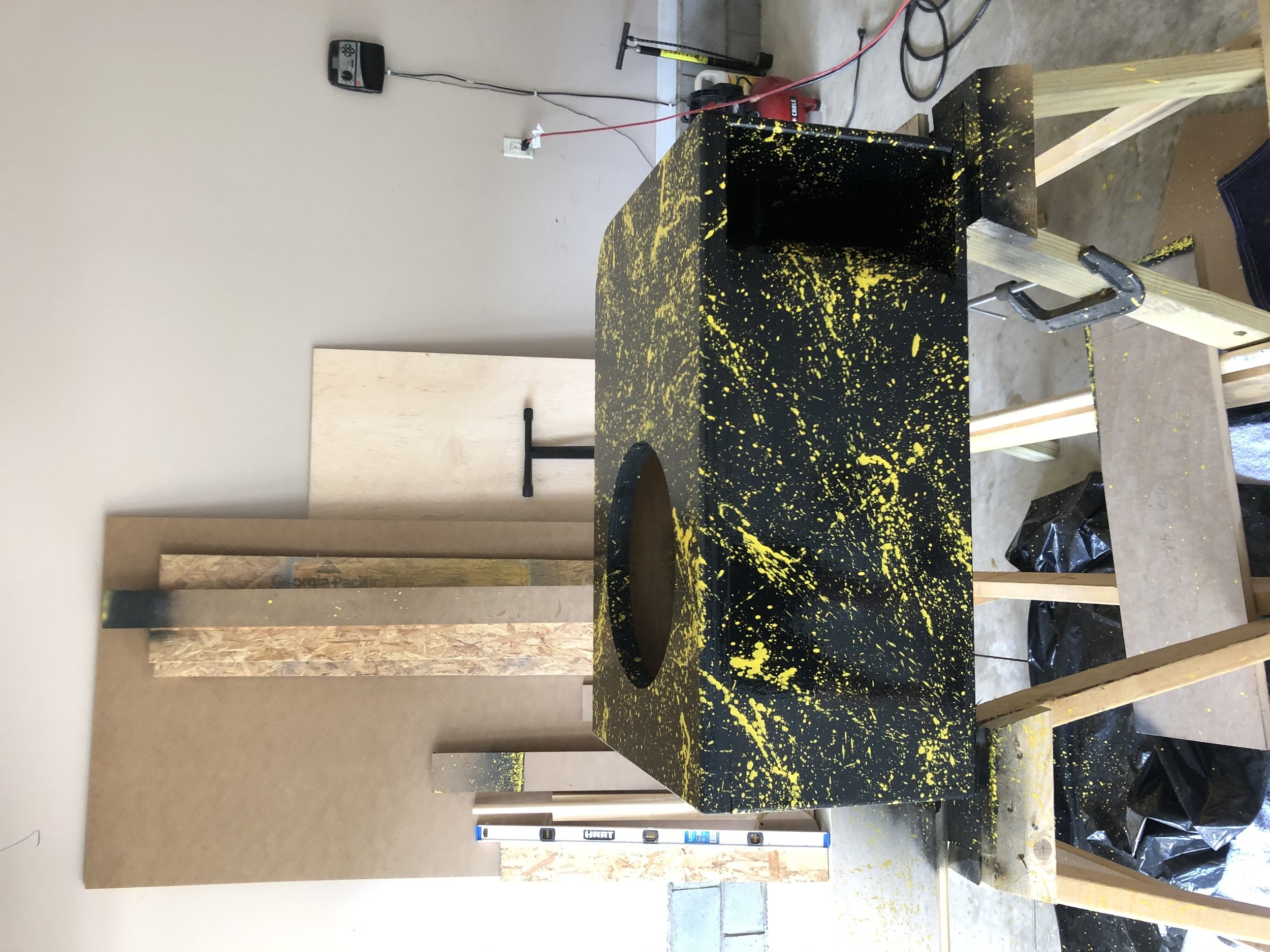

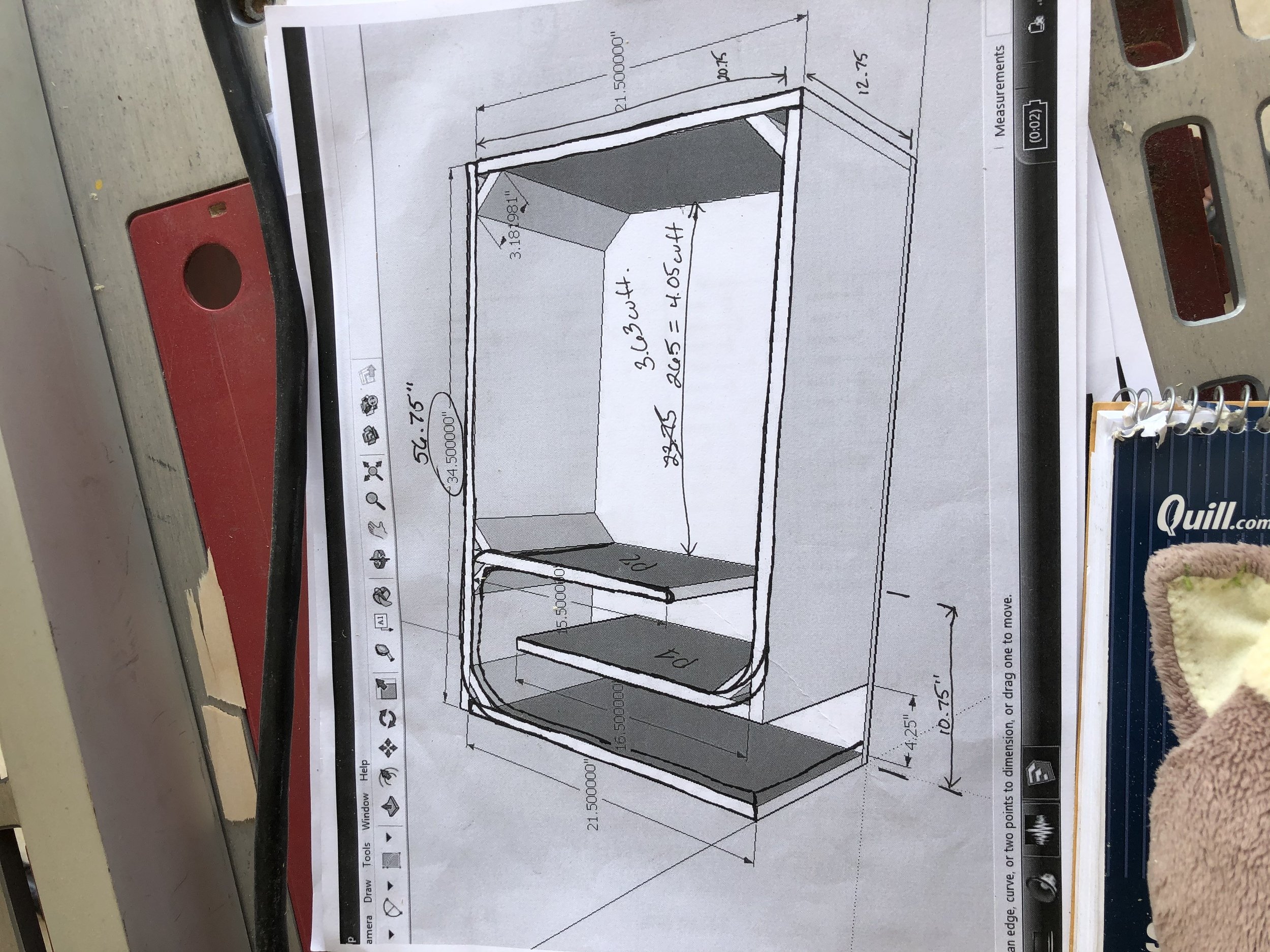

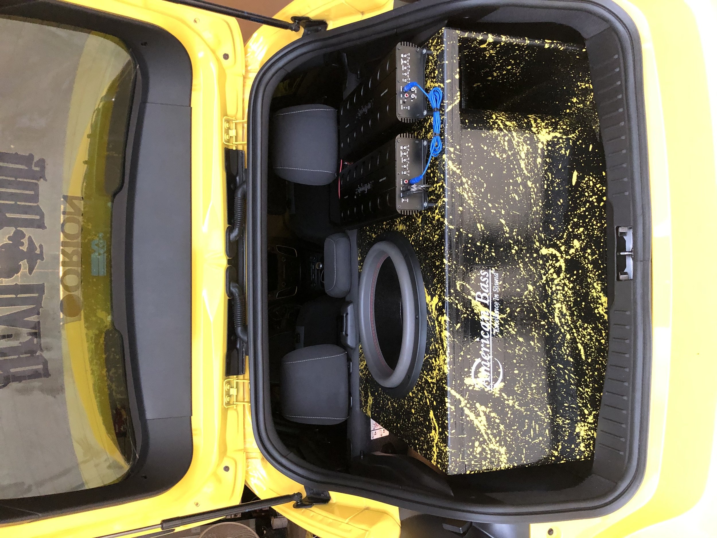

My dimensions never changed. I screwed up the orientation of the 45's. The outside dimensions of the box and the port are just like your drawing. And, I appreciate all the help you gave me. It is 32 hz. like you designed.
