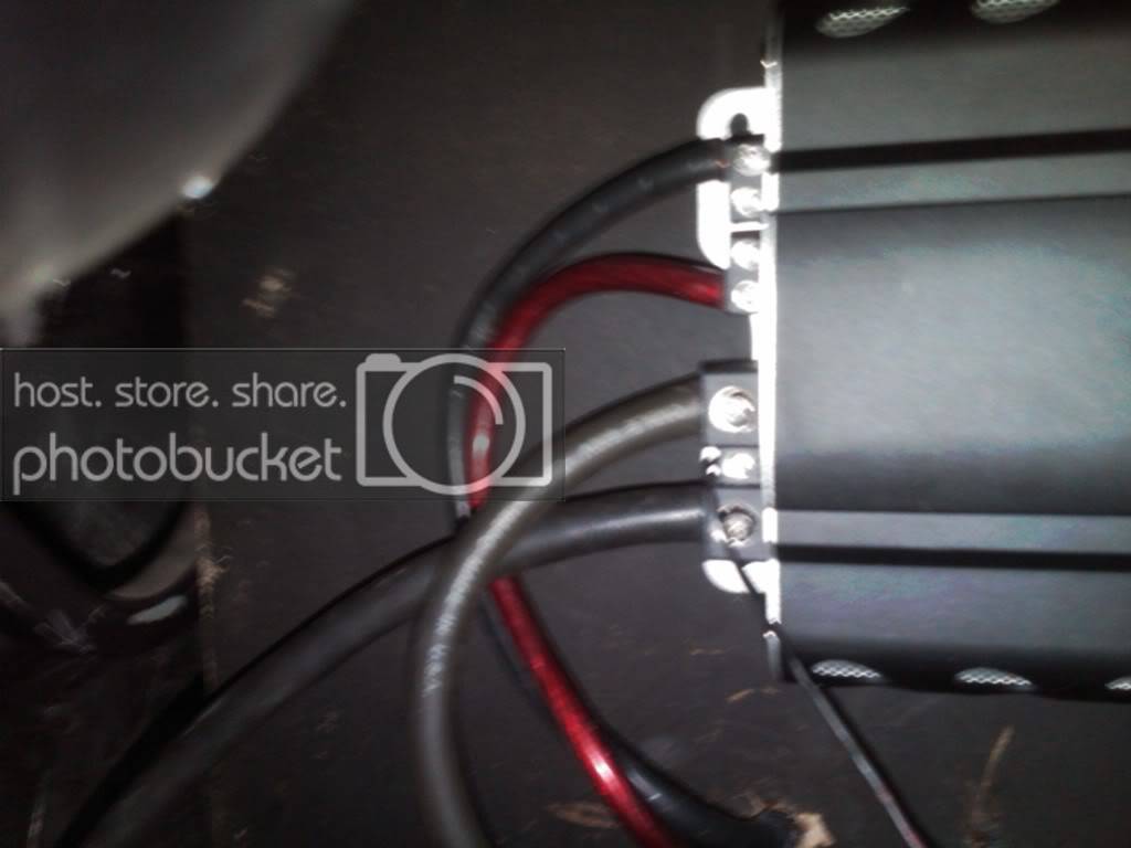

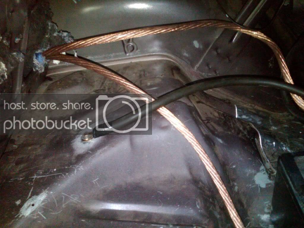

Wire: 2 runs of 2AWG(more like 1/0), and 1/0 welding wire to amp, audiopipe blue RCAs

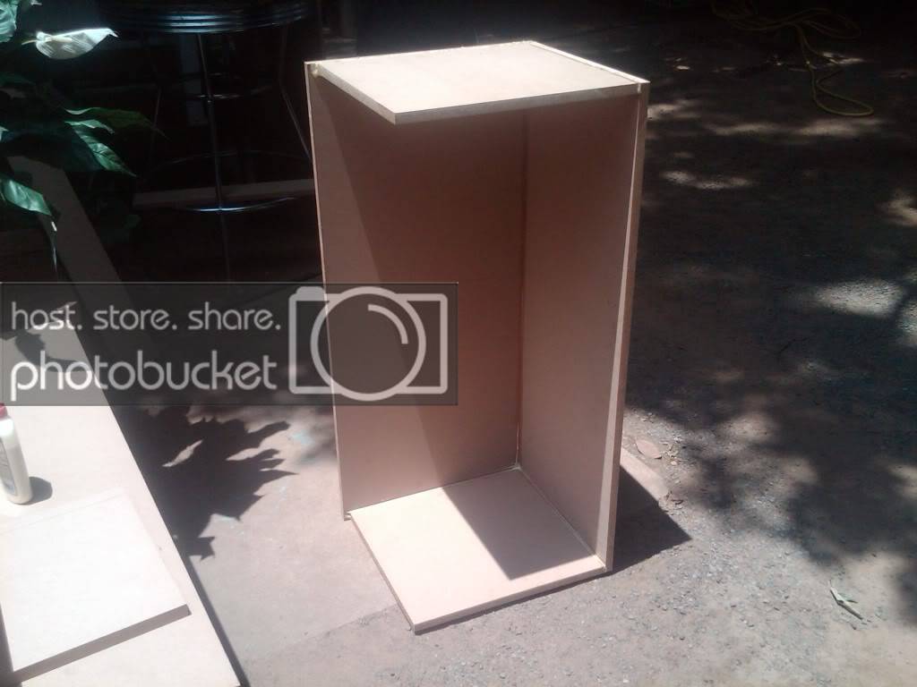

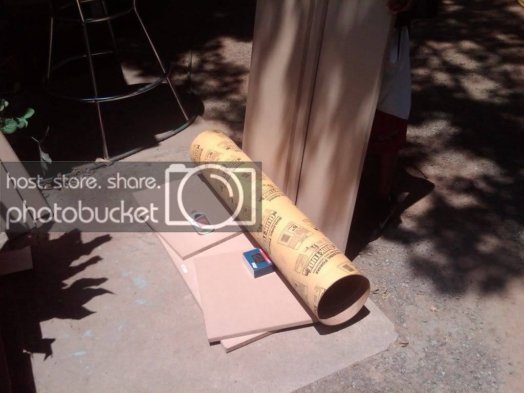

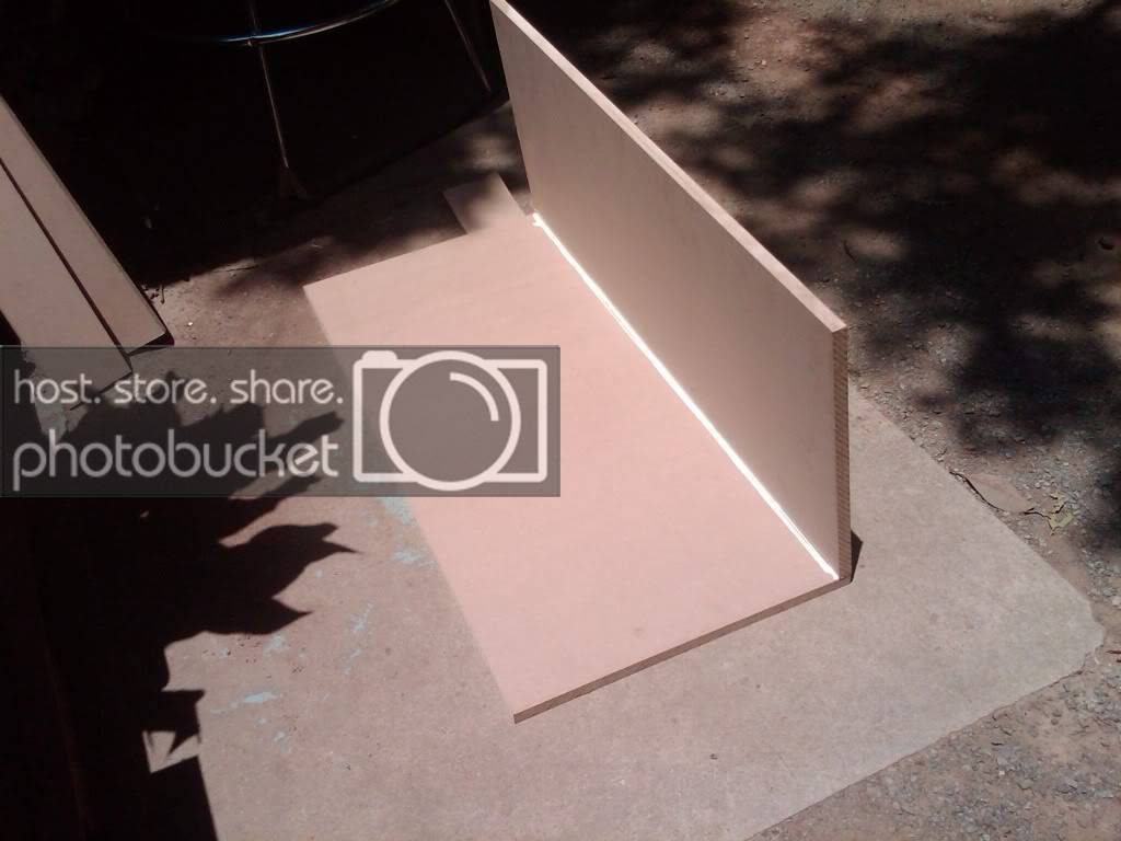

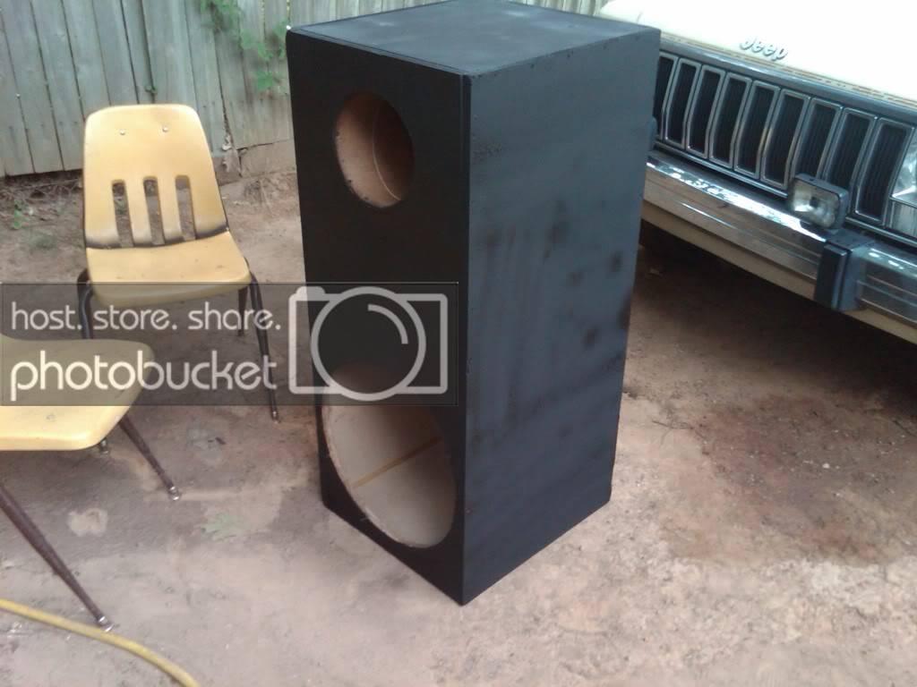

Box material 3/4 MDF and 8 inch Quickrete quick tube(8.5 inch dia) cut to 14 inches for around 31hz after displacement
my cousin is a fool

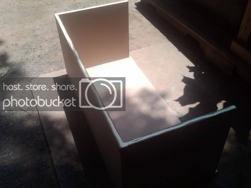

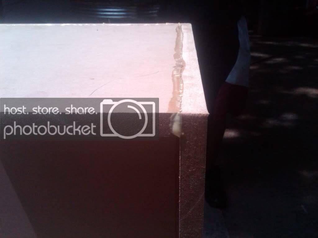

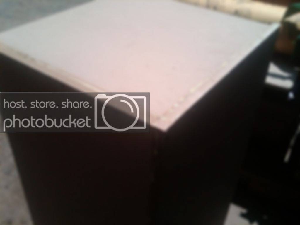

1st glue joint

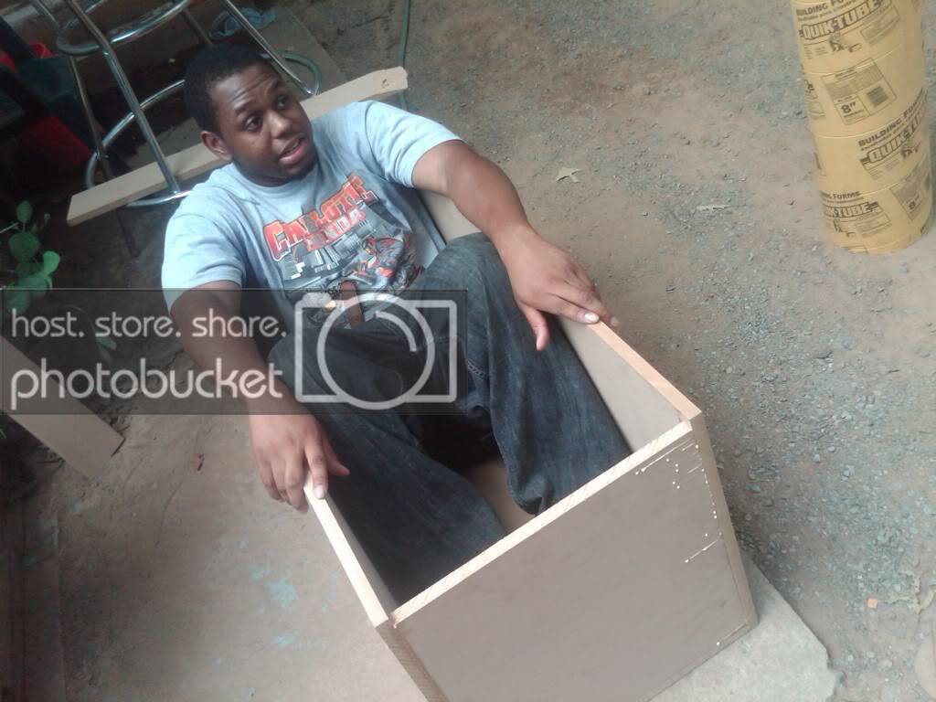

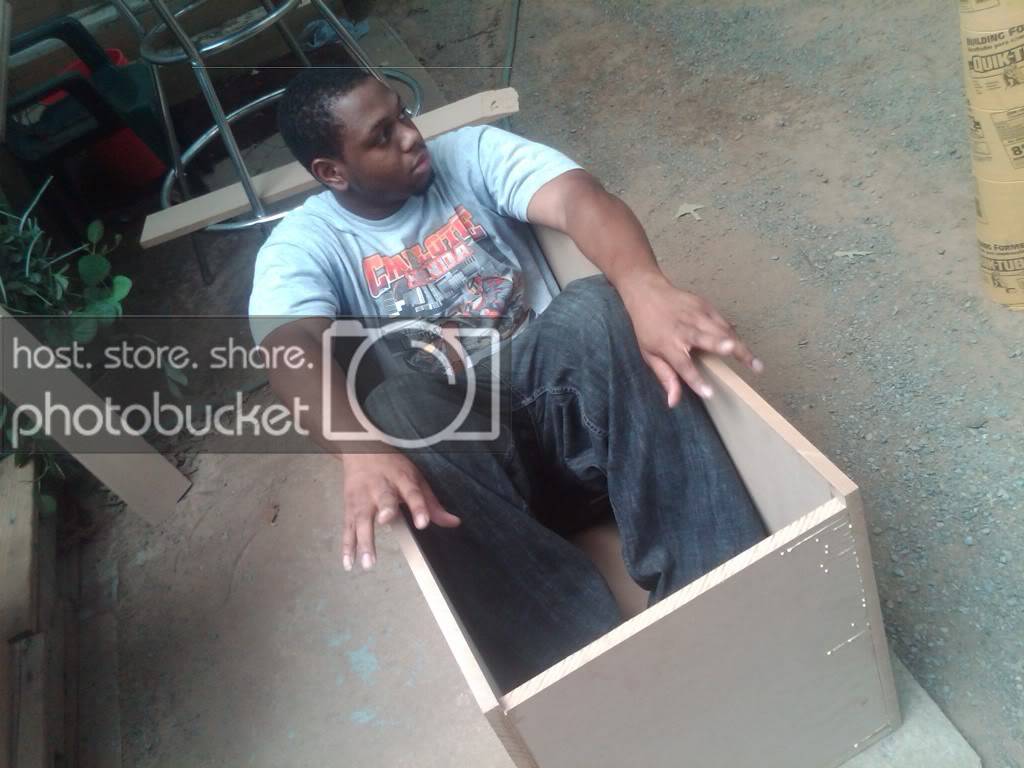

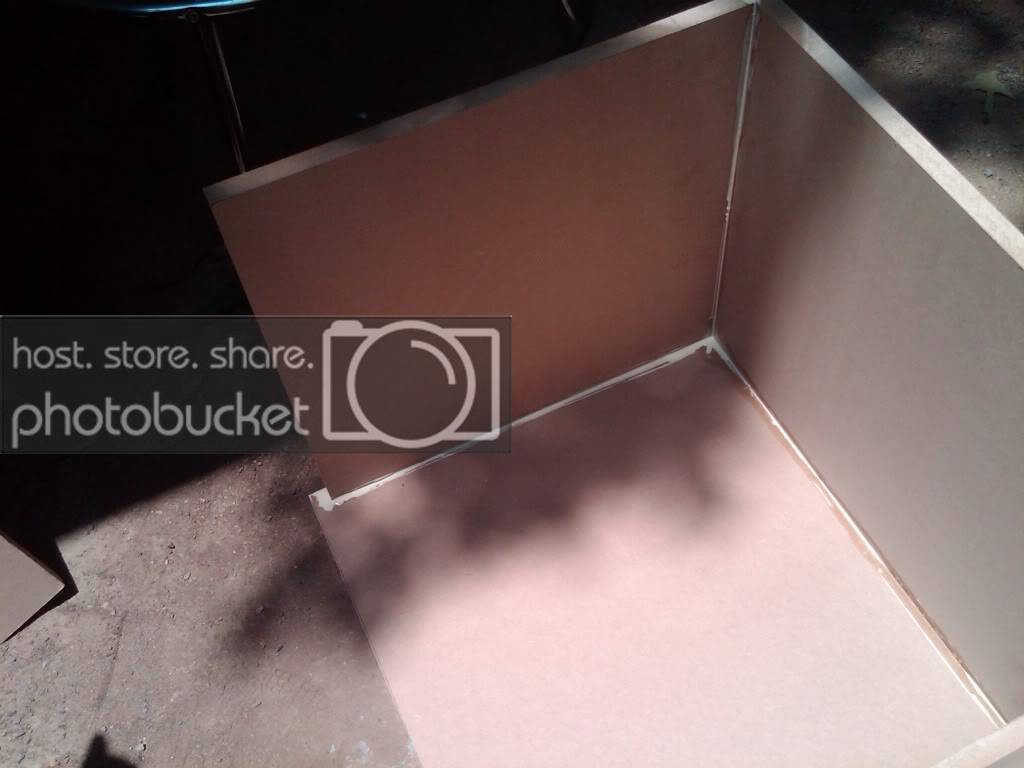

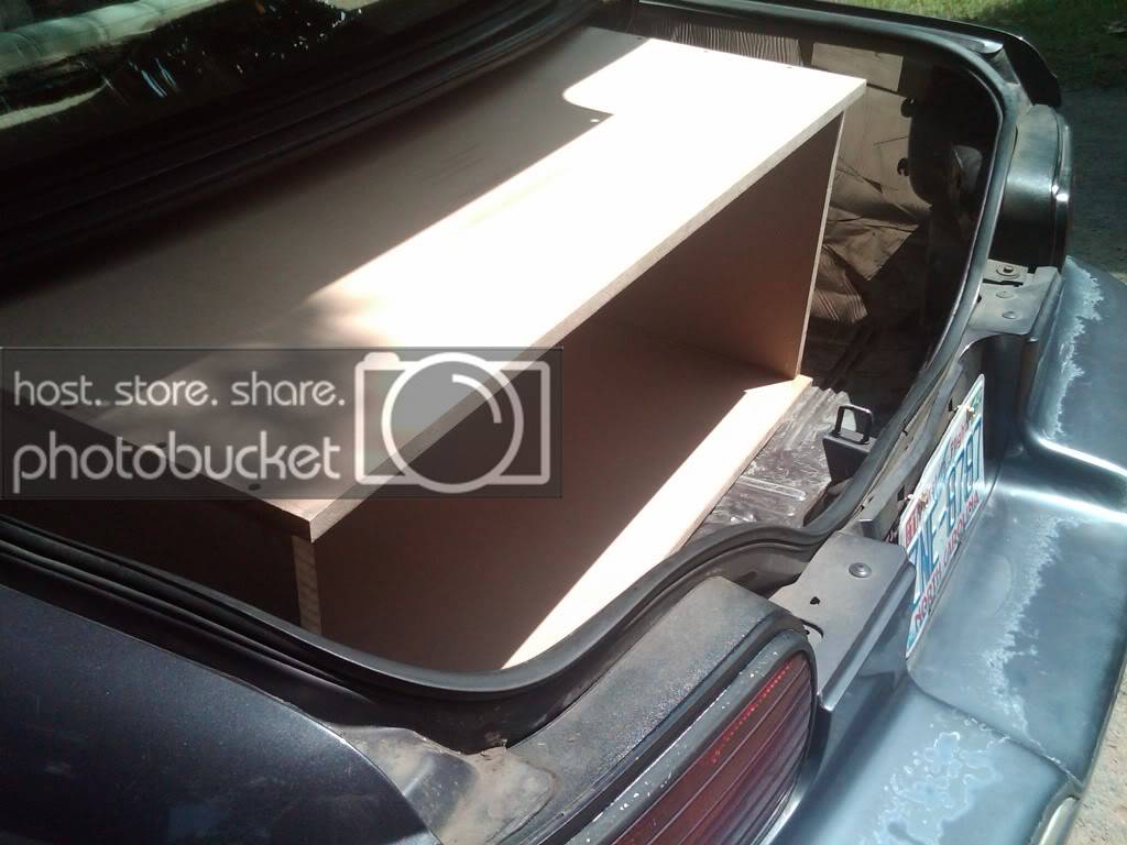

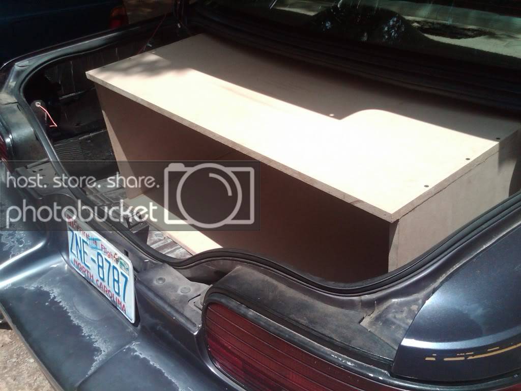

box is 19x20x44
sub packing pretty **** big

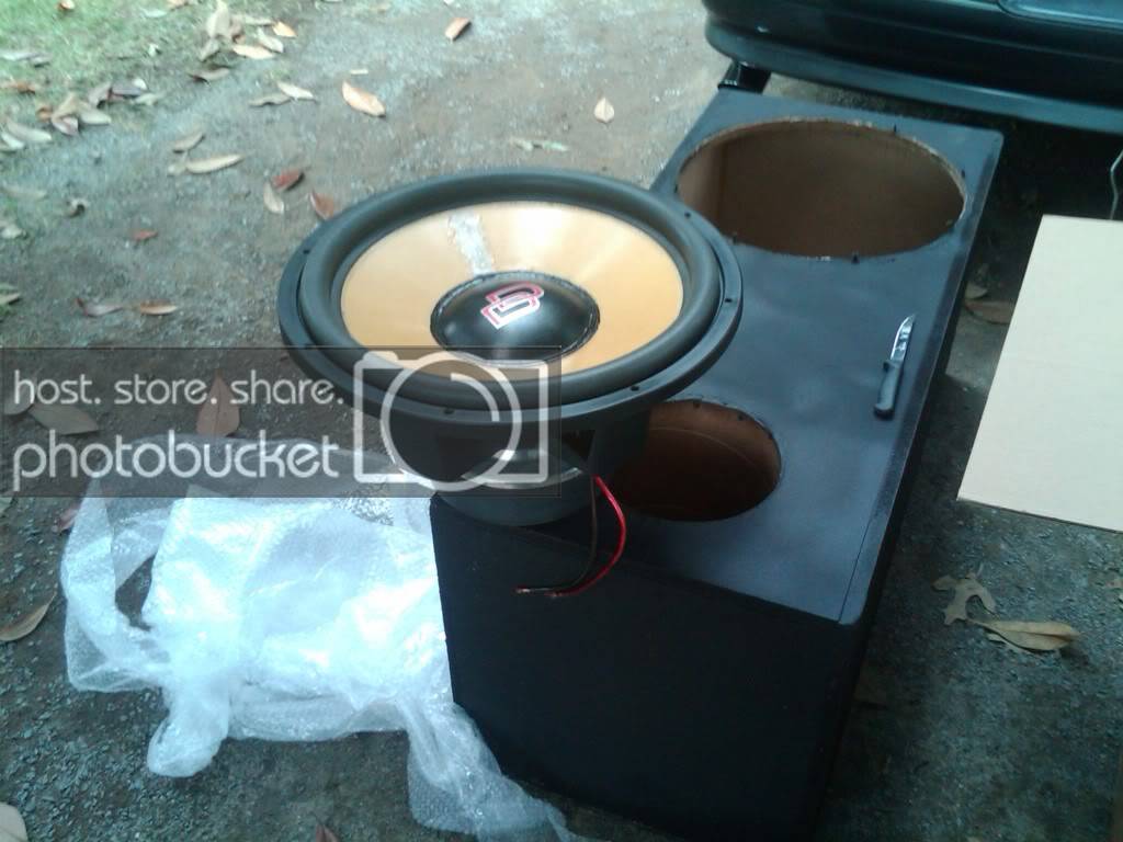

the sub....remember the patch is gone now

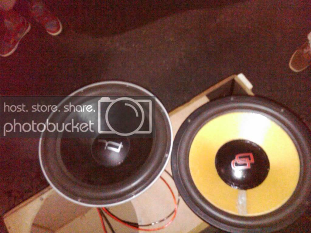

my old sub and box next to my new sub
old subs new car, new subs new car
how it looked b4 patch was removed

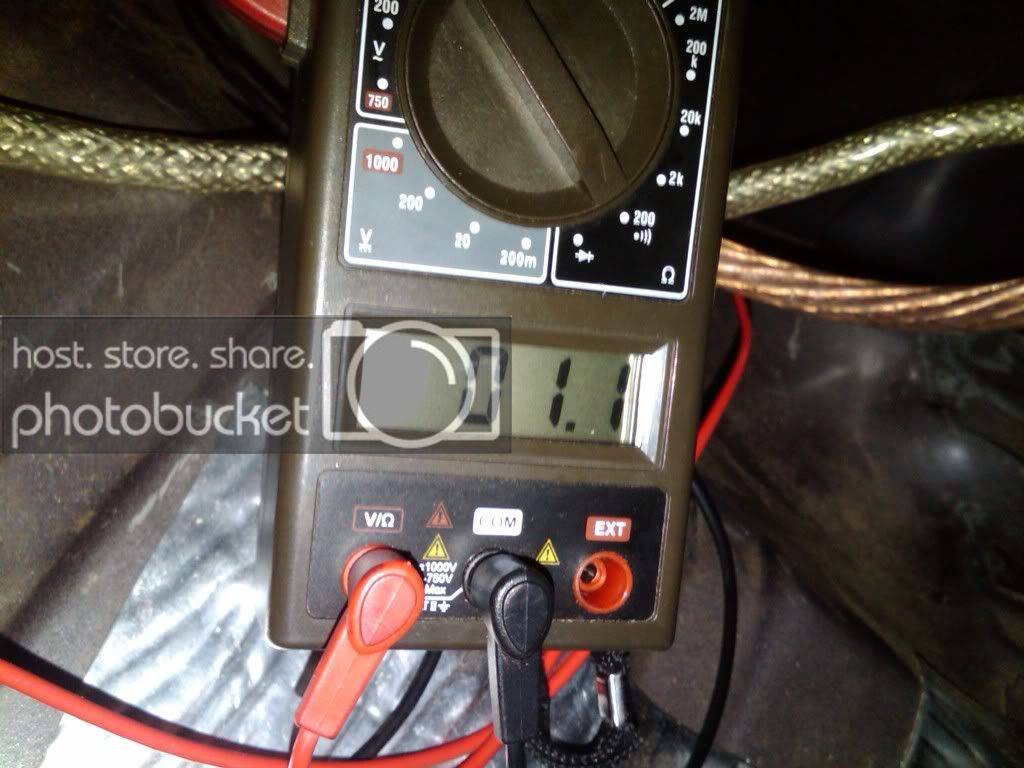

i thought the speaker was dual 2 so i tried to wire it to 1 ohm but turned out my DMM had resistance in it about .9 ohms....so i had a 2 ohm amp(memphis) at .5 ohm WOWZERS!!!

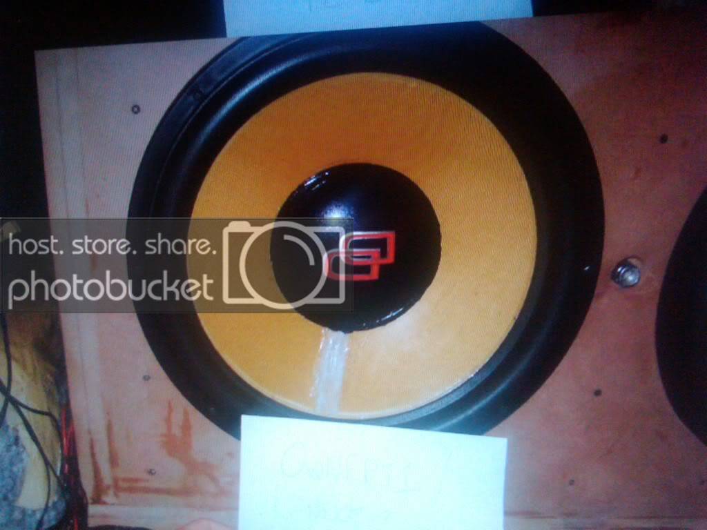

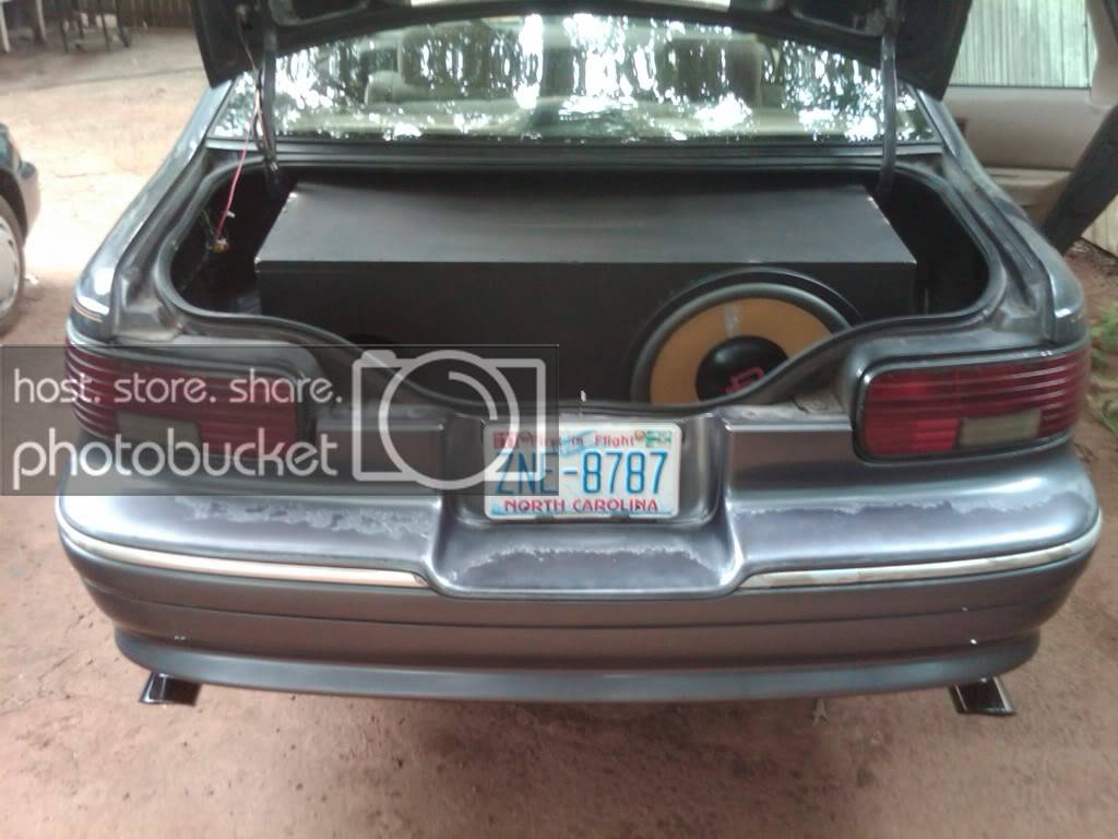

how the sub looks now.....like that 4gauge coming from the sub??
kinda burnt the cone taking the patch off. but i might be painting the cone black anyways so it will cover that right up

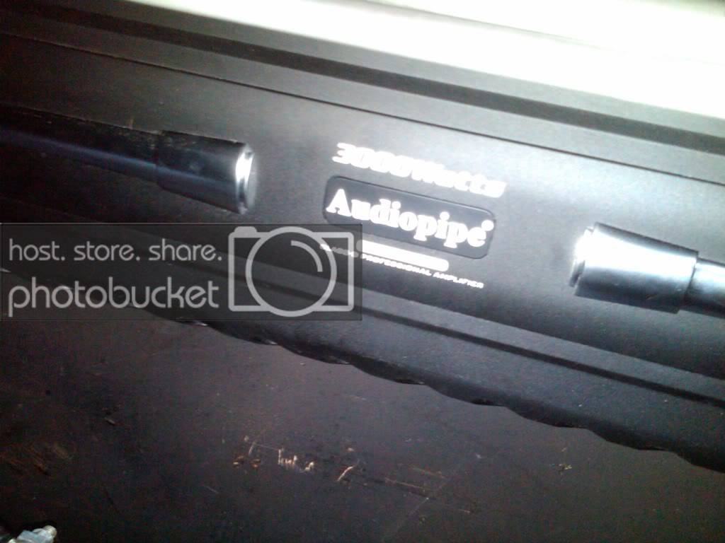

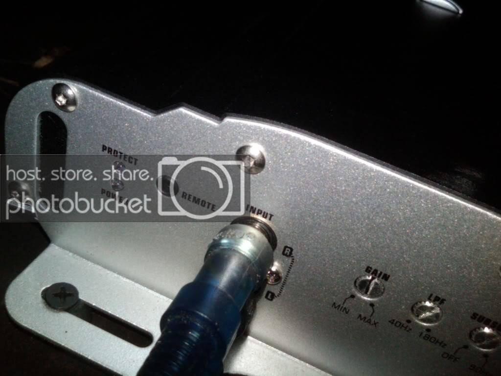

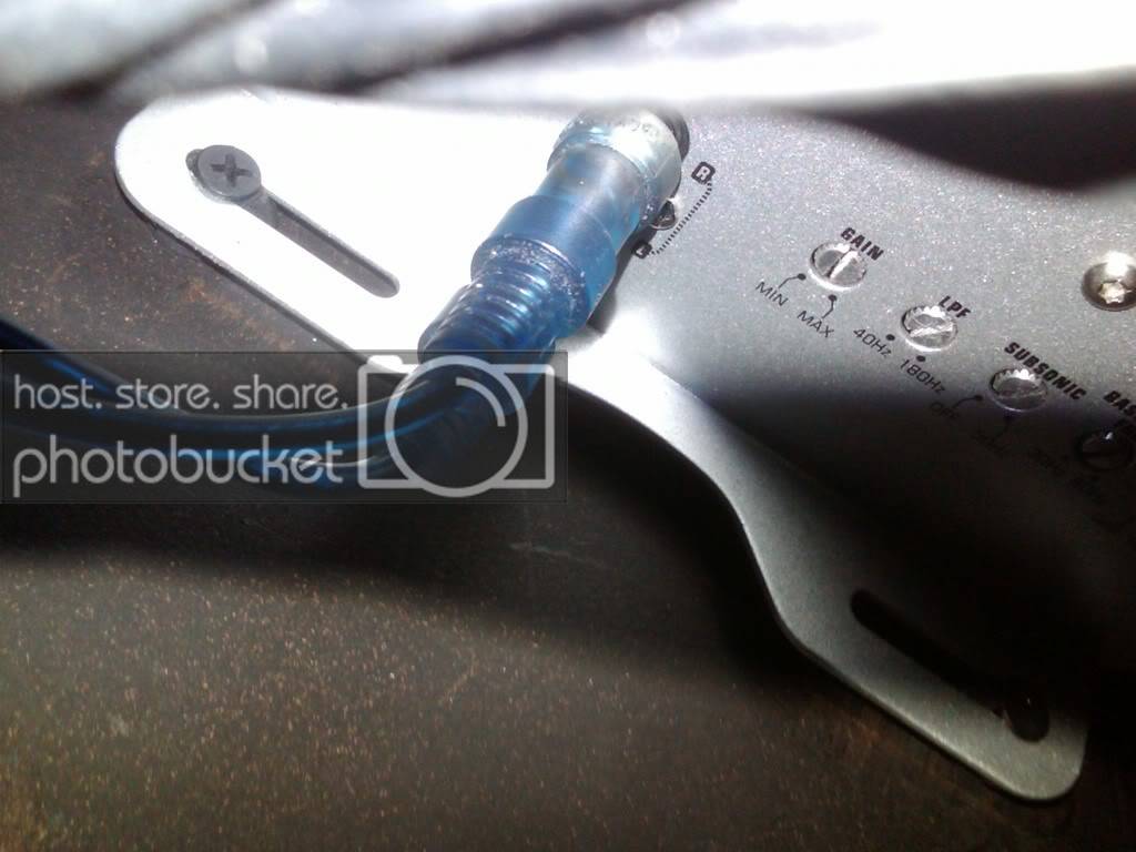

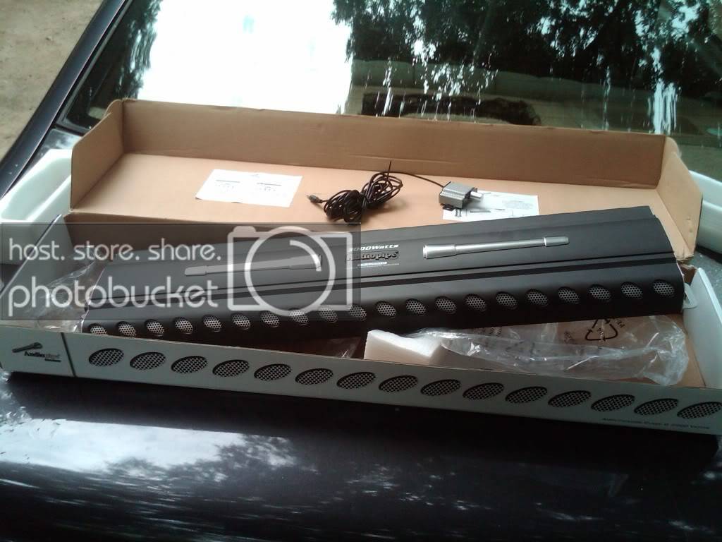

the AP3000d arrived!!(bought from HHR Ed) on SMD will not be using the bass knob

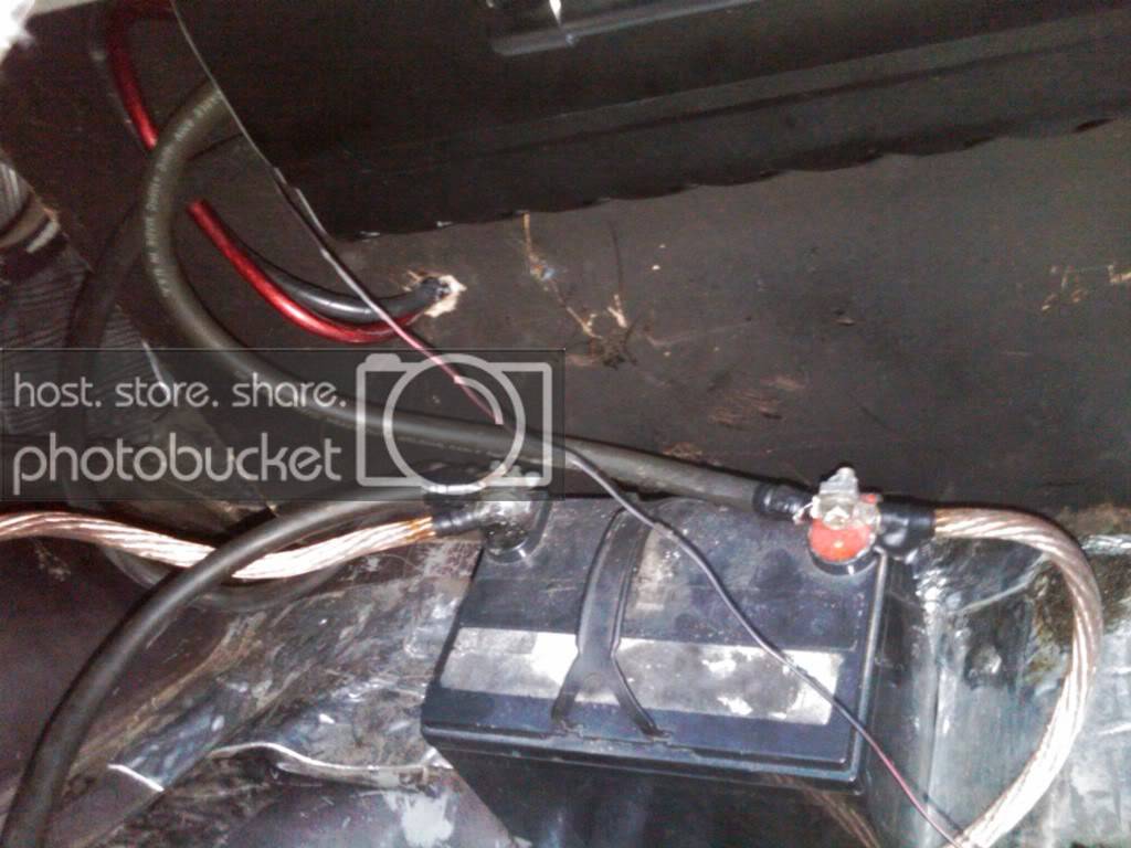

DONT TALK S*IT i needed some bass so i threw a lil 35 Ah in the trunk till i got one of my C&Ds
