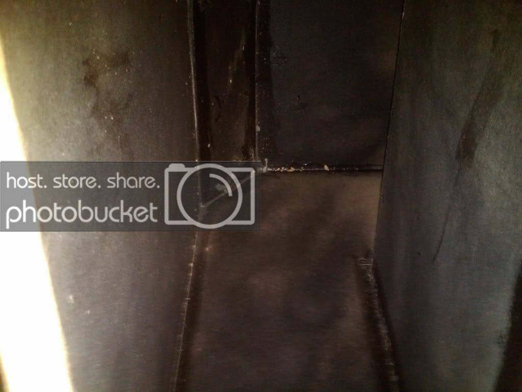

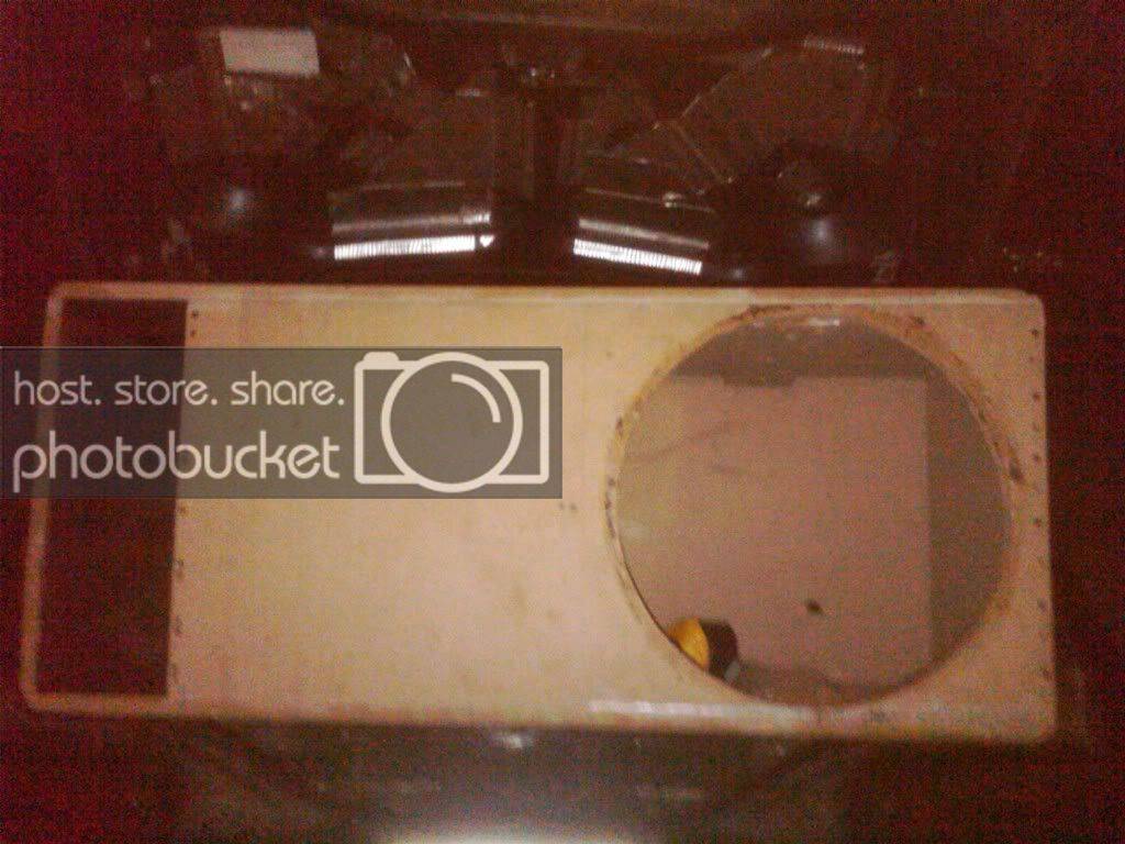

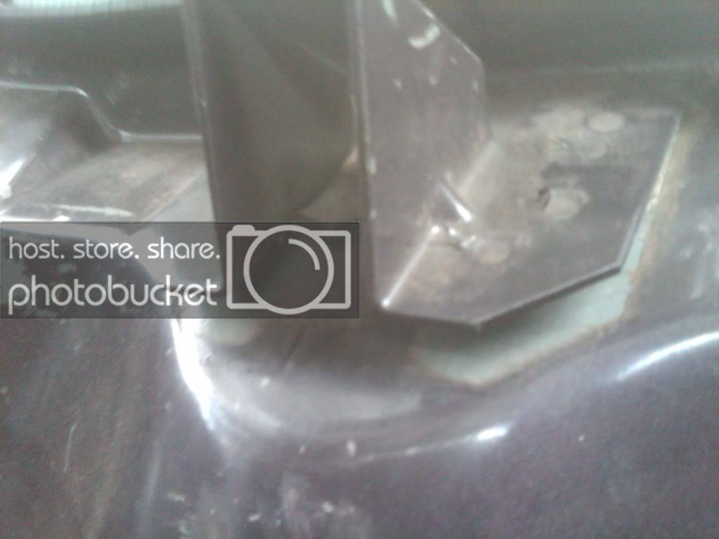

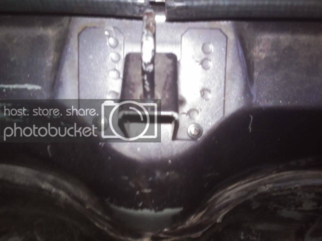

box was giving me problems so i built another one. like my last one its 45 inches wide, 19 tall, 20 deep, ported at 33hz but this time i finished painting the inside of the port and did a 45 inthe port corner. cutting the 45 was wat cut my finger. also found out another reason y it wasnt as loud....my trunk latch was broken at the spot welds and cracked the metal so it was up about 2 inches from closing letting tons of air out the back and around the trunk.
pics of damage

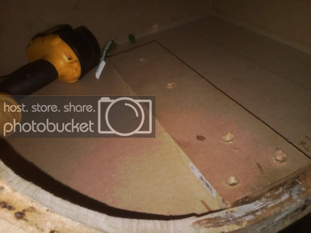

i put 2 self tapping scres on the side of it to hold it down

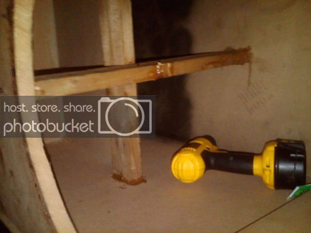

45 in the corner
not really sure why i did that

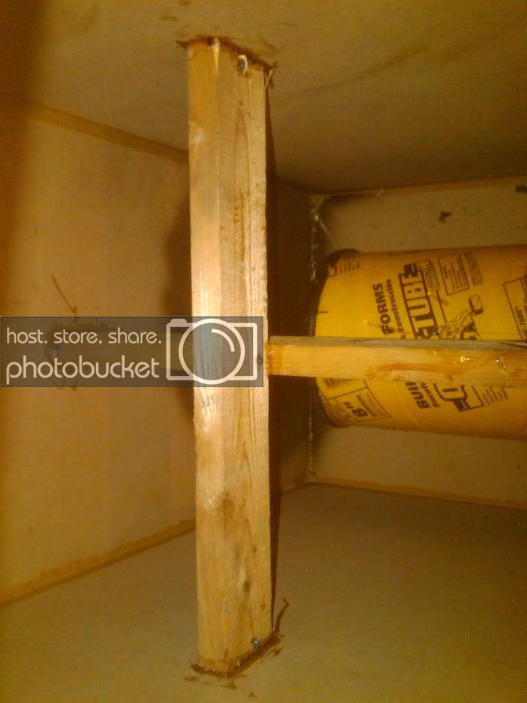

also it was a lil flexy so i braced the inside and again 3 inch screws through all sides

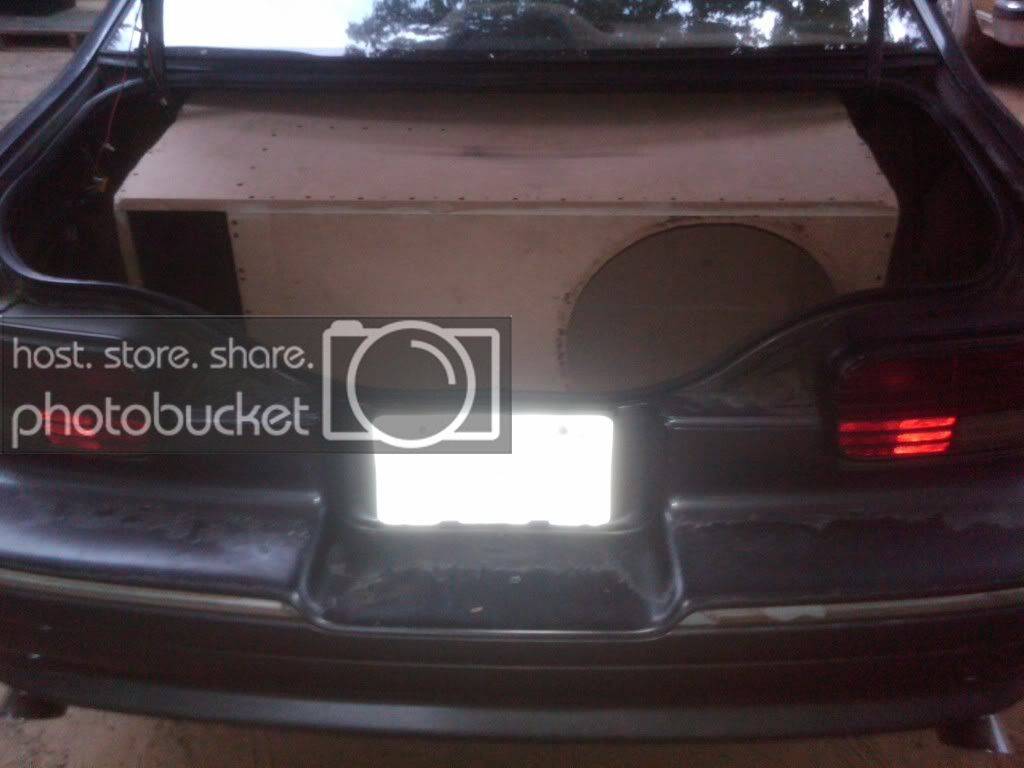

how its sitting now
i also put 2 small blocks of wood to hold the box from moving and its working great.

i just didnt want the thing to fly apart. and by the port all but one screw wobbled loose making the box thats y its 2 sets on it i countersunk those so more meat of the screw was though it
