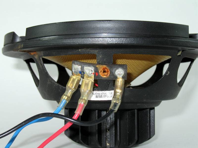

Not much response to this, I take it. Anyway, I planned to run some wires this weekend and try out some points (2000, 2500, etc.) at 24db slopes. Before I could try it out I decided to pull the speakers and I'm glad I did. Here's what I found:

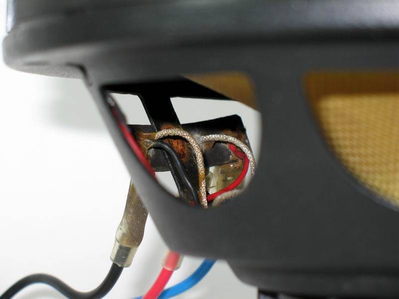

The top shows the rear terminals of which there are only three. The inside shows that one of the terminals connects to two wires inside. I'm really not sure where to go from here as I don't think that these can be run actively - can they?
Over at DIYMA I was told that the tweeter and woofer share a ground. I popped open the tiny little passive crossover and confirmed that. Does this mean I should run both negatives to the single ground if I'm going to be running active?
Ok, I'm a little confused. The ground wire from the speaker tab should run to the deck's ground? I am also powering these from the deck itself using the onboard amp, if that makes a difference. My wiring scheme was to look like this (on the left side as an example)
