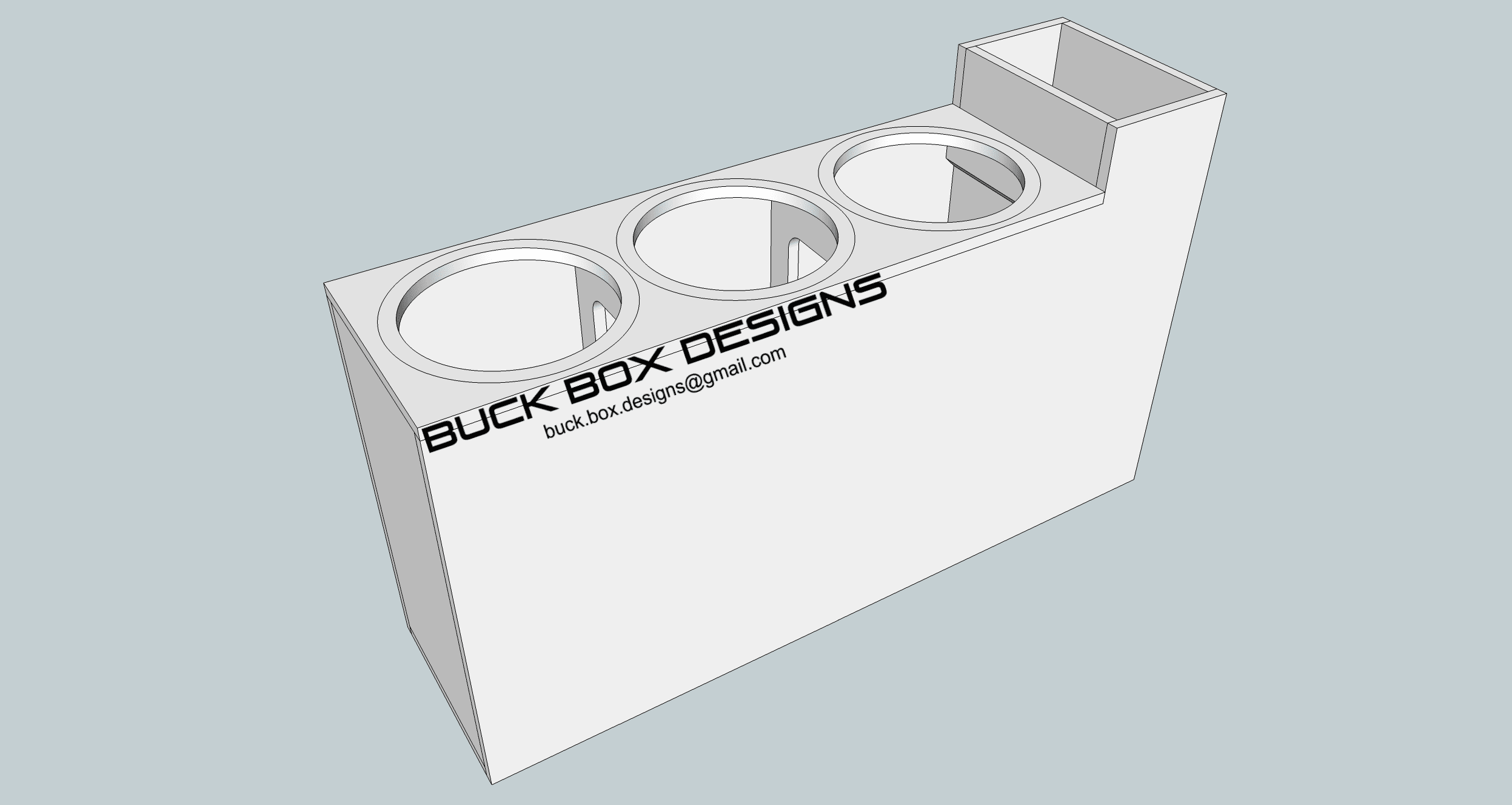

I did 3 12's box for Skar, 3 of the ZVX 12's. It was super loud, but I literally had to correct Skar's own t/s parameters because they seemed to take the t/s without ANY woofer break in time, and whoever put those t/s up either was lazy or they didn't seem to know what they were doing. They'll get loud, but I've seen a lot of issues with Skar too. Like this box was super flexing his little extended cab small truck, but Skar does stuff that's really questionable, as far as quality goes.
