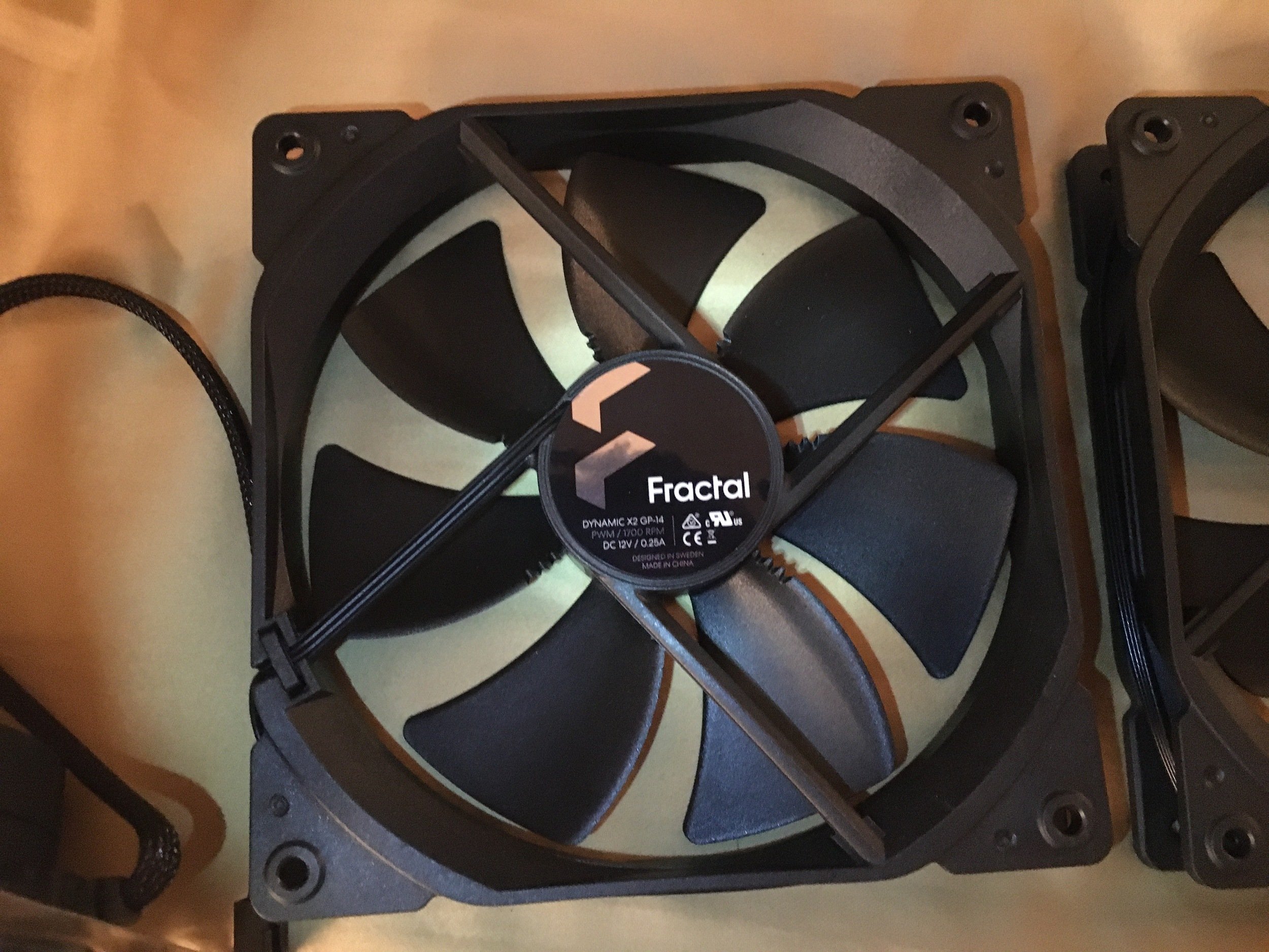

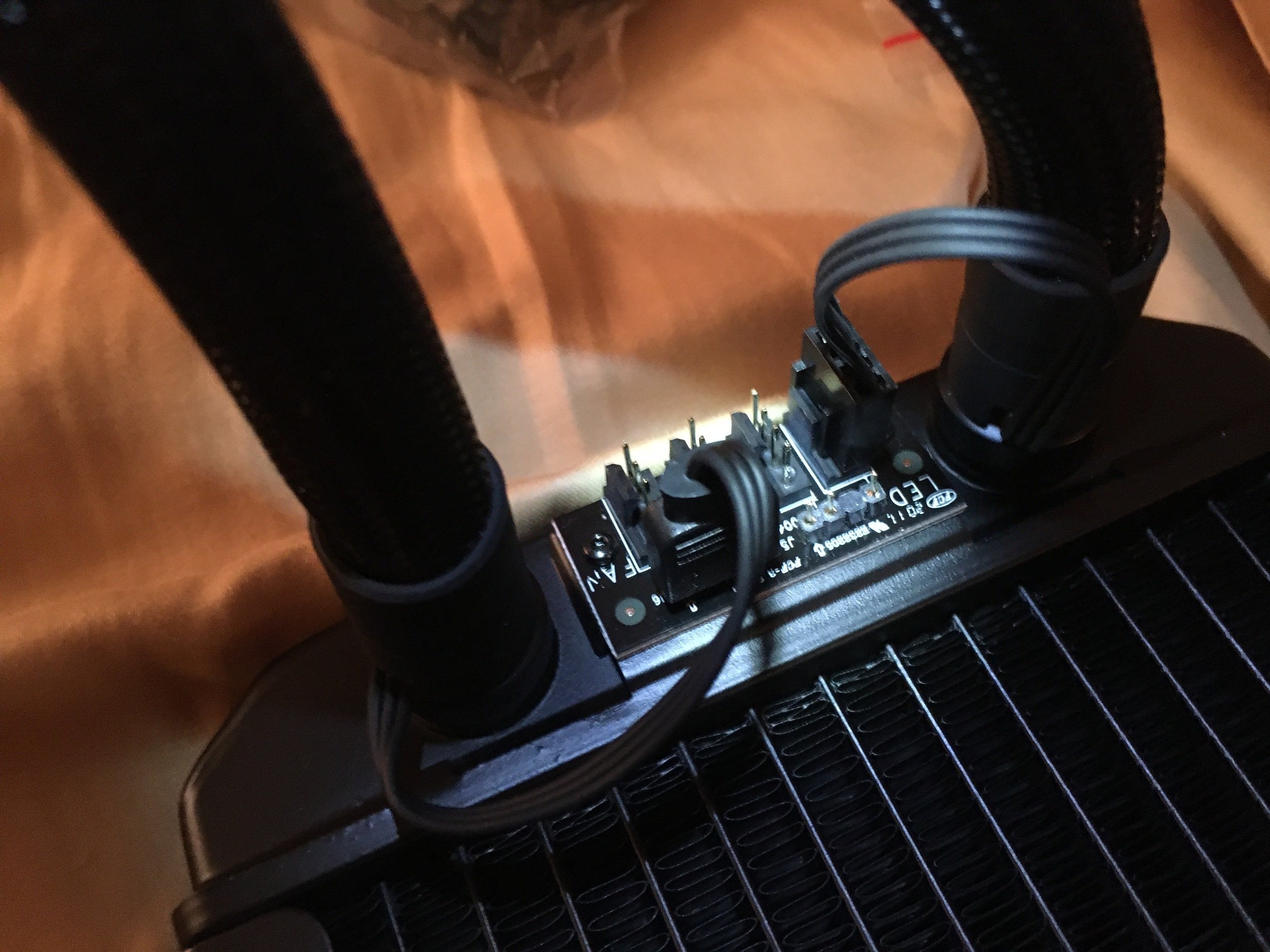

CPU cooler: Fractal Designs Celsius+ S28 Dynamic-> works like a car radiator. Water pump, 2 140 mm fans and a radiator.
