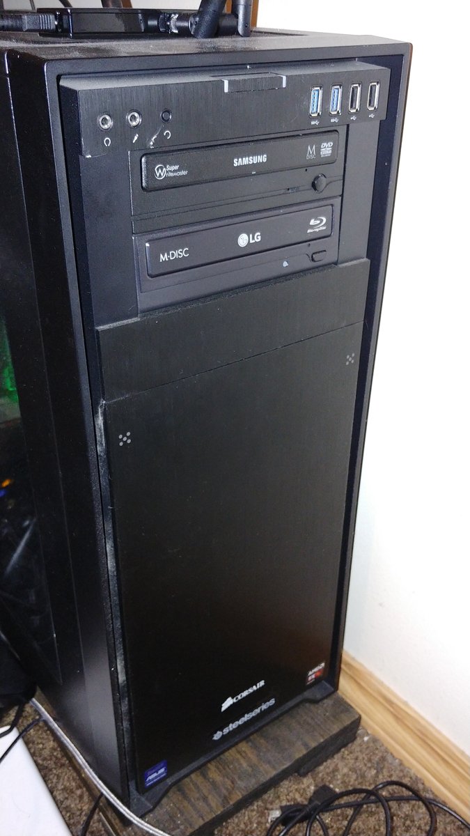

It's not hard to keep these cases cool... it's huge. So cool in fact I am not running liquid cooling on my CPU, it stays cool with air cooling. 2 - 140mm intake fans on the front, 2 - 140mm intake on the top, 1 - 140mm exhaust at the rear... it's all positive pressure. The Power supply brings air in from the bottom but shoots the heat out the back. Corsair AX 860 80+ Ti Certified. How are you liking your case?
