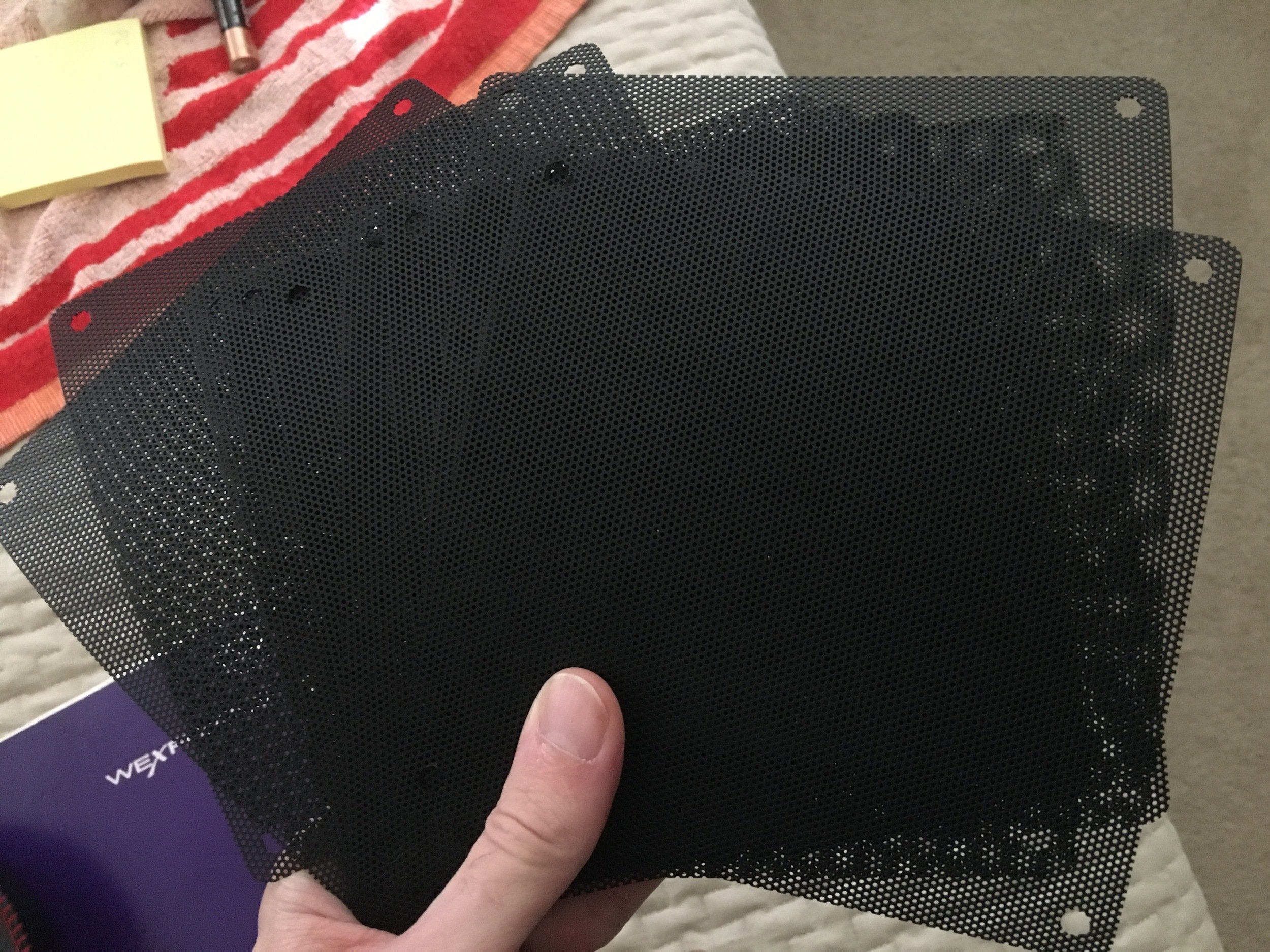

My case came with 2x 3-stack 3.5 hard drive cases where those bottom fans are, no filters. I modified that part, only supposed to be 2 120's down there anyways. But I did the 2 140's and drilled the holes out, so that's what I'm putting the filters on.

Yeah I have a filter there, that's not what I mean. I know it's ugly lol. Not done, just had to tape it with what I had atm, because the bottom isn't flat, there's ridges, so the sides weren't sealed. This is on the bottom.
The filters are screwed into the bottom, I didn't want to have to remove the fans everytime I cleaned the filters.

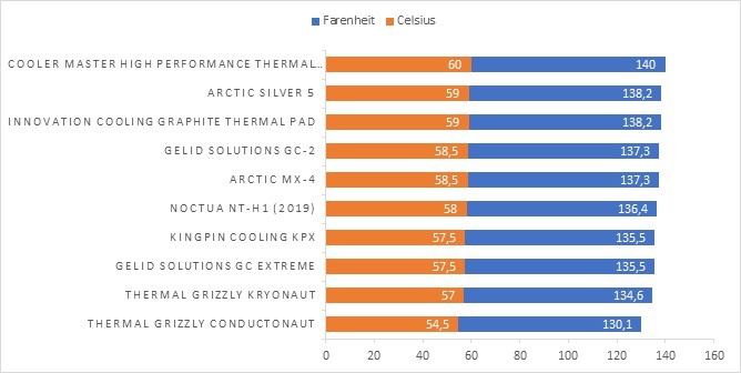

Honestly brand doesn't matter much as long as you avoid IC diamond.

5.5 degrees total difference between first and last here. Just make sure to get the application right.
