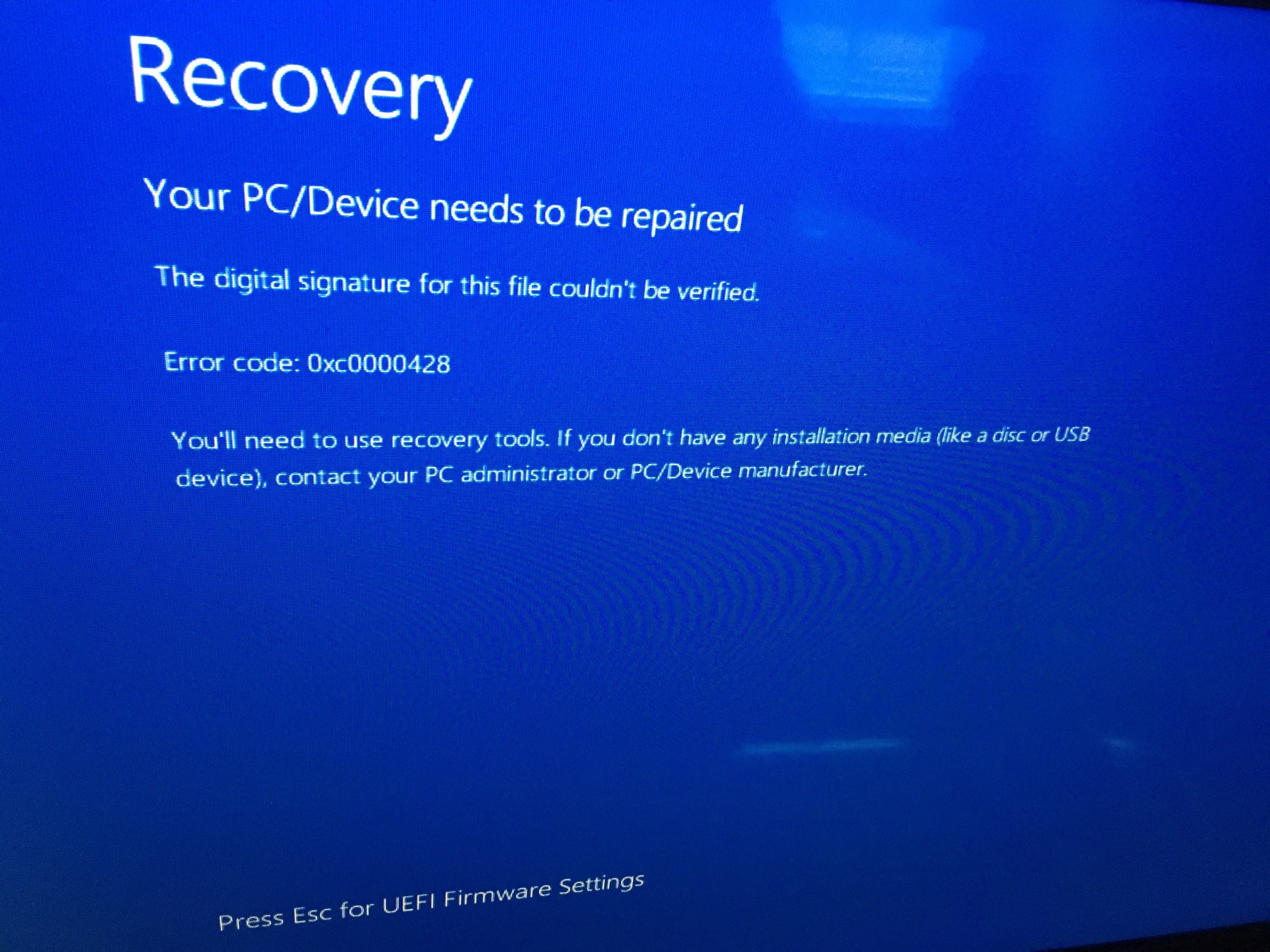

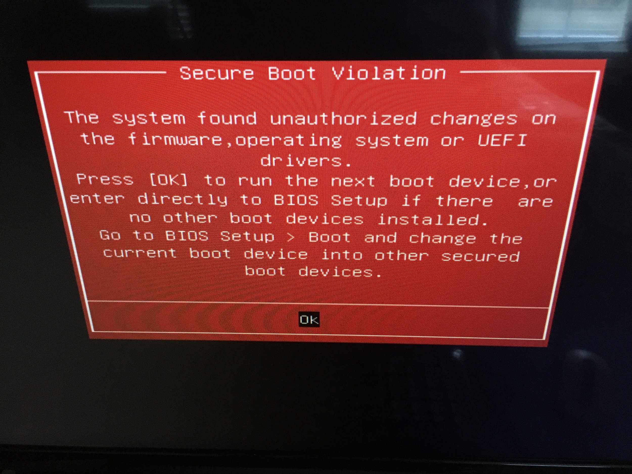

Nobody tells you that if you put your OS USB in a 3.0 slot, then your mouse and keyboard won't work when you try to install your OS. So I couldn't choose any options during the initial countdown, and it started installing everything automatically. Here's maybe the mistake: I turned the PC off because I didn't know the USB port 2.0/3.0 issue was the issue. I didn't want it to auto-install. So now if I do a secure boot, I get the red screen. If I don't do a secure boot, I get the blue screen, pics below. I've tried quite a lot to get around this so far, nothing has worked. It doesn't make sense to me at all, since it didn't install anything hardly as I turned it off almost immediately. How in the living f*ck was I supposed to know about the issues with the mouse and keyboard not working if I put my OS in a 3.0 slot instead of a 2.0? Can anybody explain that to me? Why the f*ck doesn't the OS work in a 3.0 slot?
25179
25180
How is turning off the PC a violation of a secure code? Nothing was changed. I didn't do anything to the USB. Doesn't make sense to me, and there's no real help on this one for me, I've still got a couple of options to try, but I don't understand how to do them yet.
Big shout out to @Coolhand20th for helping me out for 5-6 hours troubleshooting this OS issue. That USB issue where I couldn't use my mouse or keyboard during my initial setup that I messed up was crazy!!!!!! Took me forever to figure out. I learned some stuff thanks to coolhand, so major props my man!
I still want to know why my OS install would basically freeze my mouse and keyboard when I put in it a USB 3.0 slot. Wtf "COME ON MAN", seriously. You'd think either ASUS or Windows would include some kind of disclaimer about that. Thank goodness my case came with a couple of 2.0 USB ports. I have 13 USB port on my motherboard and not a single one is a 2.0. So thanks, corsair, for putting a couple of 2.0's on the front of my case. Saved my rear end there.
