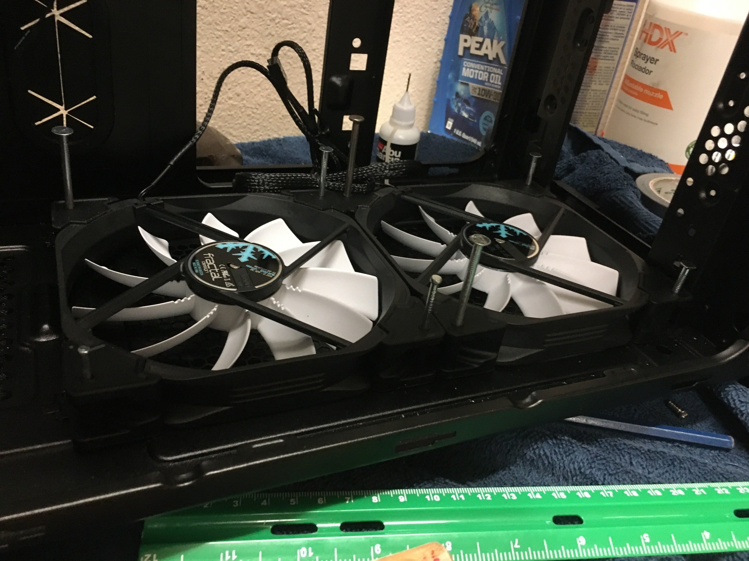

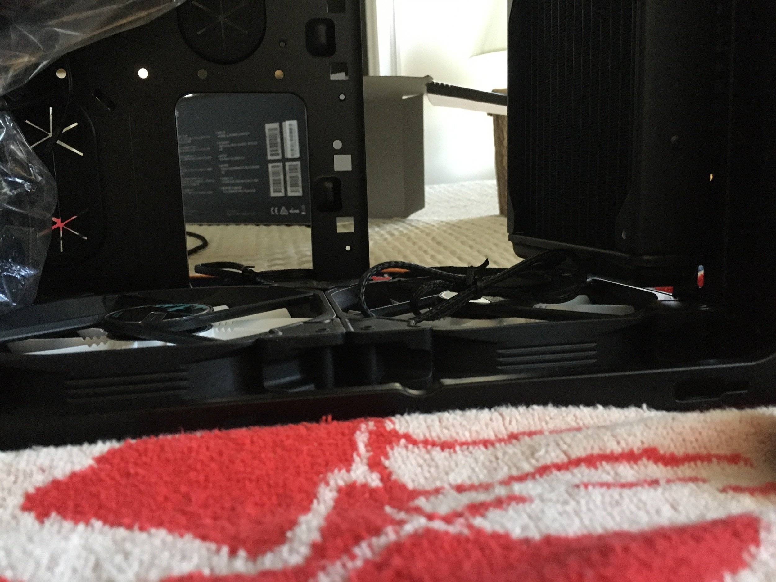

This is why I raised the radiator slightly:
24836
I am referring to the length of the screws more than anything. I poked through a Corair 115i AIO because I forgot a rubber washer.
Talk about a DOH! Moment,lol
But it is easy to do on those, thankfully I have never done that in any build I have done. Last 30-40 builds have all been liquid cooling either from a enclosed system from Corsair or doing a complete custom build for a friend with pipe routing and all that garbage. I personally prefer the enclosed systems they do just fine and last a very long time. I have one set on my dads that has been in 3 towers so far one with a Intel CPU and the last 2 an AMD CPU. It runs probably 16-18 hours a day 365. Can't ask for much more then that from a Corsair H55 Enclosed system!
Also if you want replacement screws or anything I took the ones I had to Fastenal and matched them right up for next to nothing. Bought new washers, screws and a couple other things for a total of 5 bucks & I had around 20 of them leftover as I needed longer ones then the ones that it came with on my last install.
