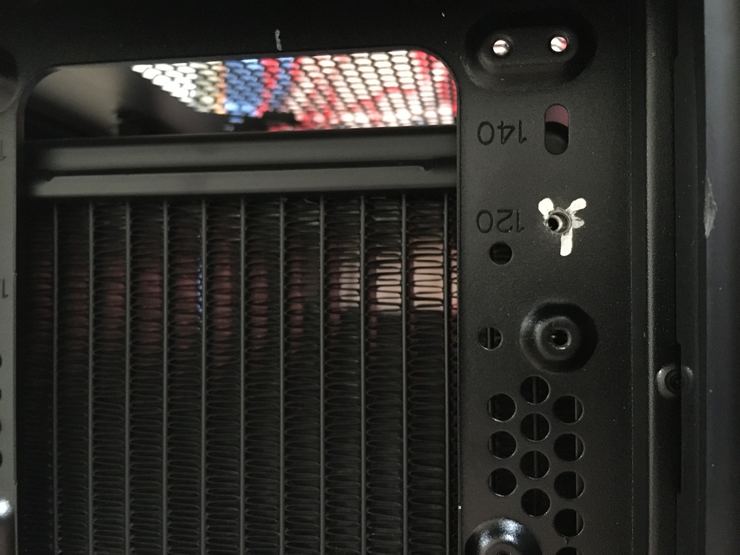

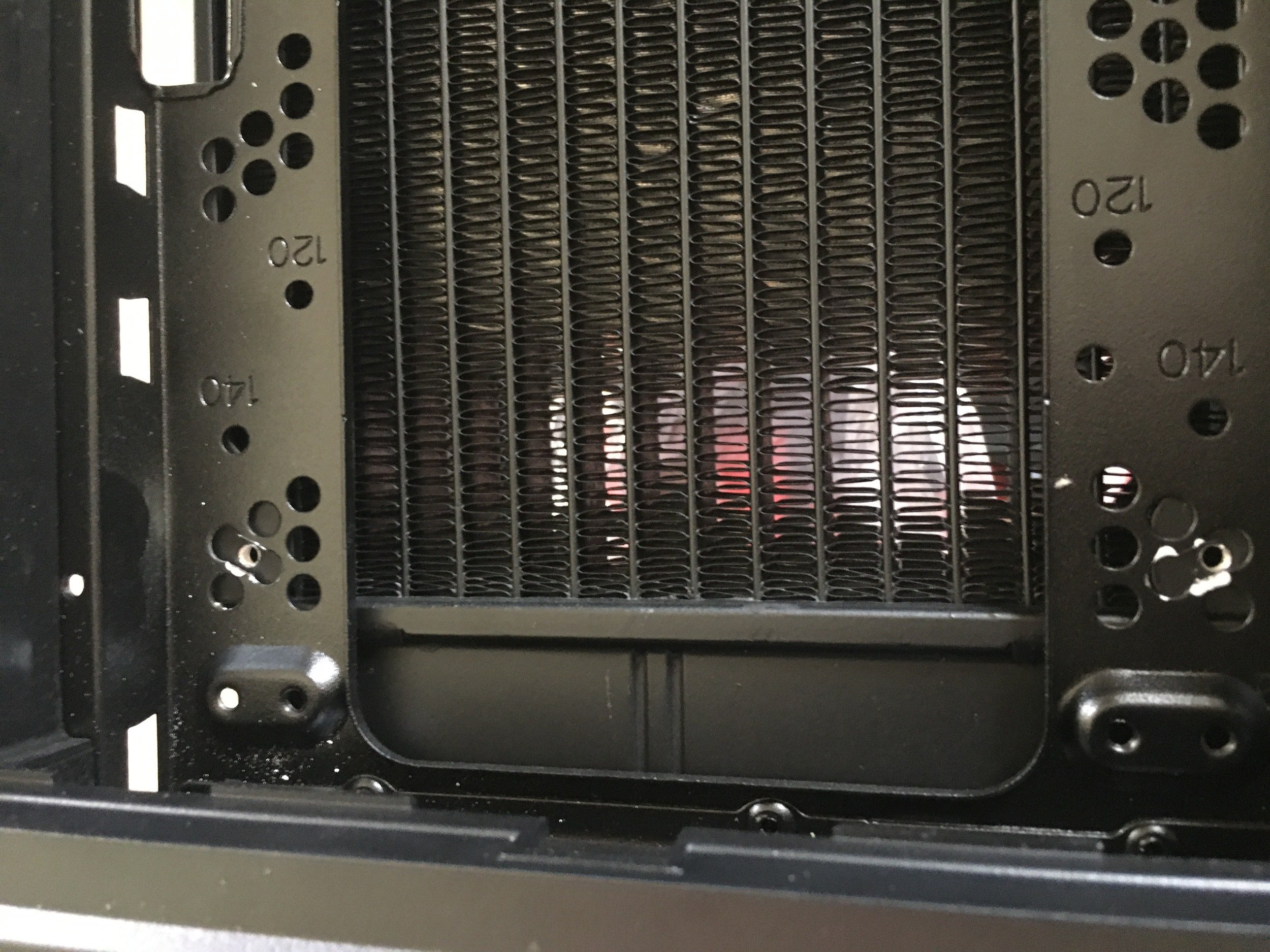

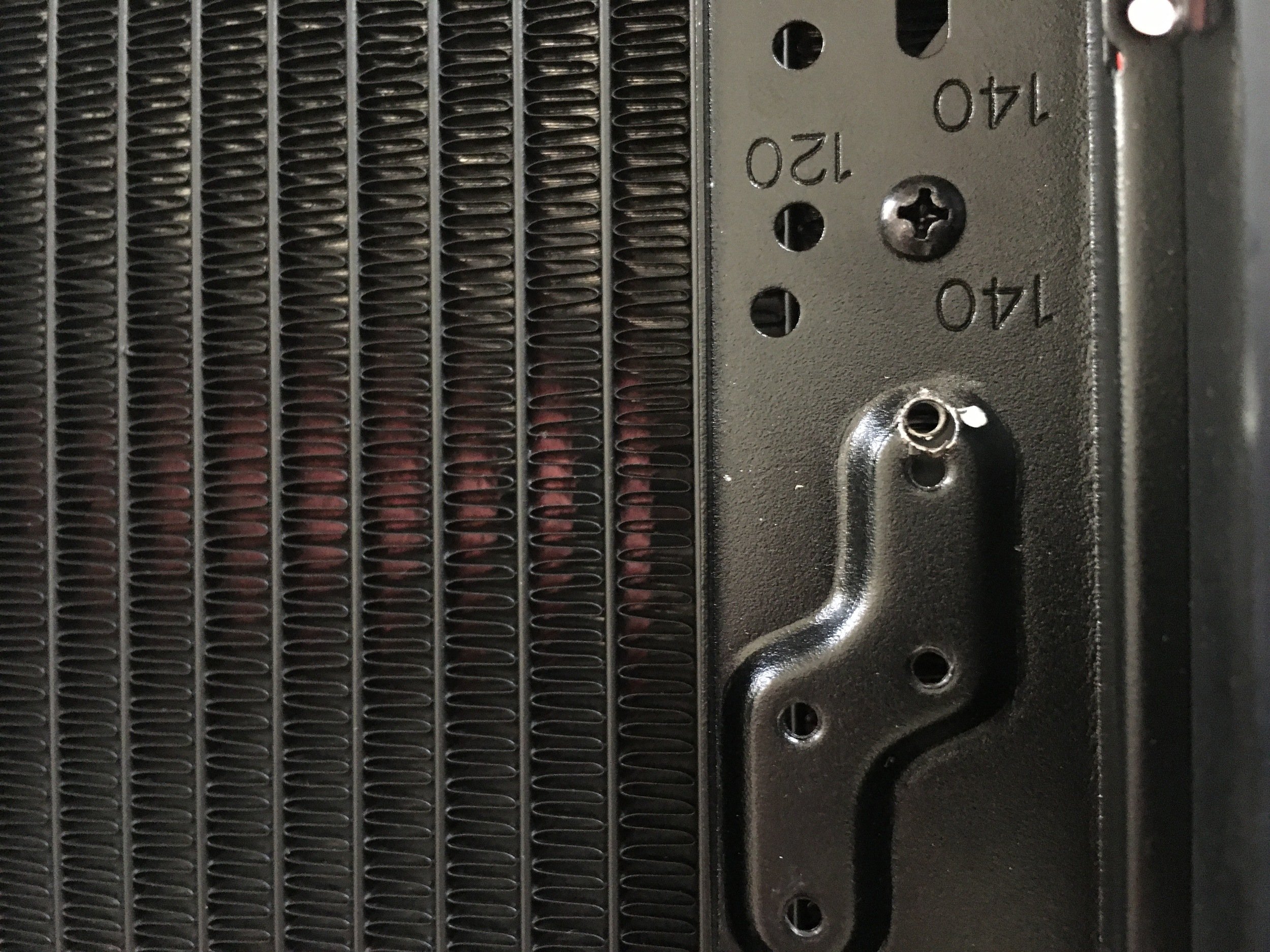

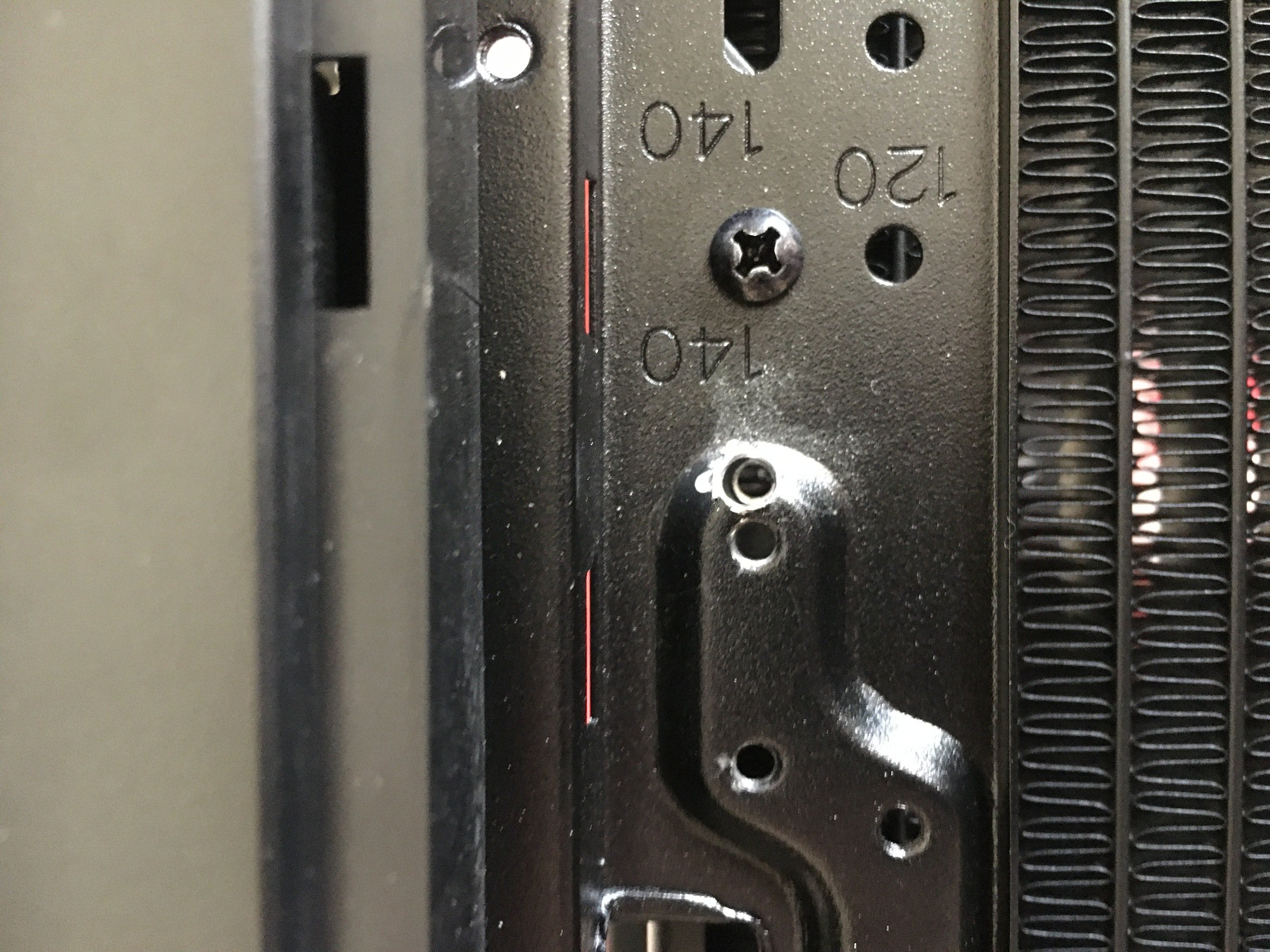

Some of them look off bc the radiator isn't quite perfectly aligned yet. But I basically nailed the location of all the holes I needed. Black washers will be going over the front and they'll probably cover any metal shine from the drilling.
Since you are customizing that case I can't stress this enough. BE CAREFUL screwing into the radiators. Too far and you can puncture the radiator. I mention this because by modifying things, distances can change... be careful mounting the radiators.
Everything is flat. I sanded/ground any metal that was poking out from drilling on the backside.
