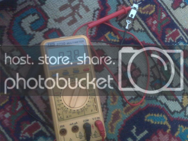

4.9 is still too high.
One thing I want you to try:
Touch your DMM leads together to see what your DMM resistance is. It SHOULD be in the .00-.10 range, otherwise you have some crappy leads.
x2. My DMM can be pretty far off sometimes, I must find the resistance of the DMM itself, then subtract that difference from what my coils are showing.
Not many companies have 6-ohm. But for SURE the type ARRRGHHH only has 2 and 4 ohm coils.
thats exactly what i thought....
but i have this nice *** dmm or atleast i thought it was..:
