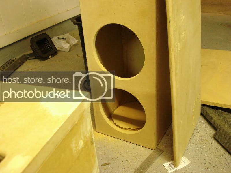

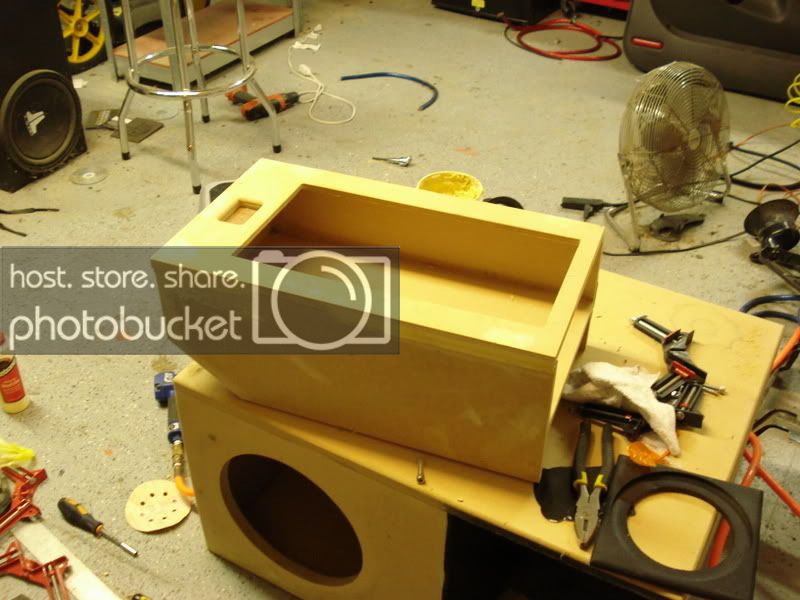

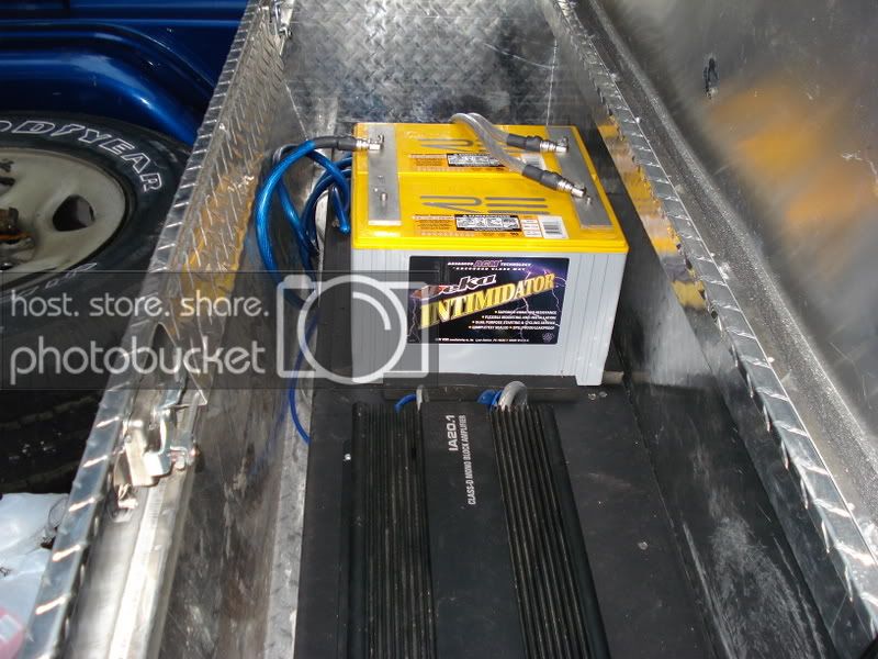

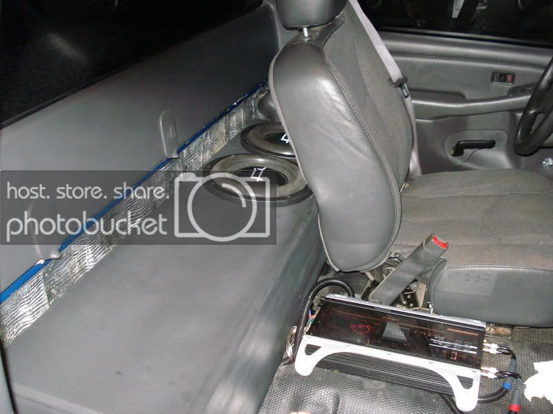

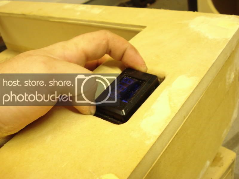

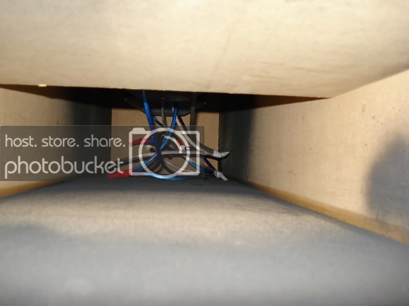

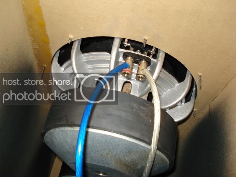

But anyway to describe the install, the BL's are in a 3.0cu ft. enclosure tuned to 36hz via a flared slot port, the 20.1 and batteries along with their respective distribution hardware, the JBL amp will be housed in a center console along with a stinger voltage meter and will be under Plexiglas that is illuminated with blue LED's.

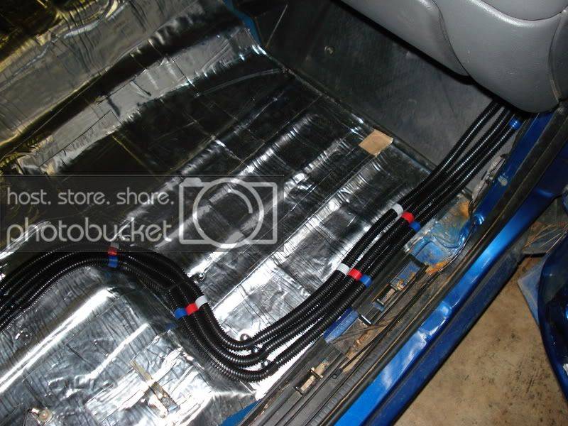

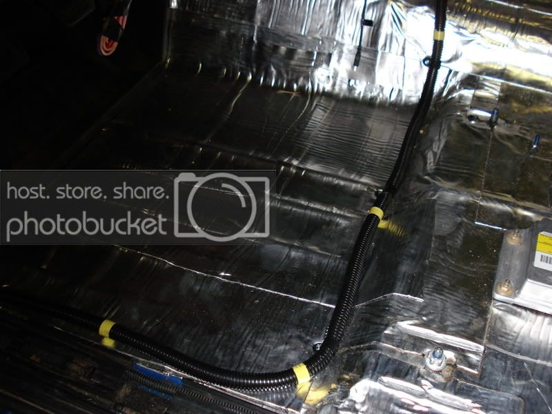

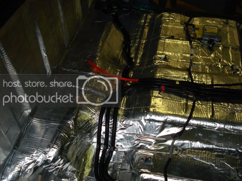

Again, I believe in doing things right the first time so as some of you may remember I loom and secure ALL wires.

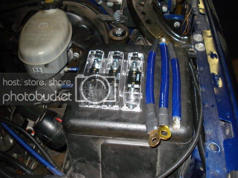

900amps of fusing

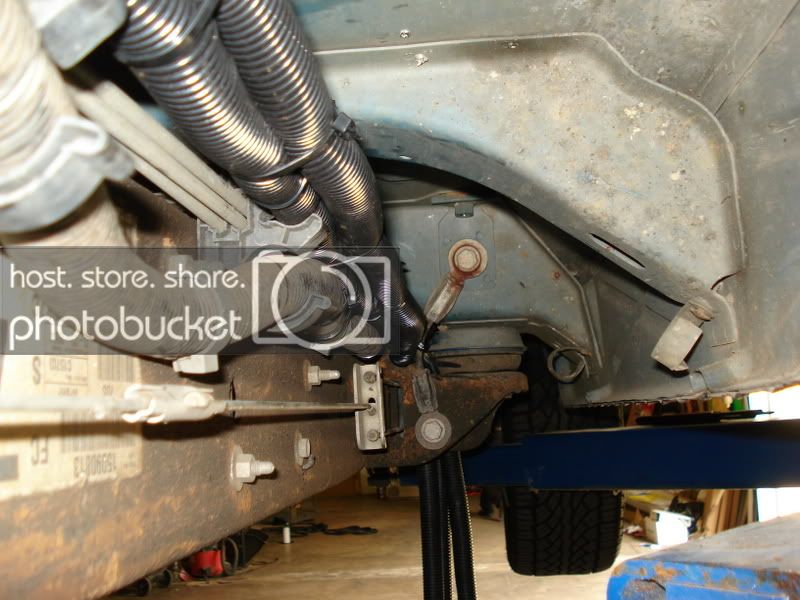

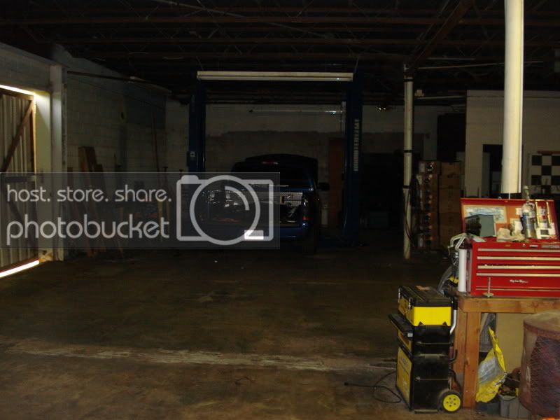

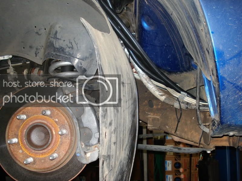

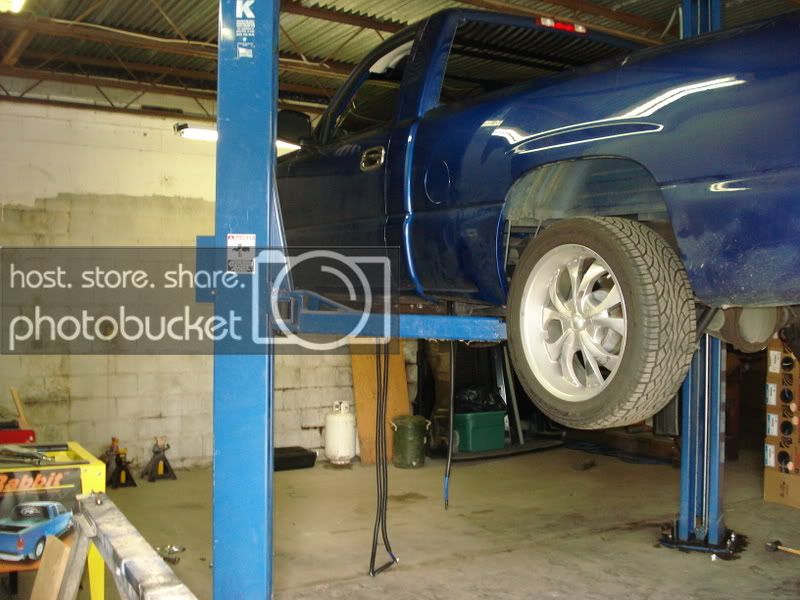

This is what I have to do to run 6 runs of 1/0 through my truck...thank god we have a lift at the shop

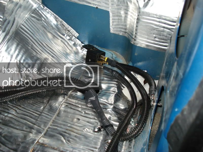

Relay for turning everything on
power wire for JBL amp (notice the color coding...that helps tons when troubleshooting
