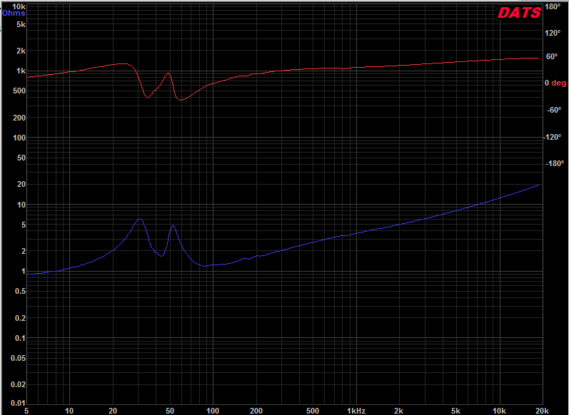

Rise is only important if you need a one note SPL box, in theory to get the most power through the coils as possible. Even then, I have doubts as to how important it is.
In the past it has definitely been worth knowing what impedance is at your burp frequency to plan coils and amps accordingly, these days possibly less important for most folks considering how cheap we can buy full bridge power. My first 150+ was running my old JBL/Crown A6000 into """1.4 ohm""" while in 4 ohm mode. I had determined that impedance at my peak was actually about 6 ohms with that sub/box/vehicle and that it was safe. For reference, I gained nearly 5dB over daily configuration running that same sub/box at 6 ohm nominal.
Also want to point out that IF you know sub and box specs you should be able to predict impedance at any given frequency since every variable can be converted into ohms, henrys or farrads, but for practical purposes, using a constant voltage source and measuring current and doing the math is probably best. Or to shortcut that, Dayton DATS will give you an impedance graph in a couple seconds.

Some googling can break down which variables are what.
Also output from Dayton DATS. This is the wall in my Jeep wired to .7 ohm nominal

147 to high 151s IIRC. Consider my impedance wired to 5.6 ohm nominal was probably 16-20 ohms. Even the big boy Crown amp doesn't make all that much power there but it does put out a lot at 4 ohm. Neodymium motors can give some big impedance numbers.

A friend of mine was competing rookie class about 8 years ago with a 500/1 and we got (slightly) better numbers running at .7 than at 3 ohm. Dyno shows the Taramps "smart" 3K made its best power at 2 ohm. The difference for music listening would be inaudible but with competition you really just have to test everything. He was absolutely killing it in the rookie class (up to 2000W limit no test tones no re-bass) doing 142's. He had a couple new children and sold me the sub back, now it's living in my F250, poor numbers in there but I don't haven't made enough space for a proper box.
