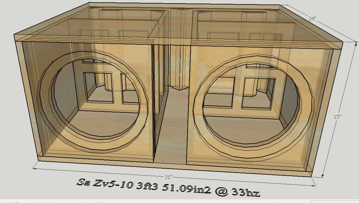

This went into a Camaro I heard, but it took premium materials (.6875" Russian 13ply) and some hedging with the measurements given. Thru the trunk opening no less and I heard it took some drama to get it in there.
I'd realize a pair of 10's can do work, cone is king yes but enclosure is everything.
