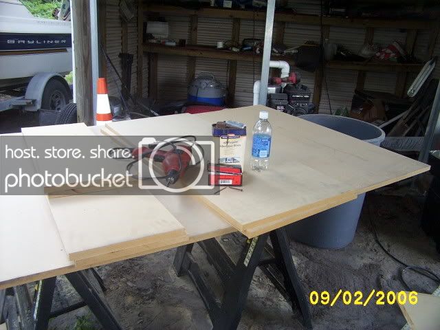

Speaker hole is cut, port is constructed, inside is resined, possibly installed.

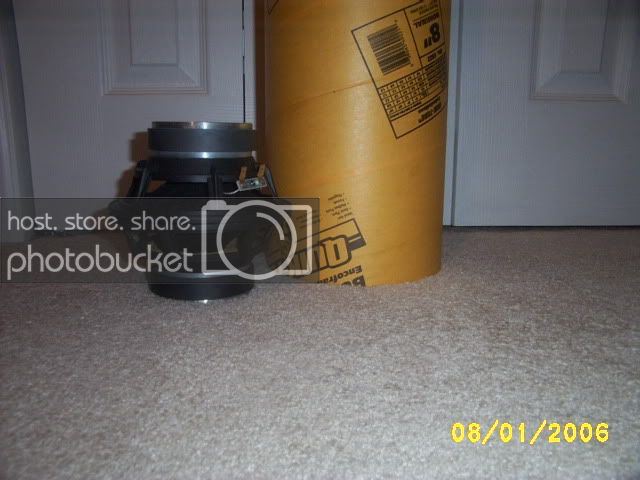

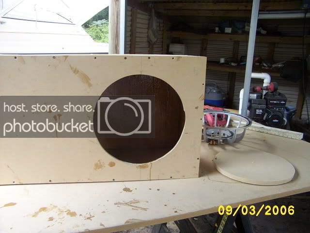

Thoes are Mach5's 6.5's. Good little drivers for the price. I put them next to it for a size comparison incase you cant read 8".

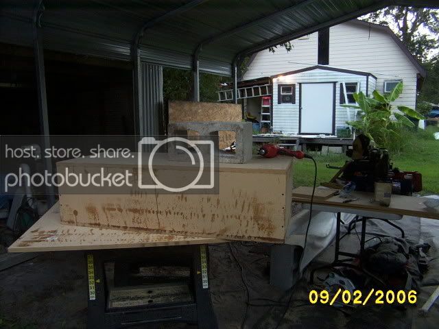

The 8" Cement tube is going to go on two 8" port ends with an 11" total outer flare radius. Almost an exact scale from a 6" aeroport.

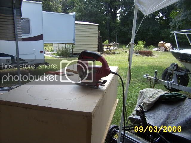

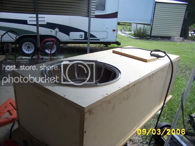

I cut all my holes with a jig saw. No fancy router & Jig.
And they fit just fine.

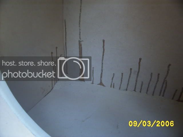

If you lit a match anywhere near this thing it would go off like the fourth or july. My eyes where stinging from the resin fumes 2 feet from the opening.

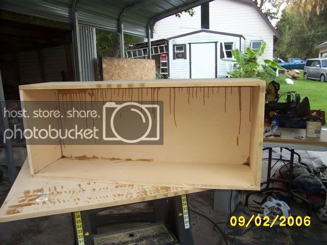

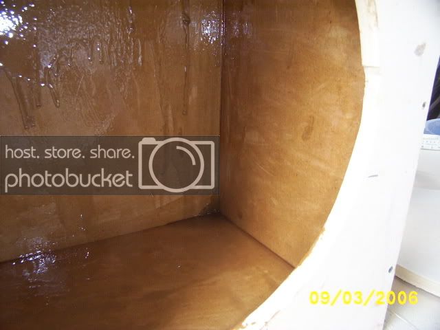

Just a tip when resining a box. Dont paint it. Mix it in a 20oz soda bottle reletively cold. Pour some out, use a pice of angle iron or 2x4 as a squeegee (sp) and putsh a semi even coat around on each wall then just let it set. Gravity will do the rest.
