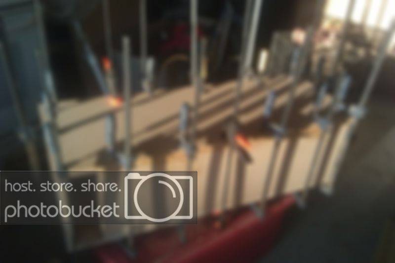

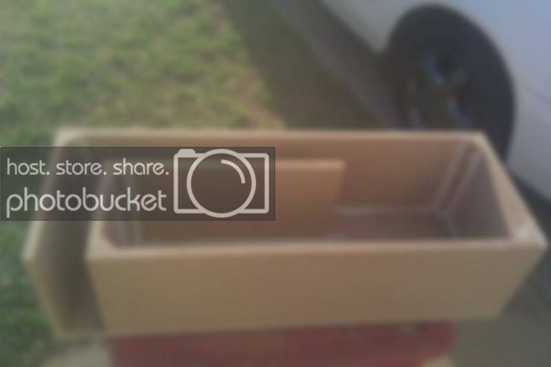

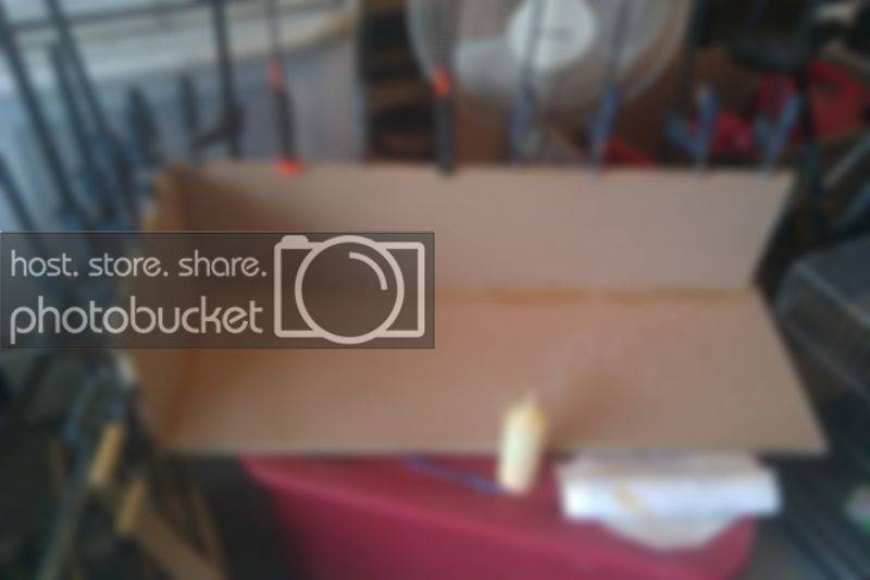

Well im doing this build for a buddy of mine. I'm doing 3 sundown e8's running off a audiopipe AP10001D(gains turned down and set). Box is 40" w 12" h 14"d 3.25" port 2.2 cubes tuned to 32hz. Should sound pretty nice. Just finishing up the box now here's some pics.

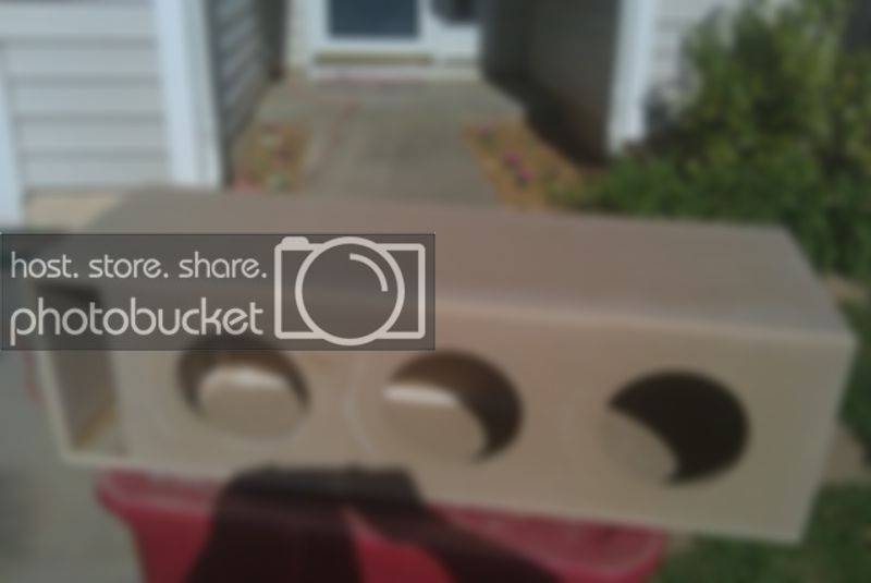

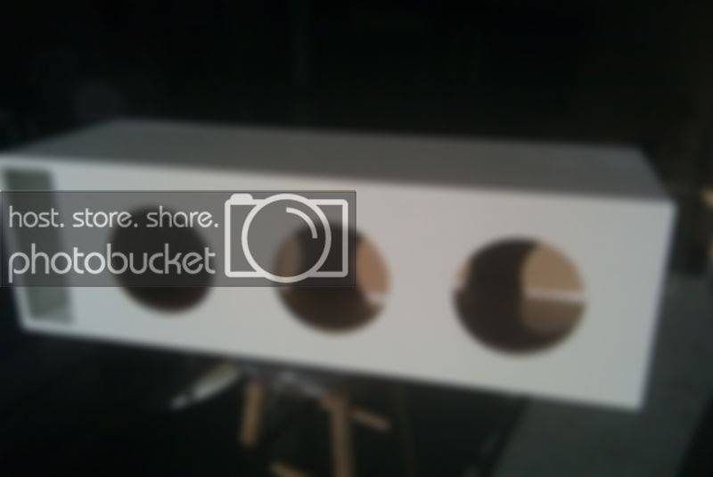

Well got the edges rounded today and sanded smooth. Going into primer later tonight. Color is going to be dark coal mine charcoal semi gloss. I may texture it havent decided yet. Im pretty much doing what i want with this build since i got the ok lol.
Well I doubt he'l be interested in doing that. He just wanted a nice clean sounding set up that hits pretty well.

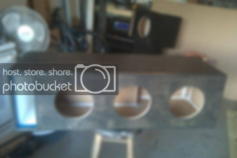

1st coat of paint is on man i need to buy a sprayer
Ill be doing nut and bolt style in the back will drill those out later wont mess up the paint as thats how i always do it.

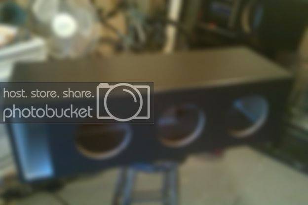

Box is done paint just needs to dry im pretty happy with it
