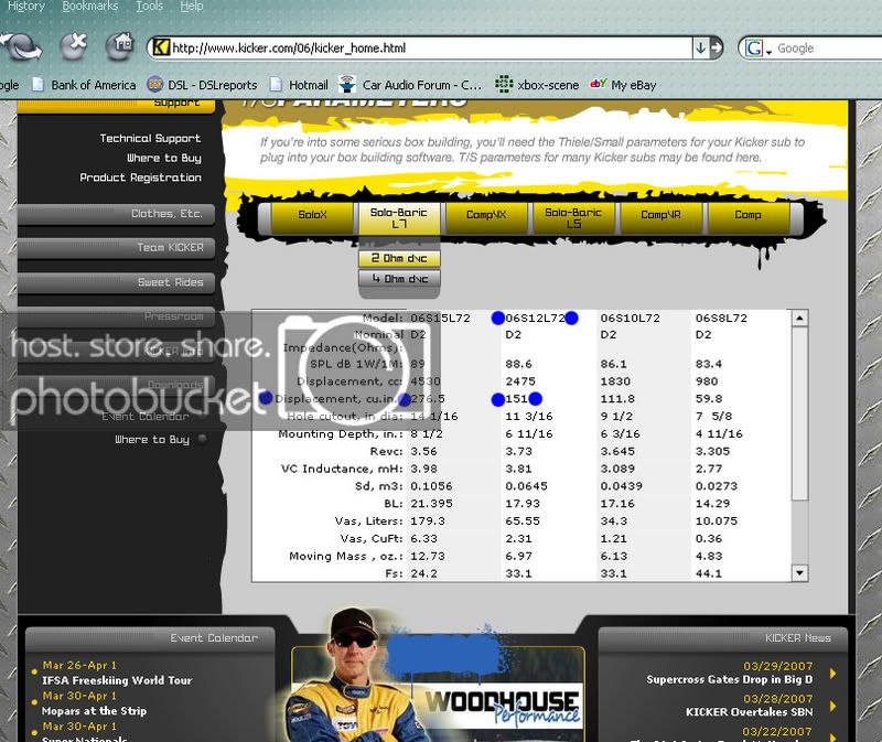

Where is this on Kicker's site? It sure isn't in the manual nor is it on the specs section for the L7. It's good info to know but it sure as hell isn't in the logical placement on the site. It won't change anything with my design though and actually allows for some bracing to have it fall right back into an exact 2.5 cubic feet.
Got to Kicker site then click support>technical support>t/s parameters>
